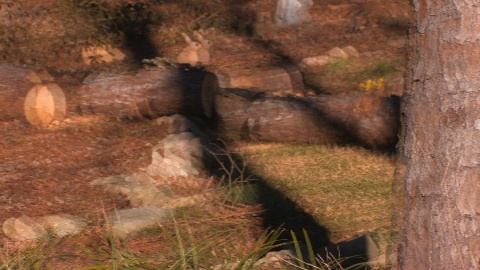

I clearly see two frames in the rendered work (rendering to HD 1080-24P wmv) and the work is extremely jittery with any movement (not whip pans). I've attached a frame showing this effect (by putting the rendered wmv clip back into the timeline).
Vegas Pro 8   24F/24P Question-example-interlaced-24p-wmv.jpg

You've not told us yet how the Canon delivers your footage. Remember, IF the Canon handles 24p the way the Sony does, your footage is 60i and you don't want to treat the footage as 24p unless you've used Cineform first to convert your footage. Until then your project properties should NOT be set to 24p, don't render it as 24p, do not try to remove pulldown, etc with Vegas. Treat it as 60i.
If your Canon does actually deliver footage with the pulldown removed (I do not know that it does) then you can treat it as 24p. Other than that caveat, I have no idea what is wrong.
