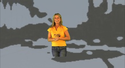

Here's my question, I'm testing chromakeying for an upcoming project, here's the situation (look at the pictures) :
I'm filming a person in front of a greenscreen not wide enough (see picture CK-1)

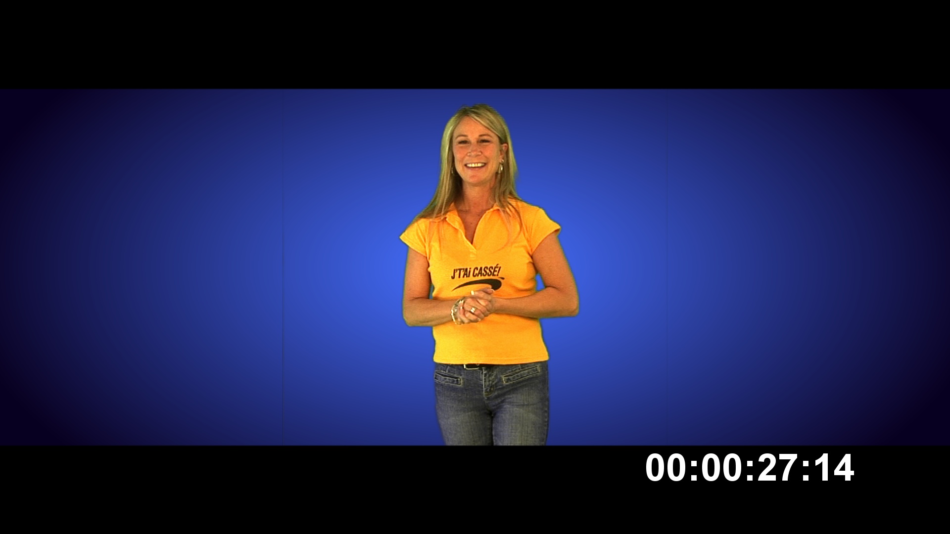

I thought of going into the EVENT/ PAN CROP and reducing the width but this is what happened (see picture CK-2) notice the vertical lines on each side of the person

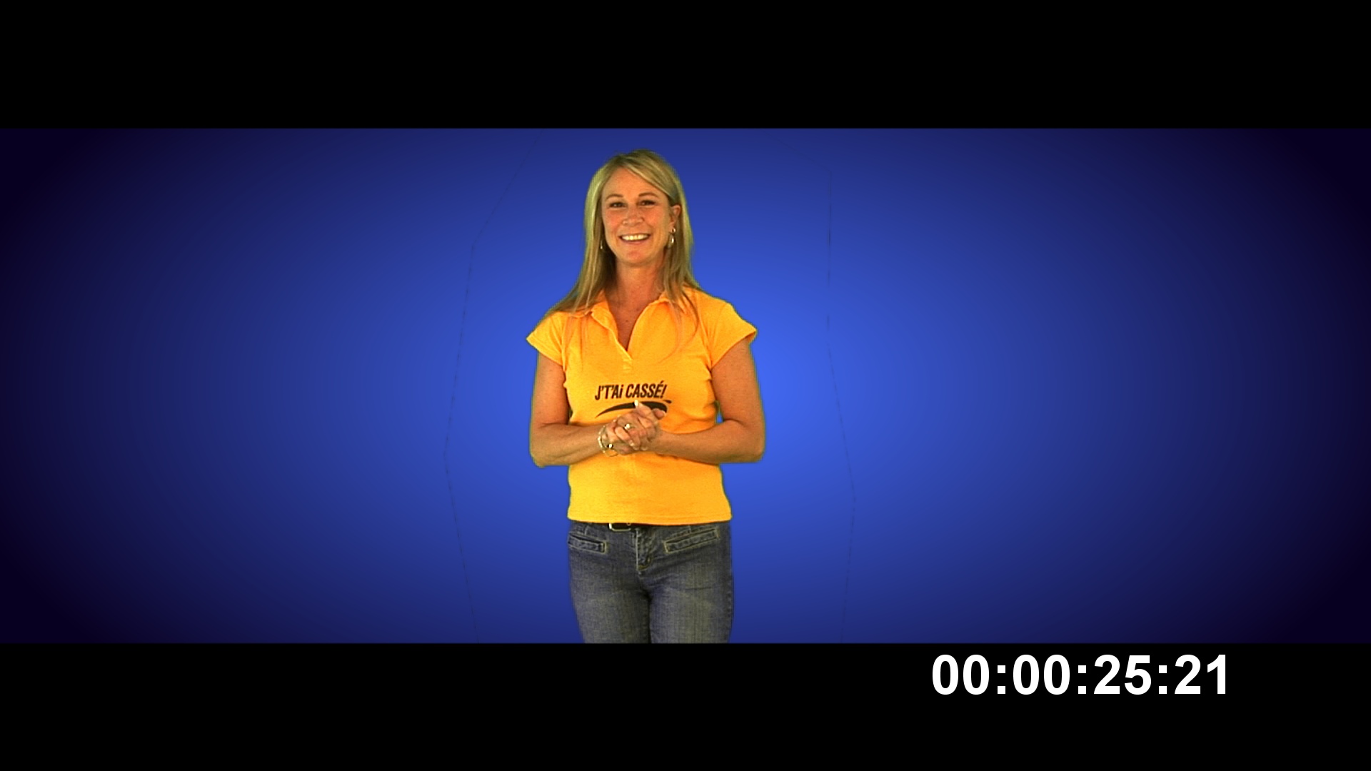

Then I thought of going into the EVENT/ PAN CROP and using the MASK option, but the same thing happened so I used the FEATHER TYPE option, set it to BOTH at 10% and this is what happened (see picture CK-3)

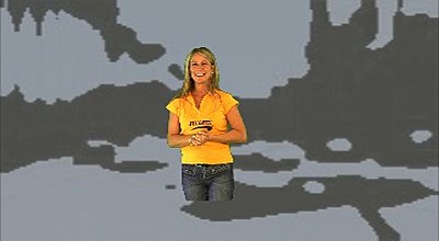

Here's what I got:

1. Used Pan/Crop masking to create a mask around the girl with NO feathering. This let me see the background image outside of that area.
2. Used ChromaKey on the green area close to the girl. Had to adjust the high and low settings to get things to look right.

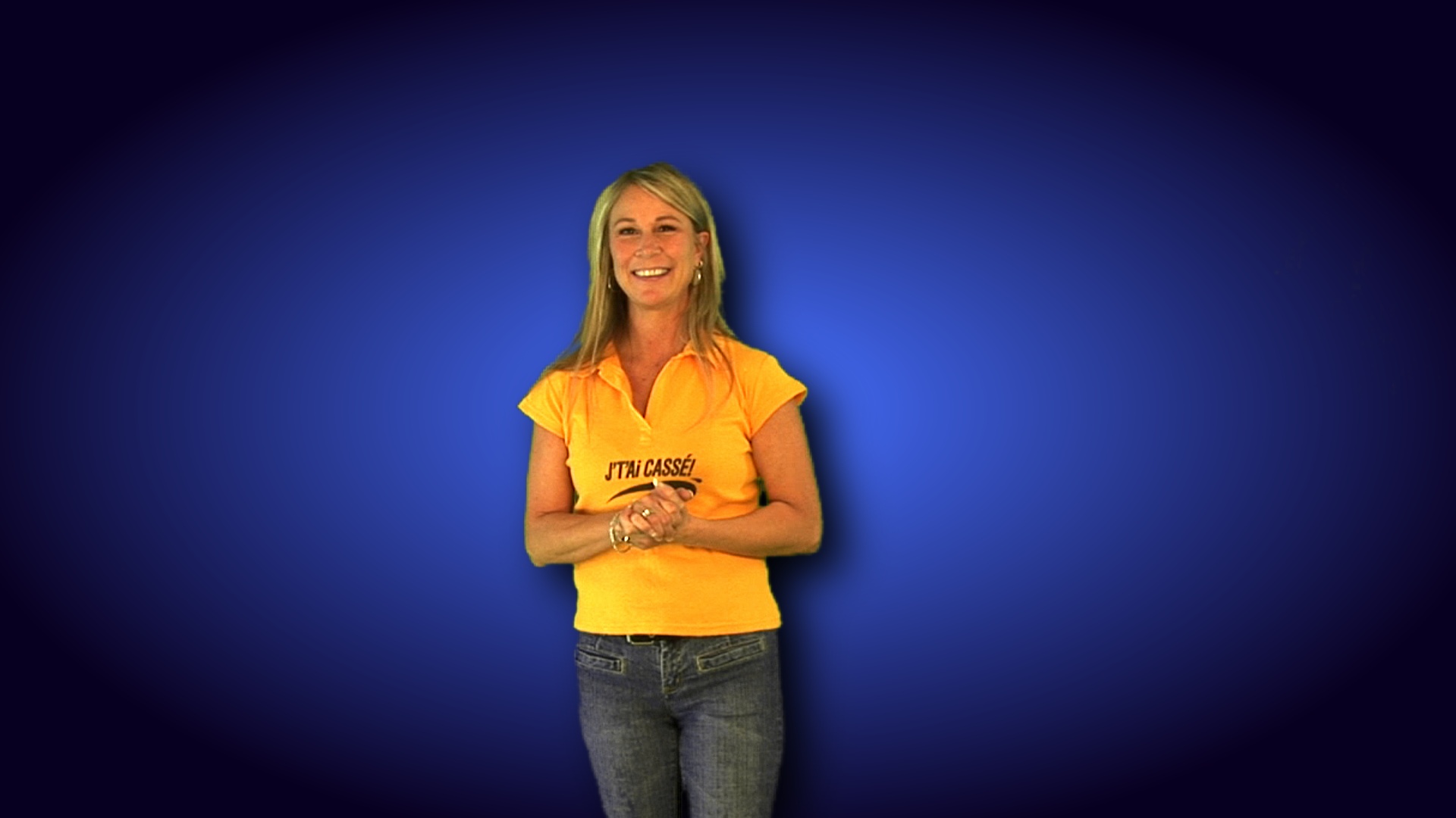

Edward If you read my first post that's exactly what I did, I used the feather option because It came out like this (see CK-4.jpg)
I think it's not a chromakey problem, I don't have any trouble adjusting highs and lows to get the look right.
I think it's a masking issue, If i remember right I already had this trouble masking on another project.

Donald, it appears you've got a track motion shadow enabled, for starters? Or did you do that to better illustrate the key?
First, use the key to set your green. Then use the mask to cut her out. Be sure you don't have shadow on. Use the feathering both in/out.
We have a key that is too short for anyone much taller than 6', and have to often cut this, and have been using masking combined with keys since Vegas 5. I assure you, it works. But...you'll need to set the key first. Go ahead and key with the ugly sides. Then cut it out.

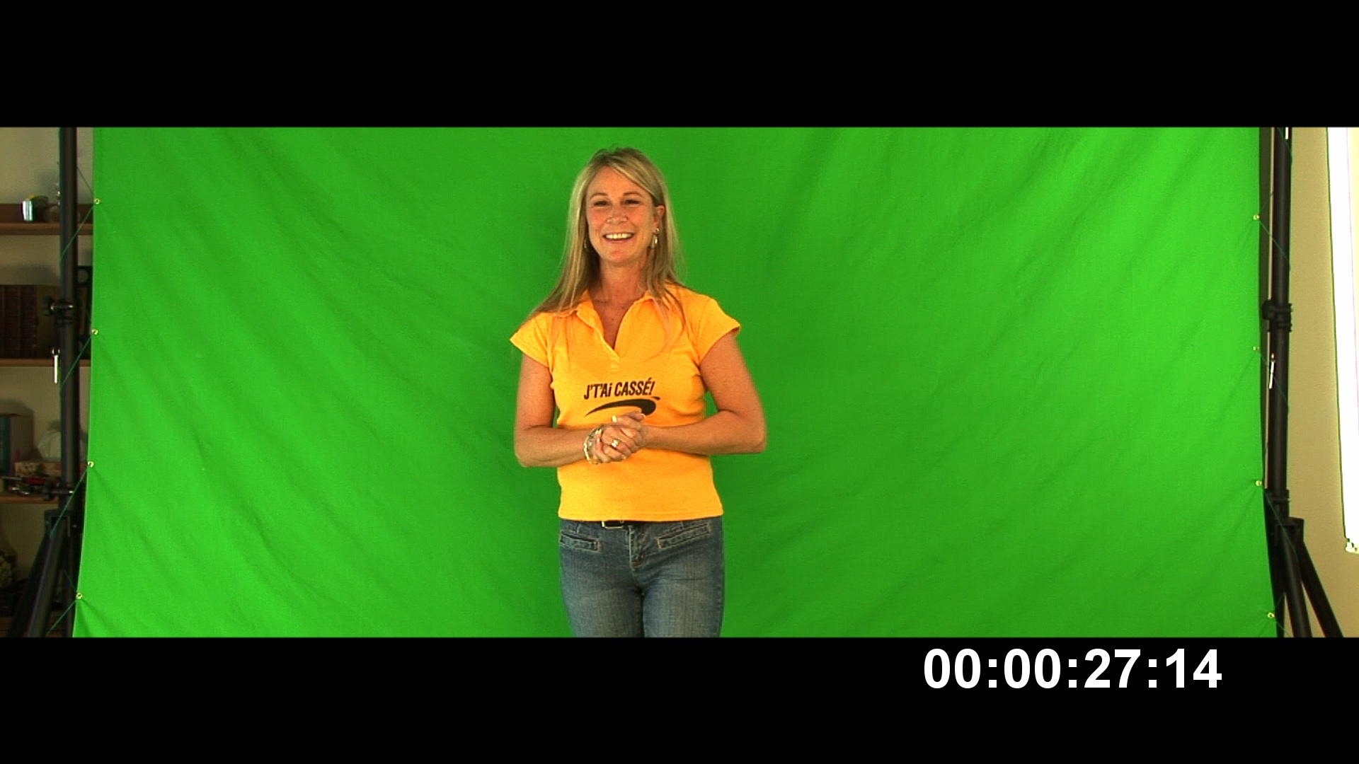

Like I said before jason, now I don't think it's a chromakeying issue, I already fixed the original problem (see CK_5) just by zooming in on the subjet and not having the need to mask because of the not wide enough greenscreen. But I still want to know why it happened.
I Had this problem before and there was no chromakey involved, just plain masking, An irregular line seems to apear around the mask (as you can see on CK-4 in my earlier post) the line is irregular.
I remember the last time this happened to me, I had filmed a field of white snow, and I wanted to mask out a dark rock in the middle of the field, so I masked it out, duplicated my track and chose the white snow on the side as background and the same thing happened, an irregular line appeared around my mask.
