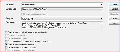

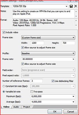

Try settings below. it is 1280 x 720, but if you like it you could try customizing to 1920 x1080. This may get you there

That's weird...I don't even have that template. There is only two templates for that file format. 320x240 and 640x480. No HD templates...
i dont have it either....whats up with that?

Although the O.P. asked how to make his file small but still good quality, "What codec gives the best picture quality for a given bitrate?" is the underlying question here.
Chris says "Main Concept MP4" is the answer, which is, I think, correct but incomplete.
MP4 = MPEG-4 = AVC = h.264. These are all terms for the same compression codec, slightly different flavors. And yes, Chris is right, this gives the best quality for the bitrate, at least today. These things tend to change.
The point of my post is that the Mainconcept AVC/MP4 is not the only way to get this compression out of Vegas. You can also use the QT MPEG-4/h.264, or the Sony AVC/MP4.
MP4 is the most highly compressed video in general use today, so it requires more resources to encode, and more to decode. Not a problem - the O.P. says there's plenty of horsepower on the playback machines.
However, there are some choices as to the player, usually this will be QT (ugh, performance isn't great on the PC), or some Flash Video Player (can be great performance, but requires some thought to select one).
For ease of use on the PC and really pretty good quality for bitrate, WMV9 is a great choice. You might see how it works for you.
You're going to need to get comfortable with creating your own custom templates to work with 1920x1080 output.
Old August 27th, 2009, 10:18 AM   #8
Join Date: Nov 2007
Location: an Alaskan living in Des Moines, Iowa
Posts: 513
ohhh, that was a custom template, that makes sense.
