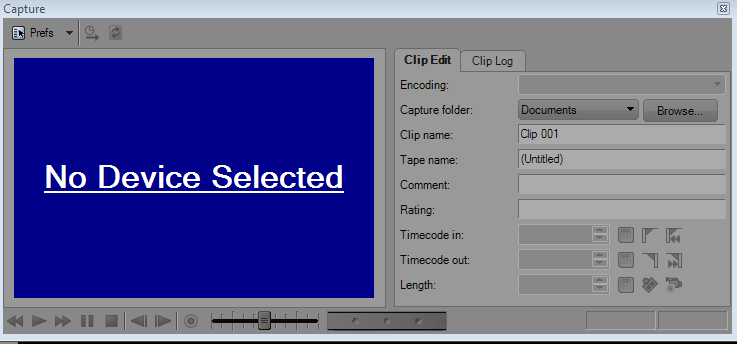

They are on the C drive for sure, possibly in your Window User folders somewhere.
Look at the Capture folder tab, what you need to know should be there.
