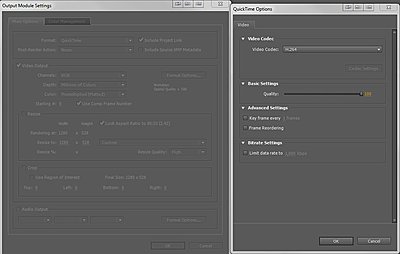

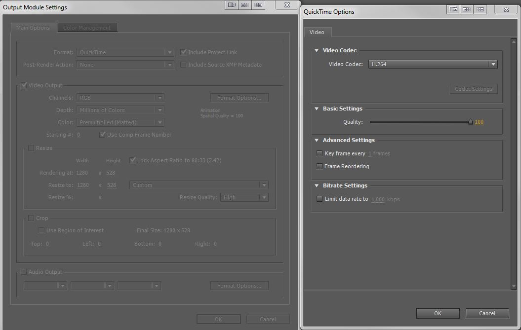

Sorry but you dont need Quicktime Pro to render to H.264, see pic from After Effects.
You could render using anything to MP4 and just change the extension to .mov
If you want to use Vegas to do it you just choose the MP4 codec in the Quicktime drop down.
The quality of the codec from Vegas and Quicktime Pro is very ordinary compared to other options
