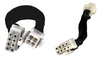

Steve Kalle December 21st, 2009 03:12 PM
From 1st PC Corp.
Model Number: CB-4M-8F
"This 12" long cable adapter converts a molex 4-pin from a regular ATX power supply to either a P4 ATX 4-pin or a EPS 8-pin female by combining the dual P4 ATX 4-pin. This dual use cable adapter is black sleeved as well."
http://www.1stpccorp.com/Images/CB_u.../CB-4M-44F.png
Model Number: CB-4MP4-8F
"This black-sleeved power cable adapter converts a P4 ATX 4-pin female to a 8-pin EPS female connector. Cable length is 6 inches"
http://www.1stpccorp.com/Images/CB_u...CB-4MP4-8F.jpg
Model Number: CB-6M-44F
"This Dual-Use cable adapter converts a PCI-Express 6-pin to a EPS 8-pin, or a P4 ATX 4-pin, which is then plugged on to a motherboard. At 12-inch long and black sleeved, this cable adapter is very functional and looks sleek."
http://www.1stpccorp.com/Images/CB_u...-44F%20web.png
The power issue goes over my head also, so, I suggest calling a reputable system builder who deals with dual-CPU systems on a regular basis and see what they say.
John Hewat December 21st, 2009 06:18 PM
2 Attachment(s)
The disks:
Ok, after hours of Googling and trying to solve the problem of the portable SATA drives not disappearing from Windows Explorer even after they had been disconnected and powered down, I found and downloaded a program called HotSwap from here which allows me to deactivate the drive before unplugging it. This was imperative as I had a drive get corrupted by removing it, thinking that no data was going to/from it. Luckily it was a backup, because there was 270GB worth of footage on it!
Now I can be sure.
The power:
As far as I can tell (and I'm not too switched on when it comes to this stuff, all of the power connectors come straight from within the power supply and go straight to the motherboard with no adapters.
Also, looking at the motherboard manual, it looks like all that is required is one 8 pin (plus the other stuff). Am I right?
Steve Kalle December 22nd, 2009 11:02 PM
You are totally fine and I think this confirms the use of Molex adapters. I looked at pictures on newegg to confirm, and there is the 8 pin above the top cpu and there is the 4 pin + Molex you pointed out. Because Supermicro builds a server class board like this, then its certainly ok for boards without the molex connector.
