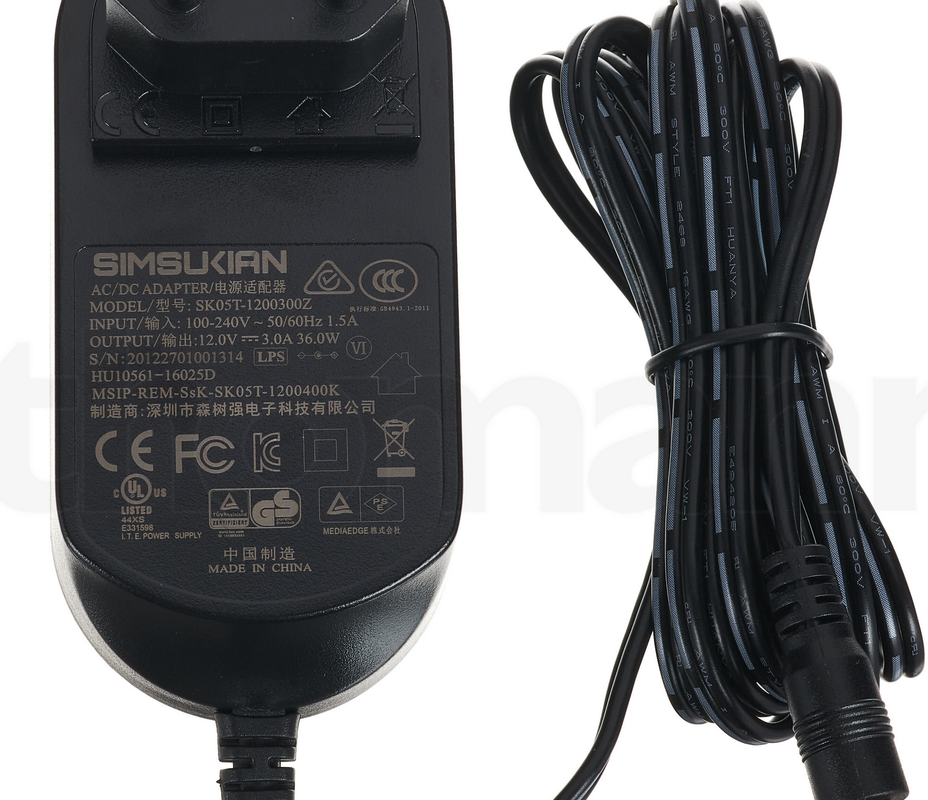

Ataka Nikolov August 5th, 2024 12:52 PM
Re: How can I turn on the Atomos Ninja without a battery ?
Hello again and a big thank you to everyone that is helping me on the topic. Atomos doesn't state any info on their basic ac to dp adapter on the page(just a photo with no info) and that thing can cost up to 70 euros .. Found a closeup image of the adapter for the old Ninja V .
https://i.postimg.cc/3NxfPKbY/Screen...er-Adaptor.png
I highly suspect its the same thing for the new atomos 2023 model as it looks like the same device but with x265 and the new OS . Same price but less physical content in the package .
The usb c charger that I was looking at:
https://eu.baseus.com/products/cube-...st-charger-65w
Has these specks :
https://m.media-amazon.com/images/I/81eJsT6pdPL.jpg
Looking at it , it has many outputs and I suppose it auto detects?? what the plugged in device wants .
It also does have 12v - - 3.0A 36W which is also written on the difficult to find and overpriced atomos page, adapter . Logic dictates it should work . It appears atomos is using a battery eliminator to power the thing because it just doesnt have a normal power plug like the Black Magic Design video asist .
Will take a look if a dell ac to dp power adapter even exist. All I see are AC to usb c .(which means you have to connect to each other 2 usb c cables .)
