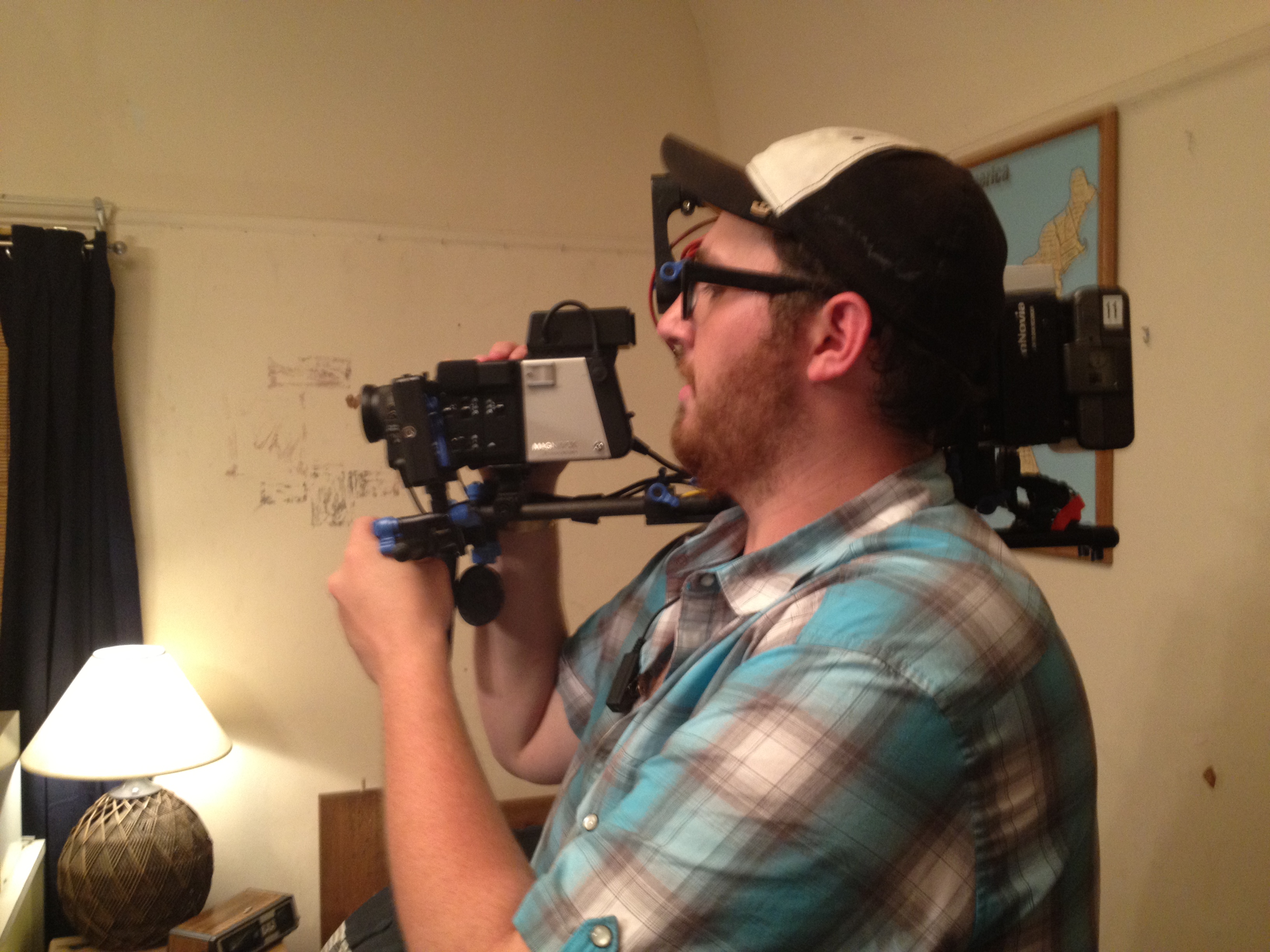

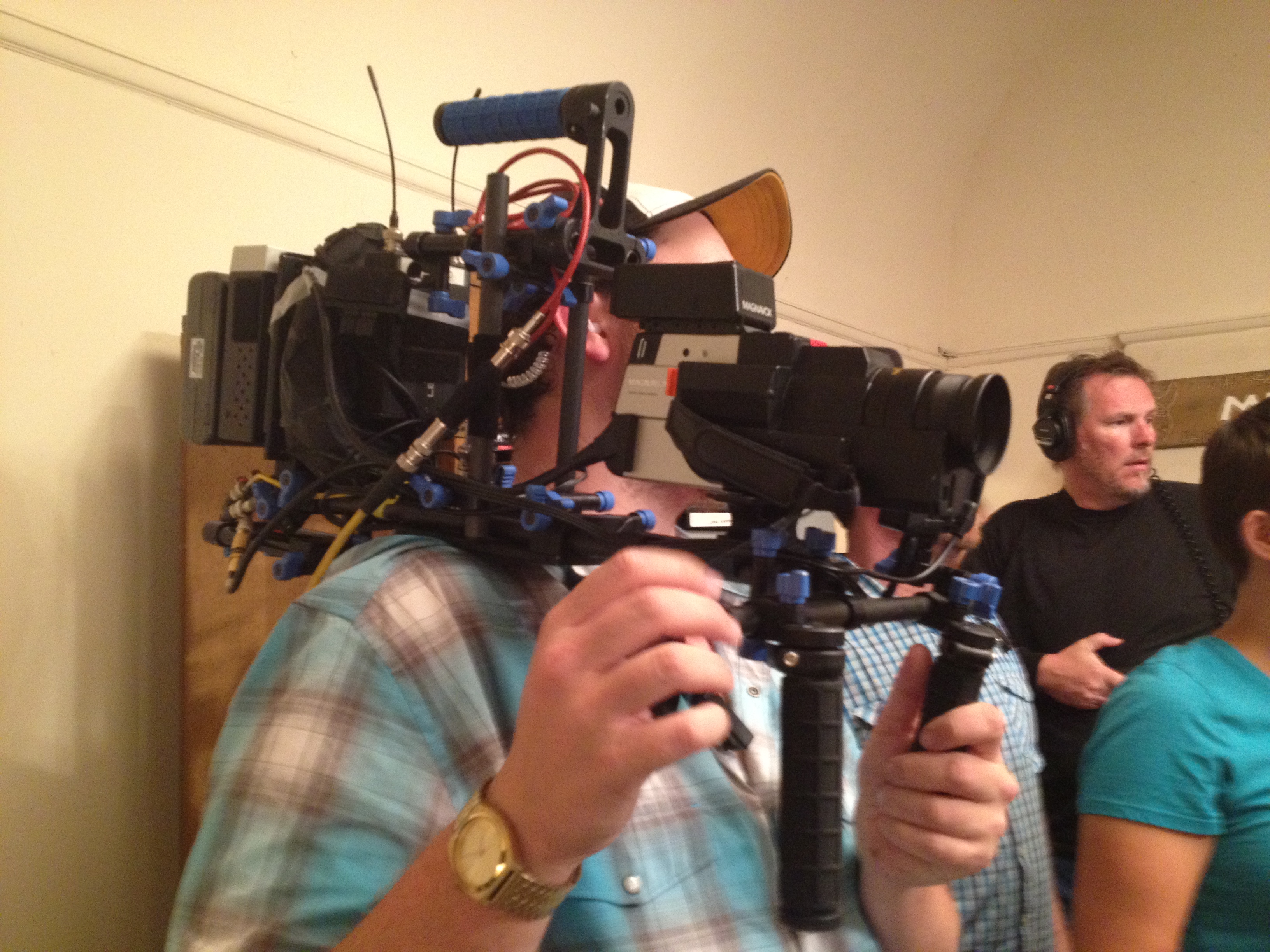

We shot "Obama--The College Years" on Friday! Attached, our director Peter Atencio mans the camera. This is the first sketch on Key & Peele he has operated personally; he wanted a total home-video look where the camera becomes a character of the person operating it. The producers were all enthralled with the way the camera "performed"--it looked eerily period, like found footage (the sketch is set in 1980).
A few extra bits got added to the camera, like a wireless receiver for audio reference, and we reconfigured any loose cables and connectors to make it "bulletproof" for the director. We recorded to the onboard Nnovia DV recorder and also on a DVCAM deck at the monitors for insurance. There were all sorts of strange artifacts in the image but I eventually realized that they would likely have been hidden on the 240 line VHS recorder this was built to accompany, rather than the 480 line DV standard we were recording to. Yes folks, we used to capture at less than 1/4 the resolution of 1080! Ah the good old days.

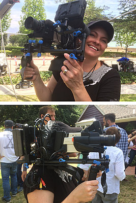

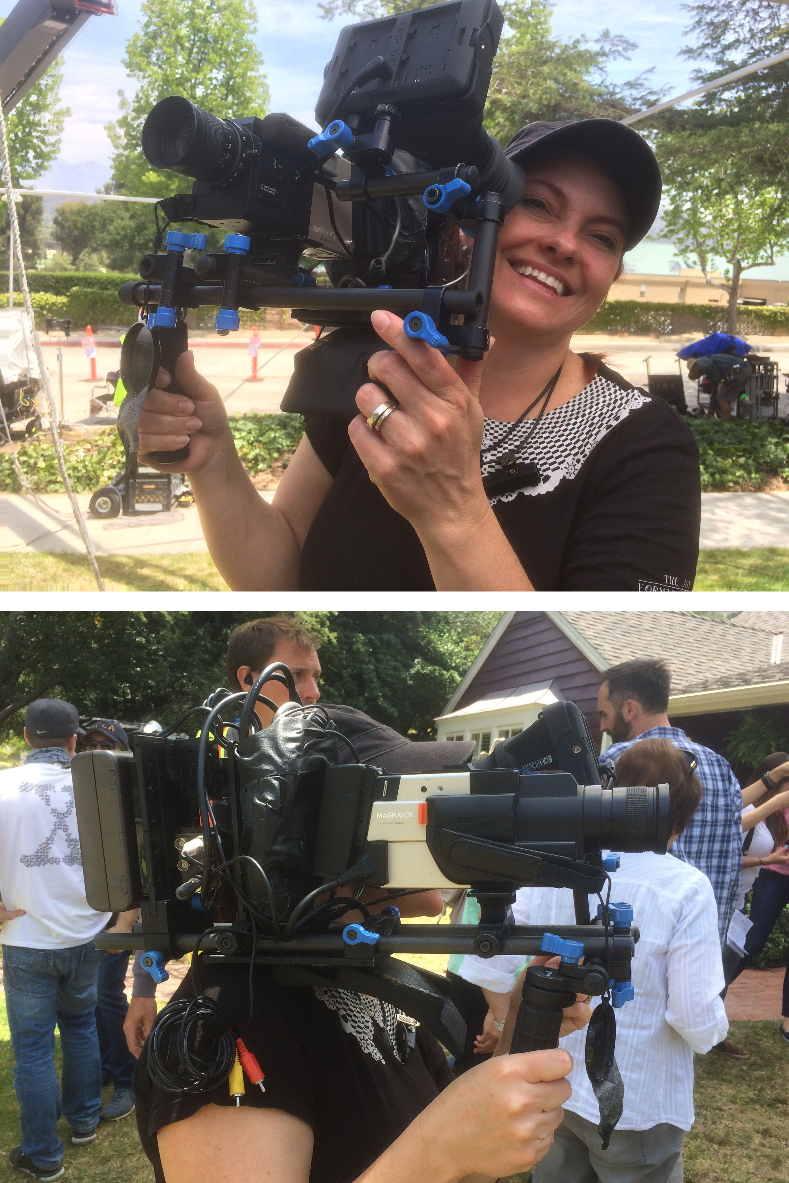

The legendary Lorinda-cam flies again, this time on the series "Playing House" which I'm currently shooting for USA Networks. This time it was recreating home movie footage from 1991 which the characters are watching on their TV. We shot it side by side with the Alexa in case someone didn't like the look of the old camera, but judging from the reactions on set, it's gonna be the Magnavox because it looks so authentic.
Attached, one of my operators with the rig (SmallHD DP4, mini-DA, adaptor cables and Anton Bauer brick powering camera and monitor. Recording was done outboard on a KiPro, upscaled to ProRes422HQ.

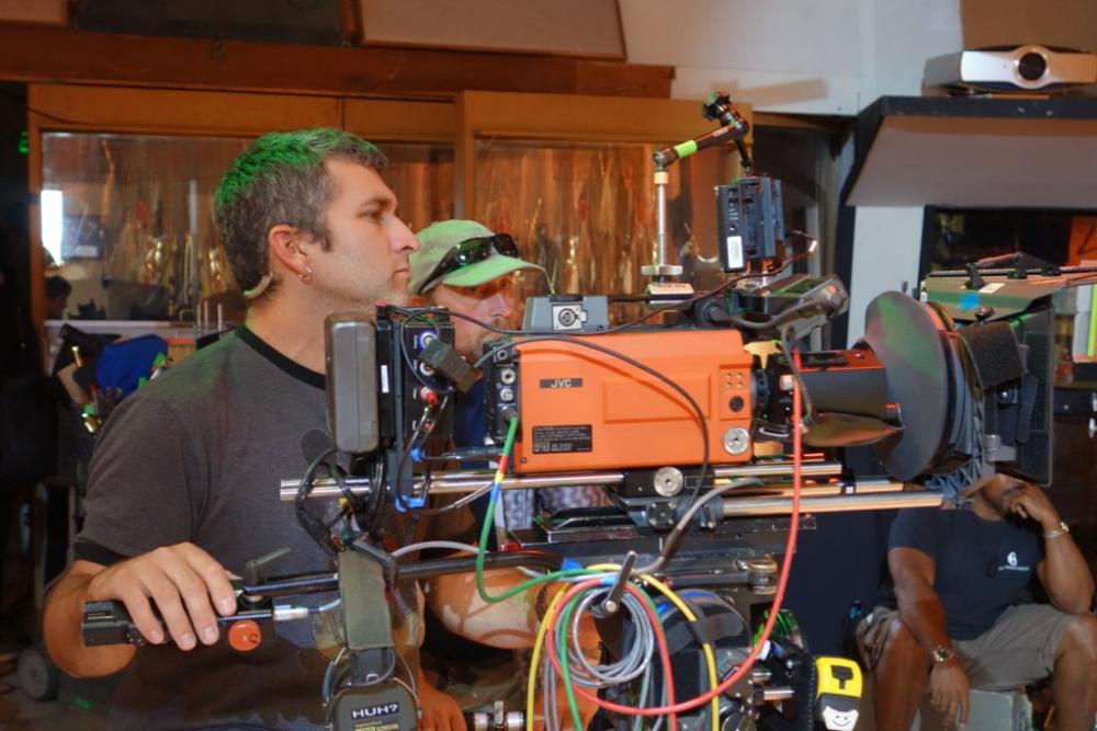

Mervyn, as well as Lorinda's camera I have in my possession two KY1900's that I use for recreations of period broadcast stuff. It turns out that while those were the cheapo cameras of the day, the Saticon tubes have aged better than the Plumbicons (good luck finding a functional Ike HL79 now)! As far as blinding people goes, I hear you on that--they are terrible un-sensitive by today's standards and I have to pour tons of light onto the set whenever I use them.
As seen below, one of the 1900's rigged out in all directions to shoot this sketch:

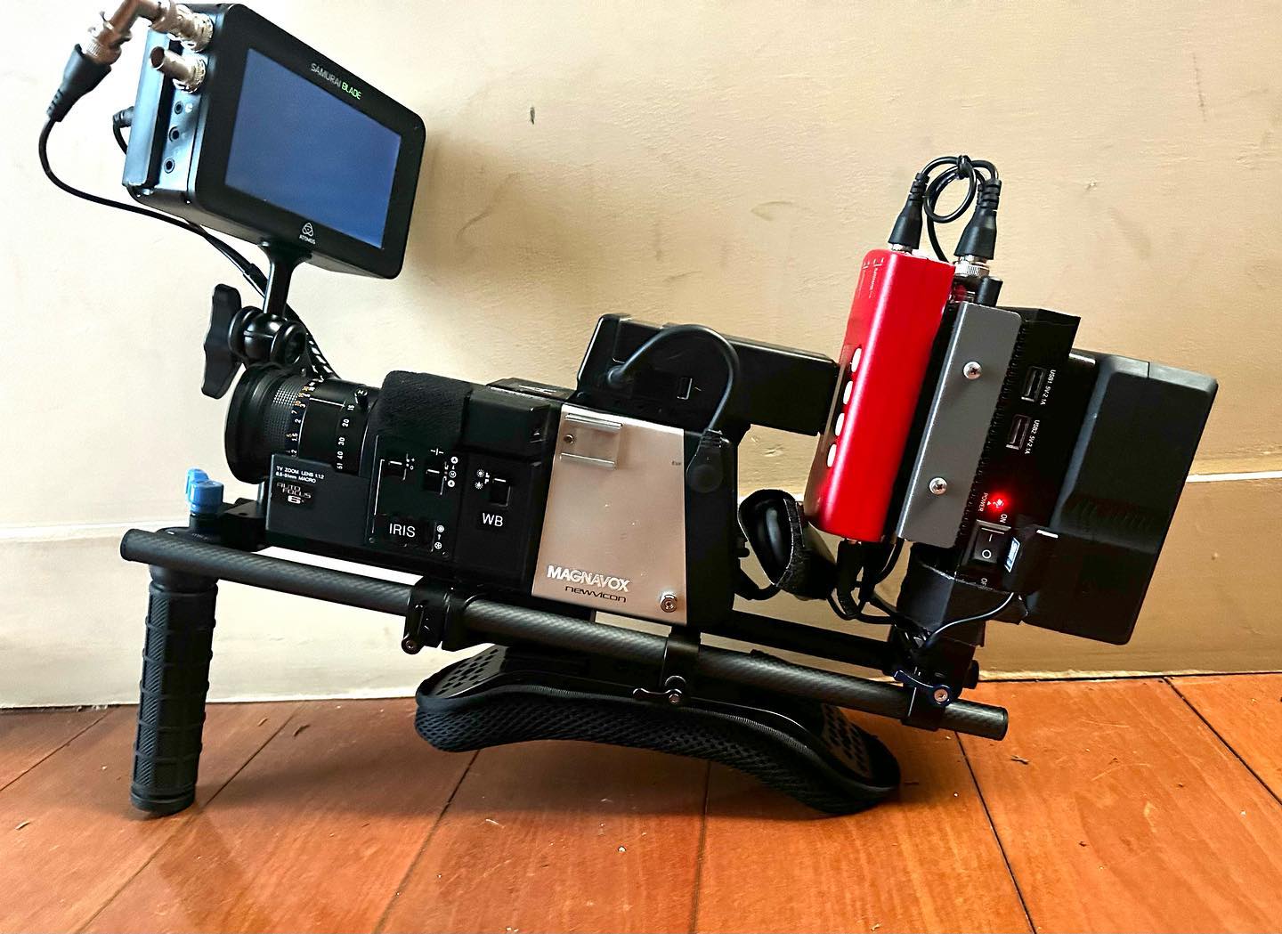

Searching for more of these cameras, this thread popped up (had forgotten about it). These little Magnavoxes are still great, 15 years(!) after this thread was started. I now have a few of them outfitted to rent out and record onto Atomos recorders. One of them is on a junket for the upcoming Transformers movie today, figured I'd post the latest configuration!
