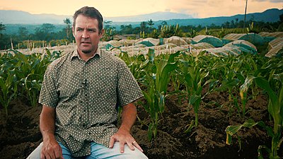

I think the image itself looks fine, and you could grade it to look however you'd like. It's hard for the image to have an "opinion" sometimes when everything gets a little too flat and gray. I'm not sure how Apple Color works, but here's a still I graded in FCPX using a LUT, some more warmth, and a few brightness and contrast adjustments.
Not saying this is how it should look, but I always think it's kinda fun to grade other people's shots. Maybe I should be a colorist...

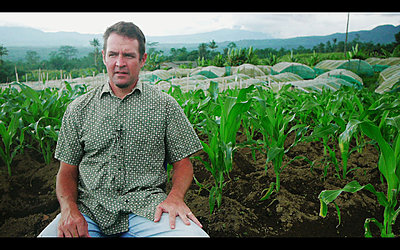

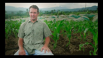

Like Nate always curious to have a grading tweak. A couple of goes here. Just tried to keep as much detail in the sky, brighten and skin tone adjust the subject and keep in basically in the 1v PP video range.
The second shot uses a bit of selective gentle defocus to the edges to help focus the viewer's attention to the subject

Thanks Christopher. How did you do the defocusing? I like that look

Can be done with a number of plugins such as Red Giant or just with a light gaussian blur mask. Which I would assume FCPX has.
