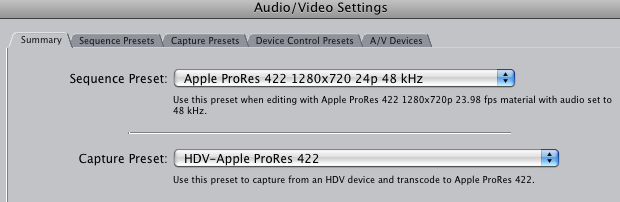

Tim Dashwood July 23rd, 2009 11:37 PM
Originally Posted by Stephen J. Williams (Post 1175524)
taking a second look at it. Under the audio video setting I only have the prores422 option under sequence render. I dont have it as an option under my capture window.
Not easy setup. It's in Capture Preset within Audio/Video prefs.

Tim Dashwood July 26th, 2009 10:08 PM
1 Attachment(s)
Originally Posted by Stephen J. Williams (Post 1176919)
The guy at B&H sold me Panasonic's with the camera....
Oh. The Panasonic MQ tapes are notorious for dropouts with HDV. They are perfectly good for the DVX100 but not the JVC cameras. B&H should have recommended this tape stock. JVC MDV63PROHD It is designed for the JVC ProHD cameras and will minimize (but not necessarily eliminate) dropouts. You should also get a head cleaner, run it a couple of times before switching and then stick with the one type of tape for the life of the camera.
My sequence setting is pro res 422
I dont have ProRes422 as an option for capture setting. Just HDV and some other stuff...
It might be my version of Final Cut. 6.0
It should be there with FCP6.0 and newer.
Attachment 13293
If not run Software Update.
