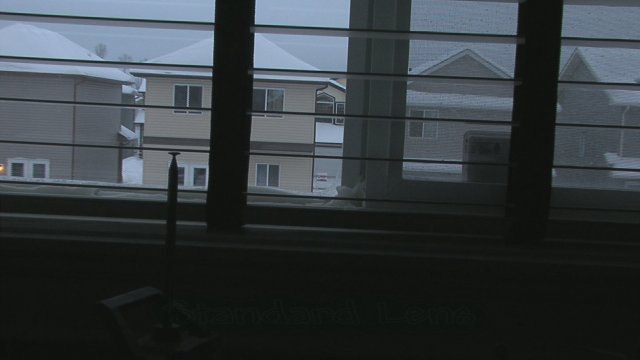

Attachment 20781
JVC stock lens zoomed all the way out (the sign is in the middle of the frame).
Attachment 20782
JVC stock lens zoomed all the way in.

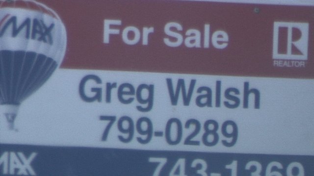

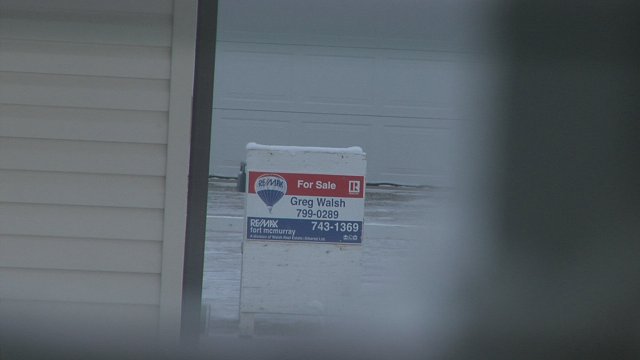

Attachment 20783
600mm lens (the sign is about 50m/163ft. away).

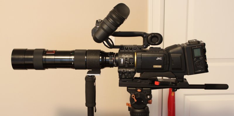

As per your suggestion, here it is with a monopod underneath it.
Attachment 20798
I’ll have to search the internet to see if there is anything I can support it with, as I don’t think the distances are in anyway, form, or shape standard (of the shelf).
Don Bloom December 27th, 2010 03:04 PM
I gotta say that's a monster lookeing piece of glass on that JVC. From the looks of it a monopod OR some sort of brace from the tripod head to the lens is definately needed. It would be tragic for that lens to to hit the ground because the mount broke. Have fun with it, I'll bet the image is awesome.

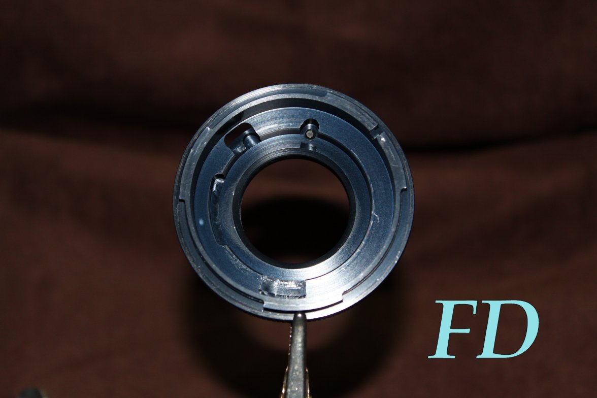

Sorry to say, but this adapter is for Canon FD (manual) lenses only.

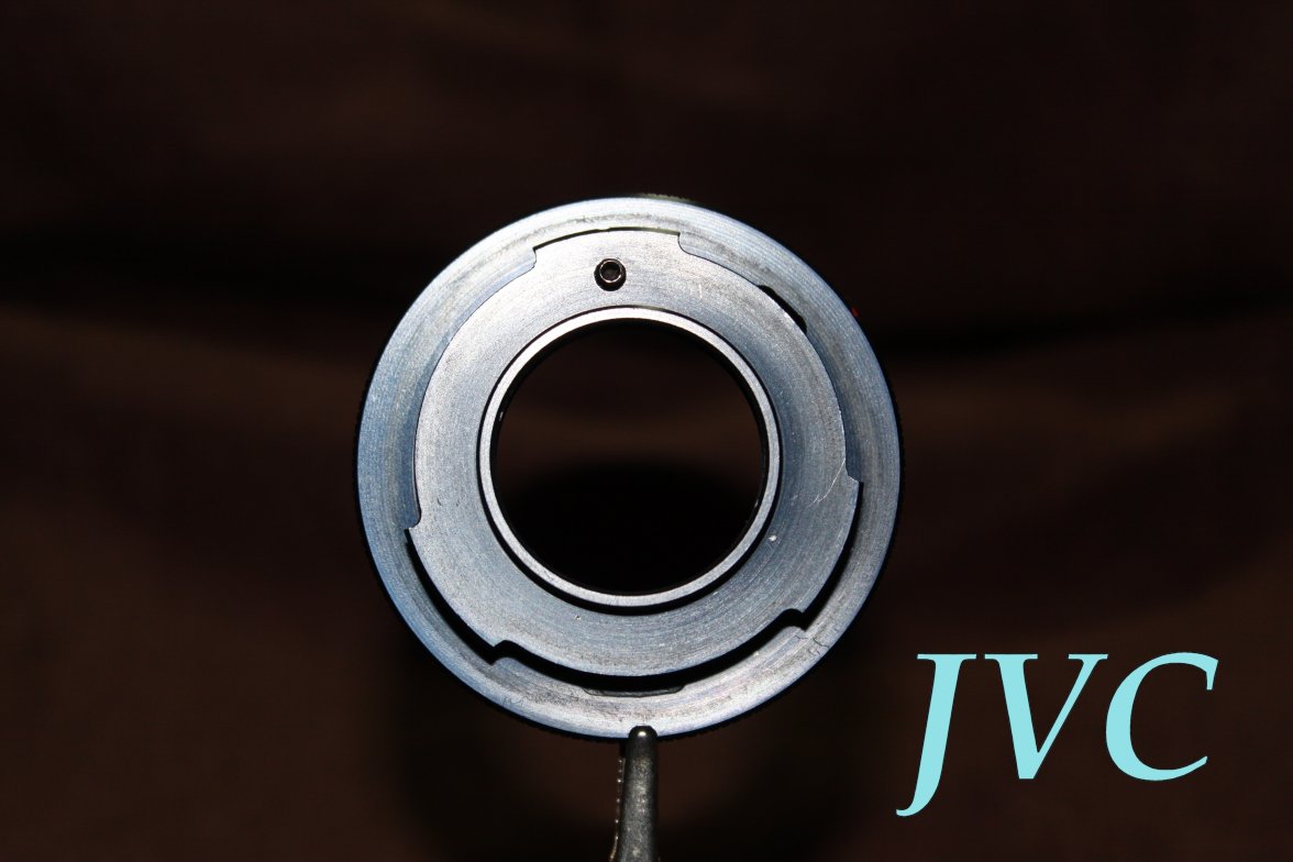

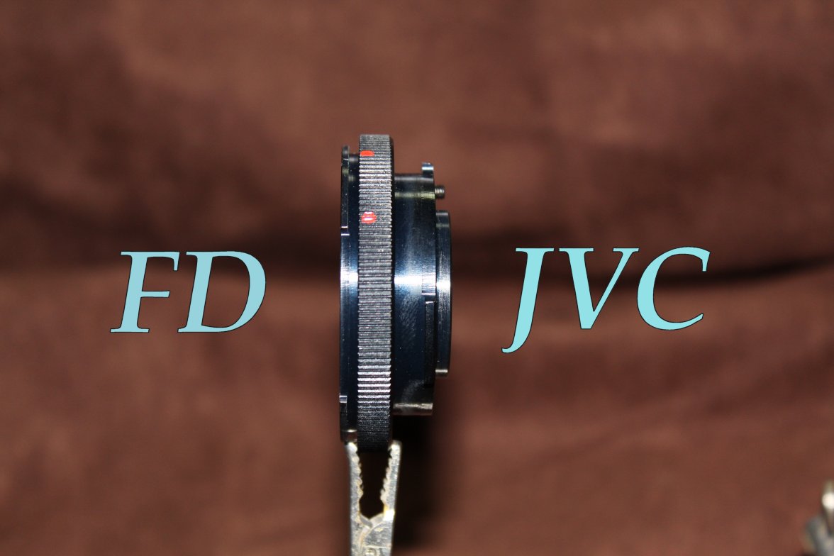

Here are my pictures of it:
Attachment 20833 JVC mount side.
Attachment 20834 Canon FD side.
Attachment 20835 From side...
I purchased it on eBay, from a fellow in Warsaw, Poland. As I am writing this, I see he still has 3 more available at $99USD each. The item number is 370463564061.

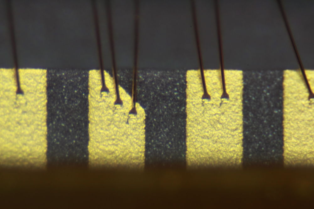

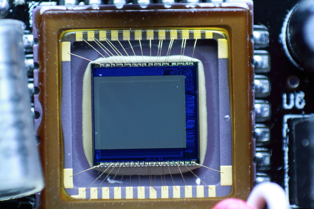

Here is an example I shot last year (this was done with DSLR camera, but I am aiming at doing the same with video):
Attachment 20842
¼” CCD video sensor.
Attachment 20843
Detail of the connections in the middle of the bottom row.
