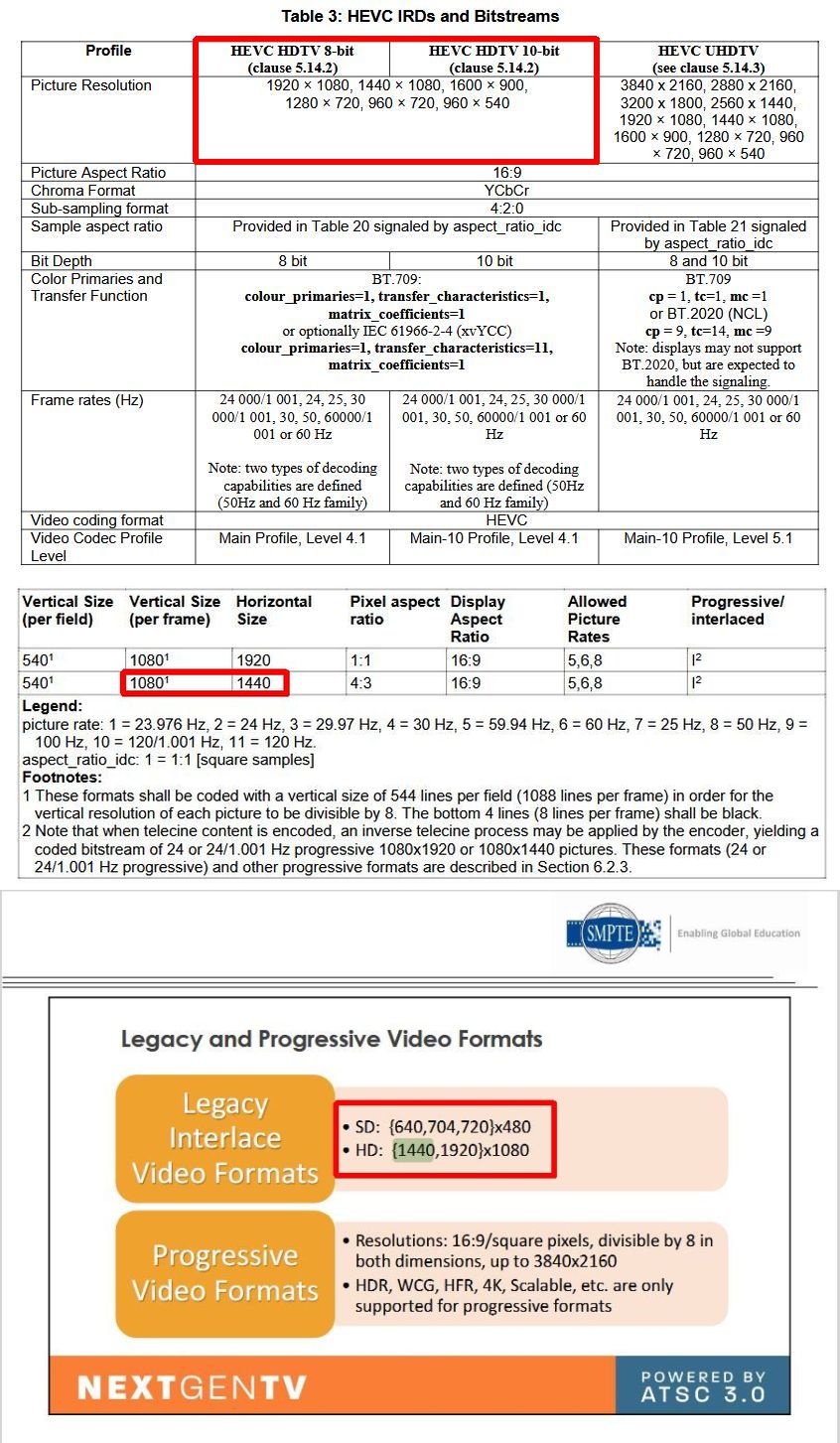

Sorry, the F350 is not full HD. The best resolution the camera can do is 1440x1080.
