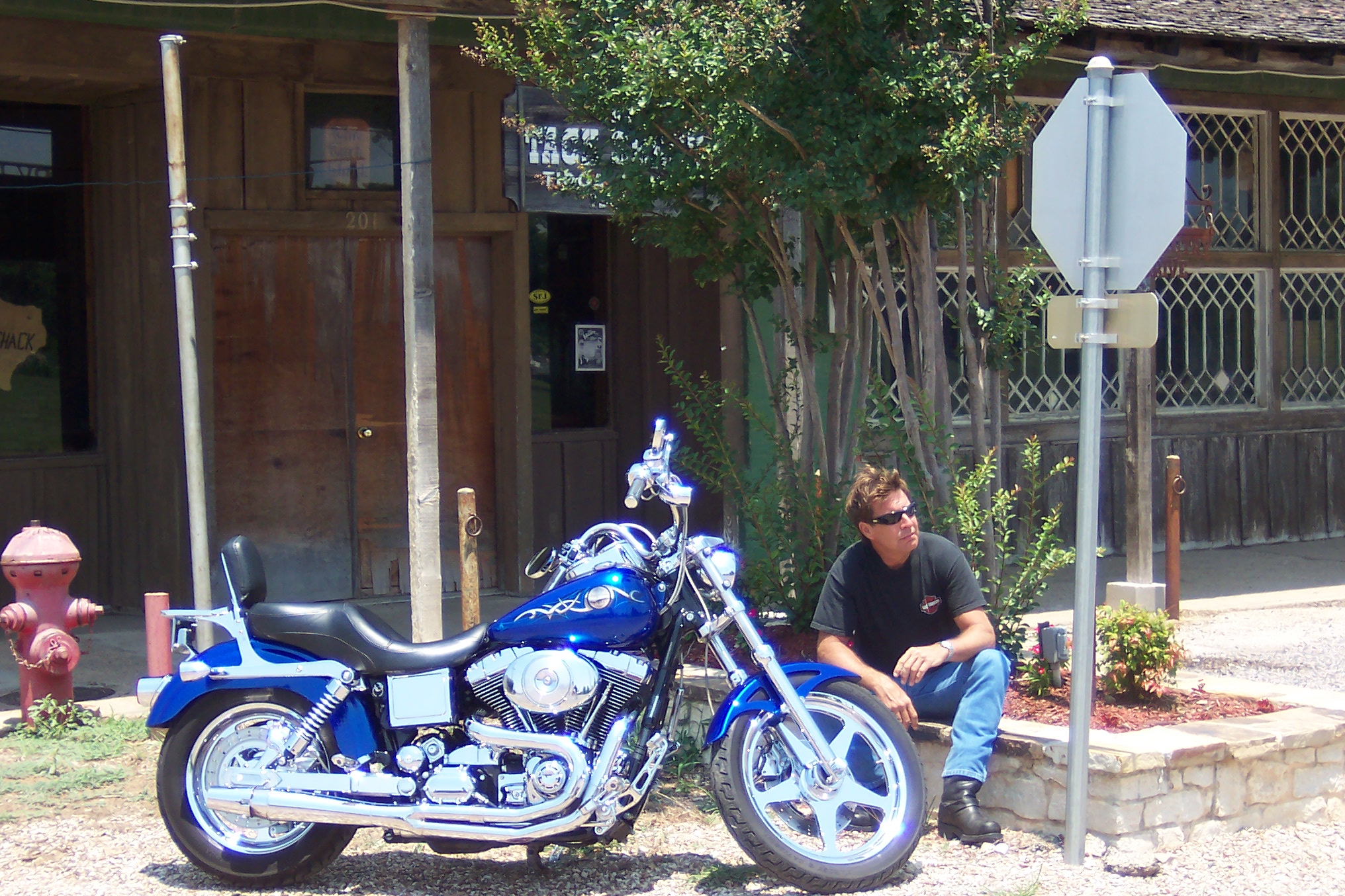

Purple fringing has been a problem for still camera sensors also. So let's just say it's 'sensor' overload. The problem is really bad with a high key light. See this attachment from a Kodak still camera of my friend's Harley.
Attachment 1976
Note the purple fringing where the front rim/tire meet as well as the handlebars with dark shadows. In short, a high contrast situation and a high key light (close to noon day sun..yuk). The aperture was f3.0 and shutter was at 1/750.
Attachment 1976
-gb-
That is exactly what I saw on my V1 and now on my XH-A1. To be completely honest I don't find these flares distracting.

The purple fringing in the bike shot above seems different to me than the fringing I'm discussing. The bike fringing is horrific and would drive me nuts if I saw it. It almost looks like 'blooming' on a CRT that's been overdriven.
