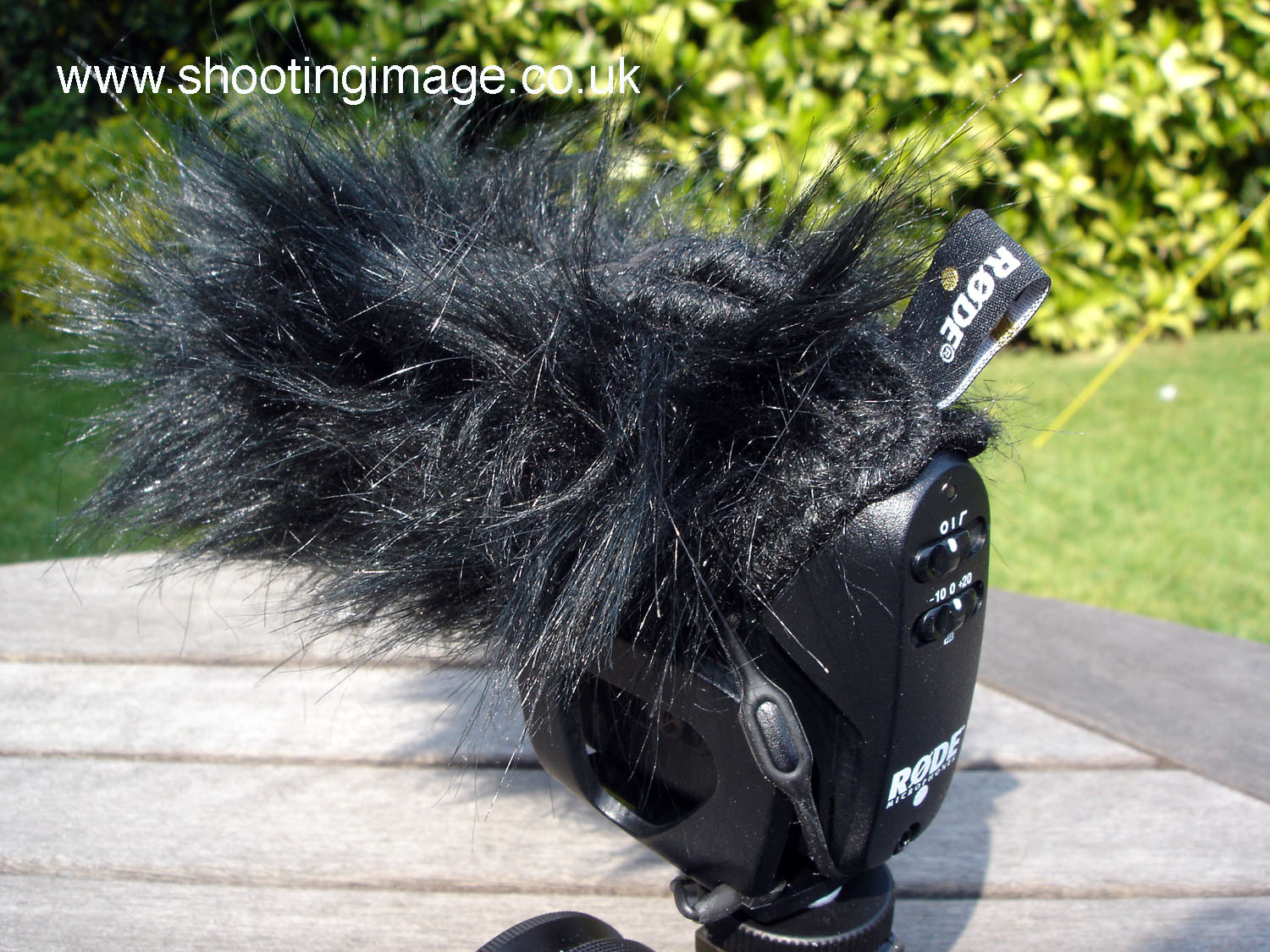

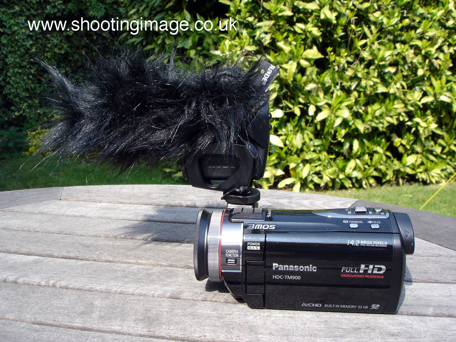

RODE Videomic Pro & Deadcat on TM900 - Pictures
Very true! Here are a couple of pics of the Rode Videomic Pro with its Rode deadcat mounted on the Panasonic TM900 accessory shoe. One shows how the deadcat fits across the back of the mic.
RODE Videomic Pro-rodevmpdcattm900.jpg   RODE Videomic Pro-rodevmpdcatclsup.jpg

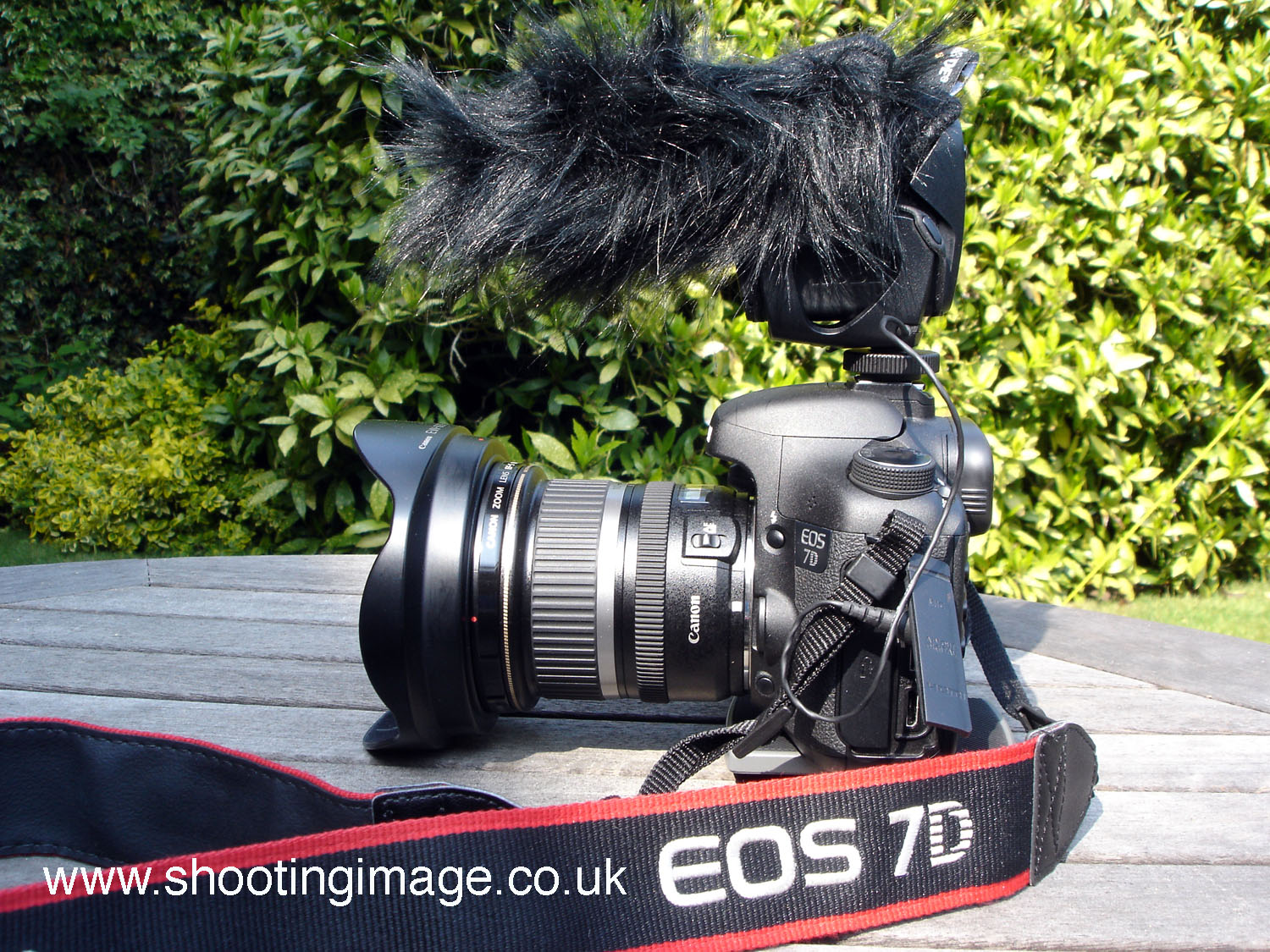

RODE Videomic Pro & Deadcat on Canon 7D - Picture
And here is a quick picture of the Rode Videomic Pro with its Rode deadcat mounted on the Canon 7D (with a Canon 10-22mm lens on).
