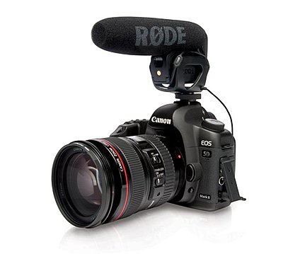

RODE has announced the new RODE Videomic Pro!
I've been testing the a pre-release unit and can say "WOW!" What a game changer. First, the sound quality is excellent - much better than you would expect from a small shotgun mic (especially if you've heard others). The size is perfect, the price is right, and the mounting options are awesome.
The real issue is that all of the on-camera mics on the market have output levels which are simply too low. When a camera has to boost up the levels, you get hiss, low fidelity, and often what can be described as just plain muddy sound. A lot of times, it's not the mics fault, that's what a high quality pre-amp is for - and what you'd see on a professional production. Unfortunately, for many of the camera manufacturers, audio is an after thought, and a lot of users, just want to plug and play right into the camera. Especially with today's entry level HD cameras and DSLR's. I can tell you that with the +20dB mode on the new Videomic Pro, DSLR users especially, are going to be happy with a nice clean gain stage built right into the mic.
The size of the RODE Videomic Pro is smaller than the original and fits better on a DSLR or small HD Camera like a Sony SR11. It's not so overwhelming like the original Videomic which felt (and looked) huge on smaller cameras. The shockmount has also been redesigned and is less springy. The previous model had issues with "bottoming" out on the base during fast movement. I always doubled up the bands on the original to stiffen things up and help fix this. The new RODE Videomic Pro still can have these bands slip off if not careful. During a snowmobiling adventure I quickly tossed the mic into my camera bag with the 5D, when I went to do my next shoot, a band had slipped off and caused the mic to bump into itself while recording on the next take. So under tough run-n-gun conditions, you'll want to check the bands. The audio I acquired was usable, but any movement was heard.
Remember, the key to great sound is to get the mic as close as you can to the subject and with the 10' RODE VC1 extension cable, you can easily get the mic off the camera and close to the sound source. The RODE Videomic Pro easily attaches to a standard 3/8" boom pole, 1/4-20 thread on a tripod, or simply via the camera's shoe mount.
The original Videomic is the world's #1 on-camera microphone. I'm happy to see RODE innovating and figuring out what the market needs. They found the problem with audio on small cameras, and introduced a remarkable solution. Great job guys.
Clips to follow...
RODE Videomic Pro-videomicpro_onslr__37949_zoom.jpg   RODE Videomic Pro-img_3998.jpg

Videomic Rubber Bands Tip
Excellent news! Thanks for posting. Looks great!
On the "rubber bands keep slipping off" problem that the original Rode Videomic was especially prone to suffer from, then perhaps I can share a simple tip that I developed - after much frustration with this aspect! Maybe this will help with the new design too? (It's hard to tell from the pics.)
I removed the Rode Videomic bands and put a tiny amount of Superglue in each notch of the suspension assembly, then put the bands back on - watch your fingers don't get stuck! Simple, no more problems with bands slipping off. When the bands eventually perish and need replacing they can still be "peeled off", followed by a little cleaning of the notches with a craft knife (if required) before repeating the process. Works for me!

I've had the VMPro (s/n 0000002) since last Nov, been running it through its paces and I agree with Guy, it's a winner.
My first impressions out of the box were, its light weight 86g (0.18lb), installing the 9volt battery almost doubles it.
The battery cover is not intuitive till you check the manual, then hey! it's a snap. Battery life is over 70hrs so at 5hrs a week for the average user (and that's a lot) you get about 3.5 months, then I bet you'll need the manual again to change the battery, I did. But it's all on the RODE website.
The VMPro is 15cms (5.9ins) long, so there won't be complaints about it hanging over the front of folks cameras. Yes the suspension needs to be checked just before you mount it to the camera, and Andys tip to anchor it in place is well worth checking out.
My first audio impression was the 2.5db boost at 10Kh. and almost no self noise, it really is noticable (no pun) Voices sound clean and natural.
That goes along with the current scene which sees pro mics having a top end boost, especially when the audio is very clean with very minimal noise. This boost also helps the top end frequency loss you get when the deadcat is installed.
One feature I like is the thin mic cable, 2mmx16cms no coils, a great improvement over the original VM.
RODE spend years designing their mics (the NTG-3 took more than 2) and they're always worth the wait.
