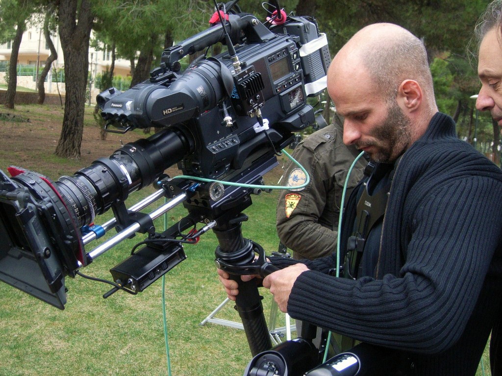

This is a straight set up with Varicam and Brevis with my relay
