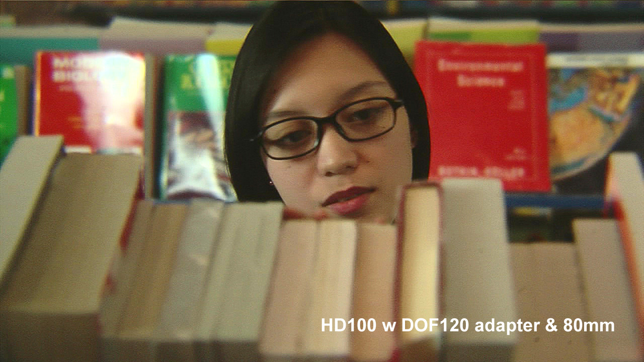

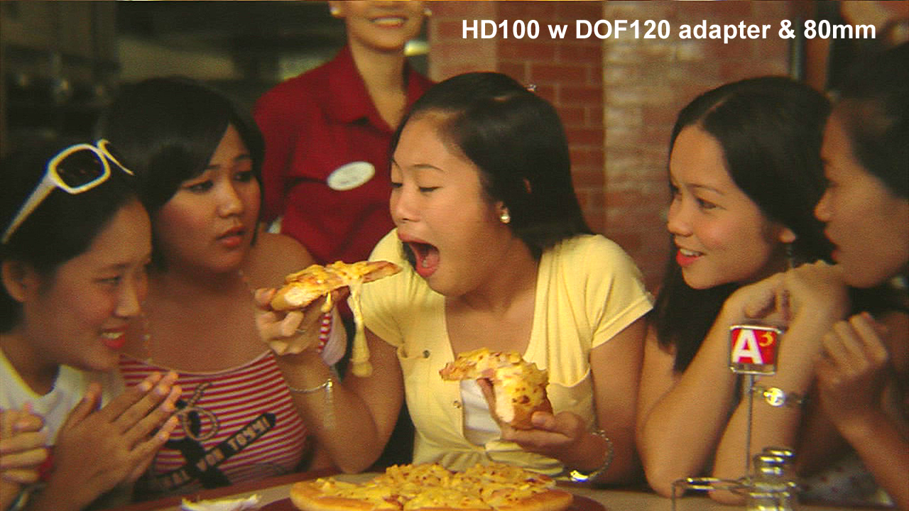

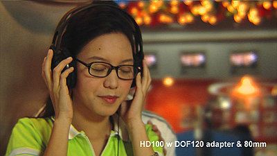

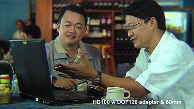

A commercial i shot with DIY lens adapter
Heres some grabs from a commercial using this adapter.
This was shot at f 1.9
Lens Adapter for HD100 finished.-music-store1.jpg   Lens Adapter for HD100 finished.-pizzaparlor.jpg
Lens Adapter for HD100 finished.-bookstore1.jpg   Lens Adapter for HD100 finished.-coffeeshop.jpg

The flange depth for mamiya 645 lenses is 63mm do you have infinity focus? What focal length are you using to hit the CD? This thing is shorter than most other 35mm adapters and with MF lenses no less. Nice work.
Charles Hurley is offline   Reply With Quote
Old March 12th, 2007, 05:25 AM   #15
Location: Allen, Texas U.S.A
Posts: 1,117
Charles,
Thats correct, the flange depth is 63mm depth.
Yeah, I do have infinite focus.
Among the 3 lenses I have for the adapter, the 45mm has the shortest MOD at 50 cm.
I positioned the GG in the same distance from the actual film plane so i get the same footprint as on the 120 negative.
You can even use the focus marks to get focus if need be.
Ted
