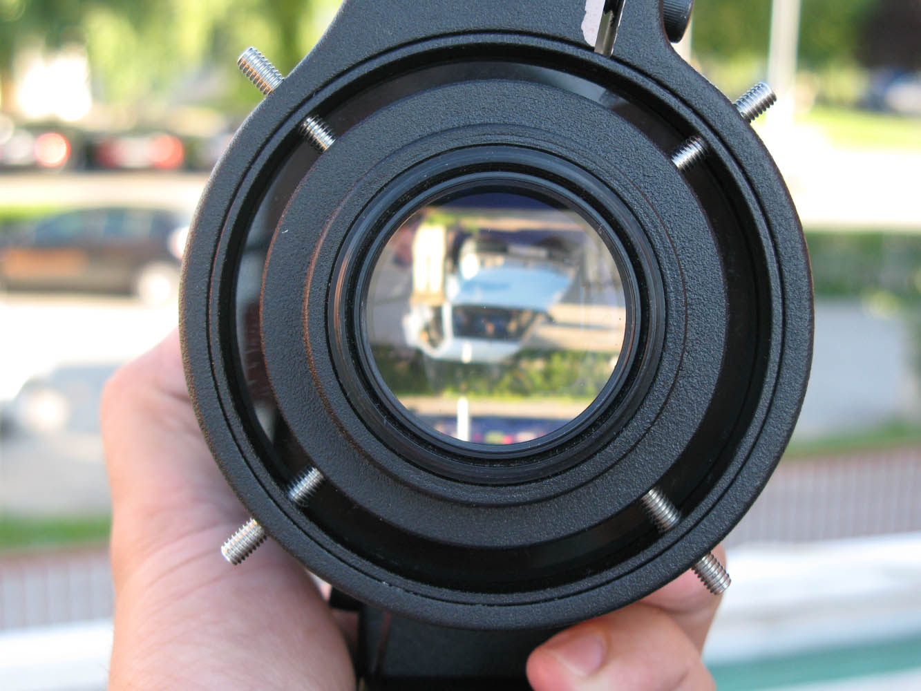

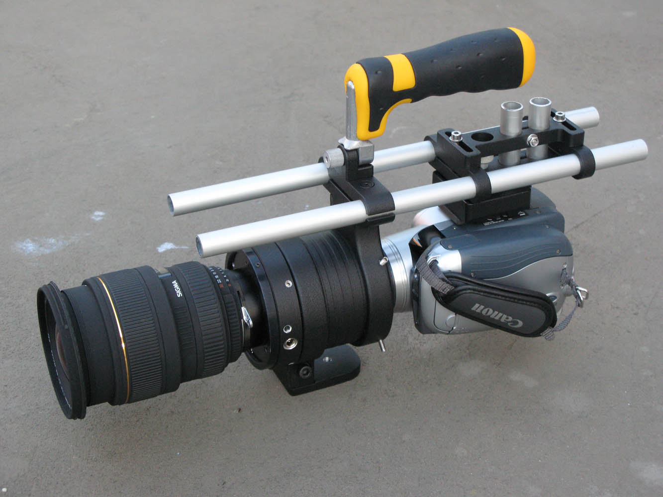

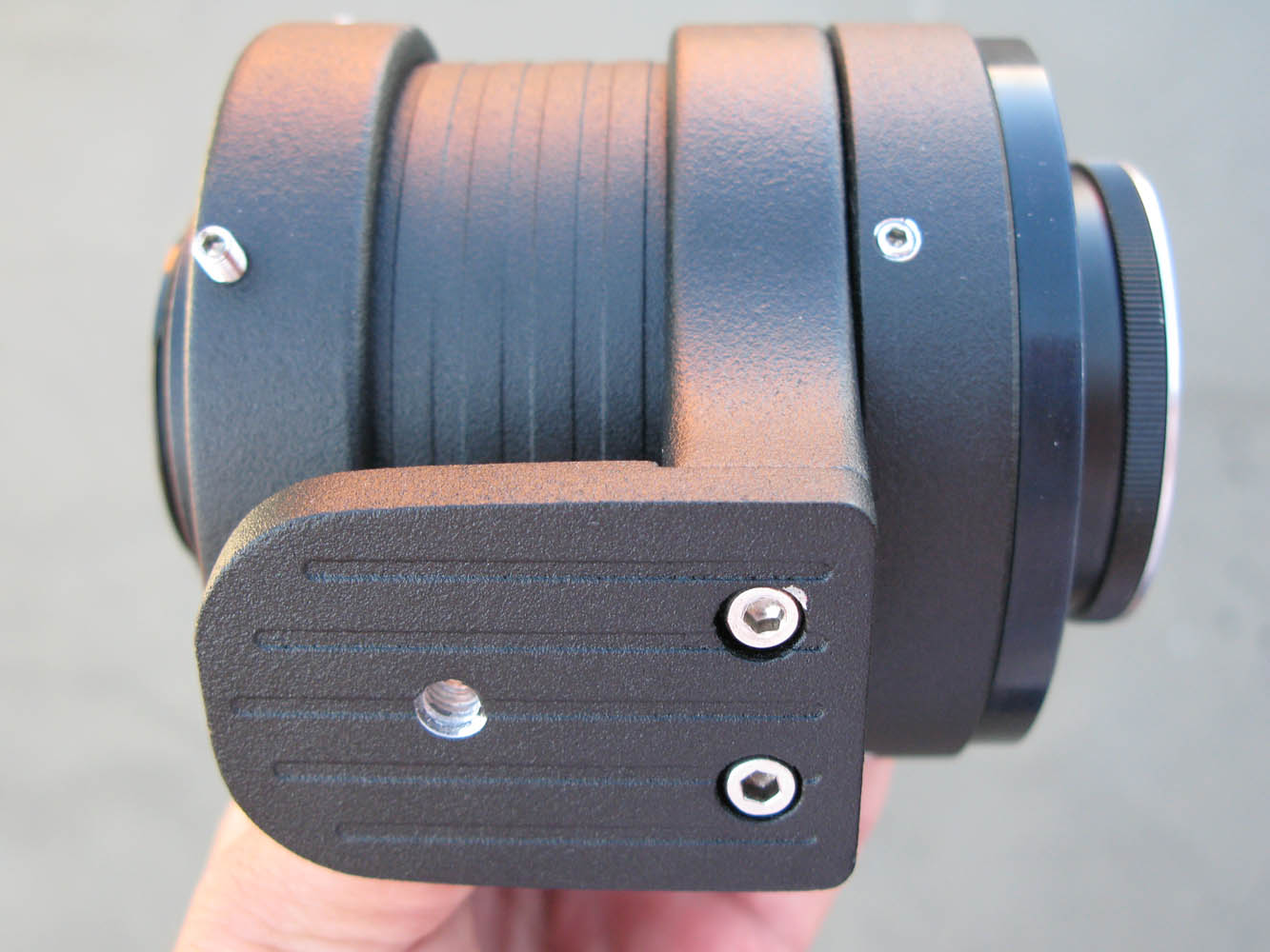

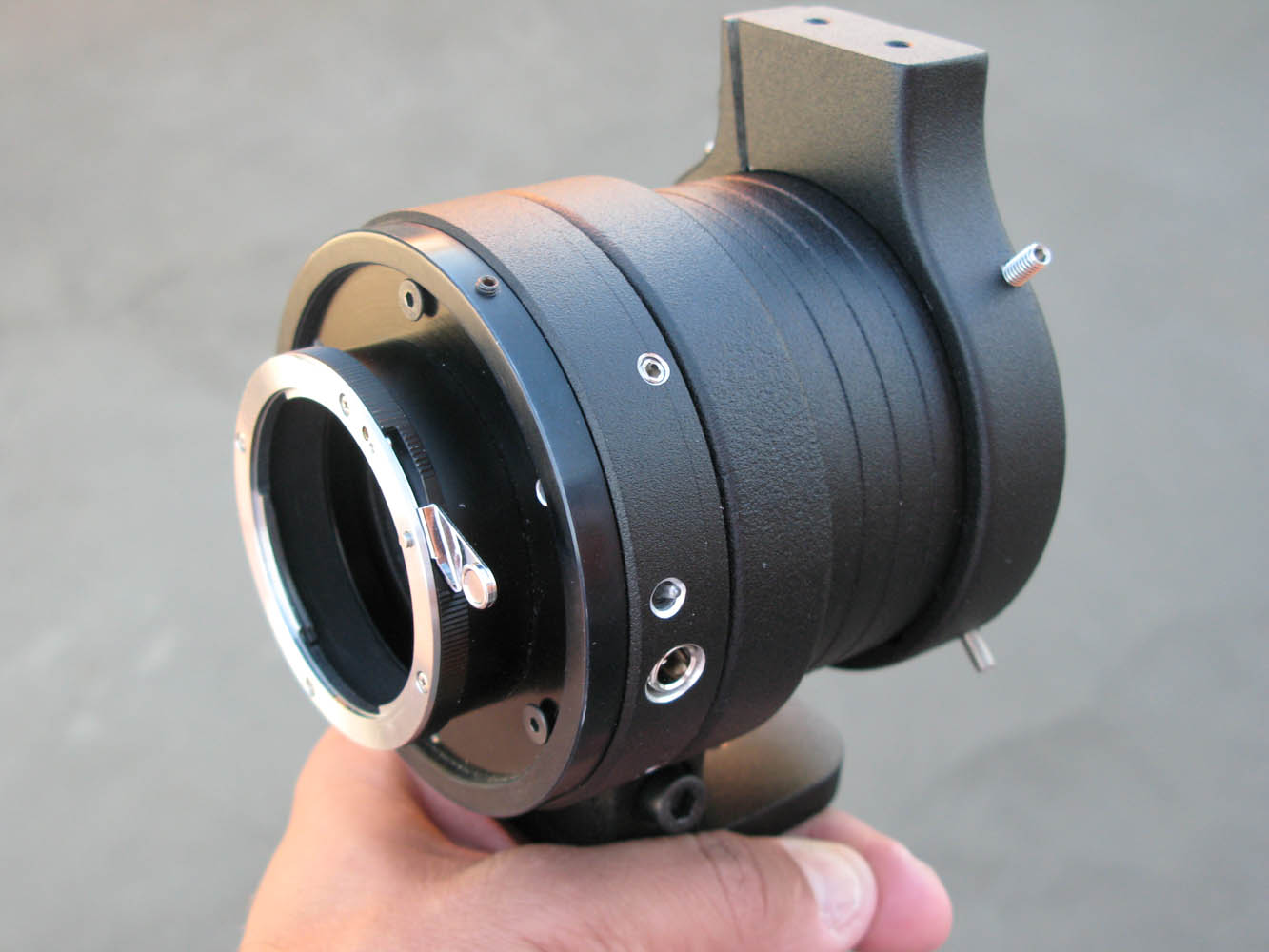

Same principle, new design
I made couple of those for me and my friends... A lot of parts custom made this time.
Enjoy...

A lot of info from my previous posts is changed, thats why I have changed my design to this last one. I have also changed gg and condenser lens and achromat. Now they are more easy to find and this combo gives much better image.
