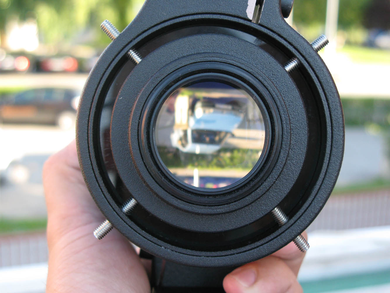

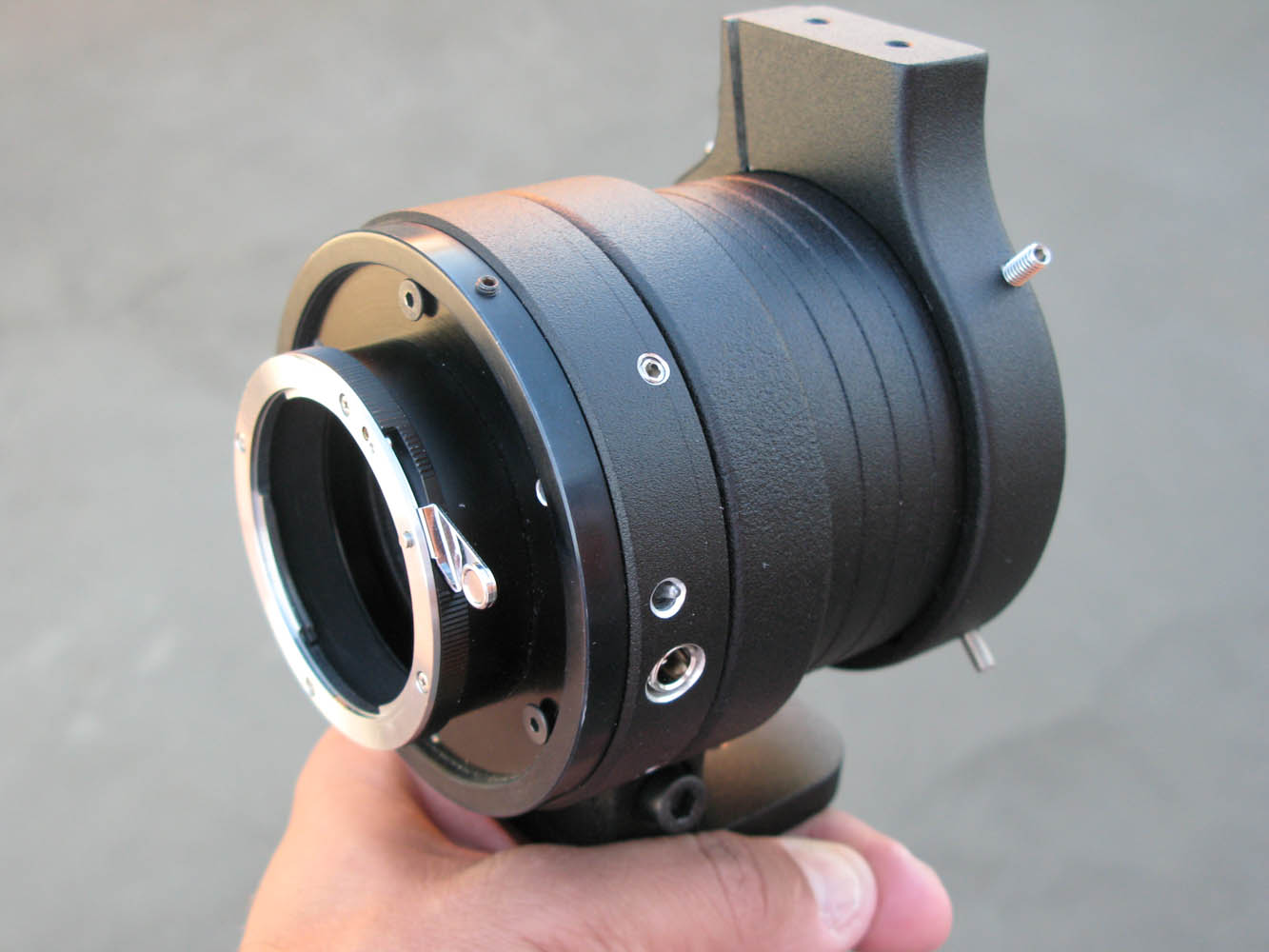

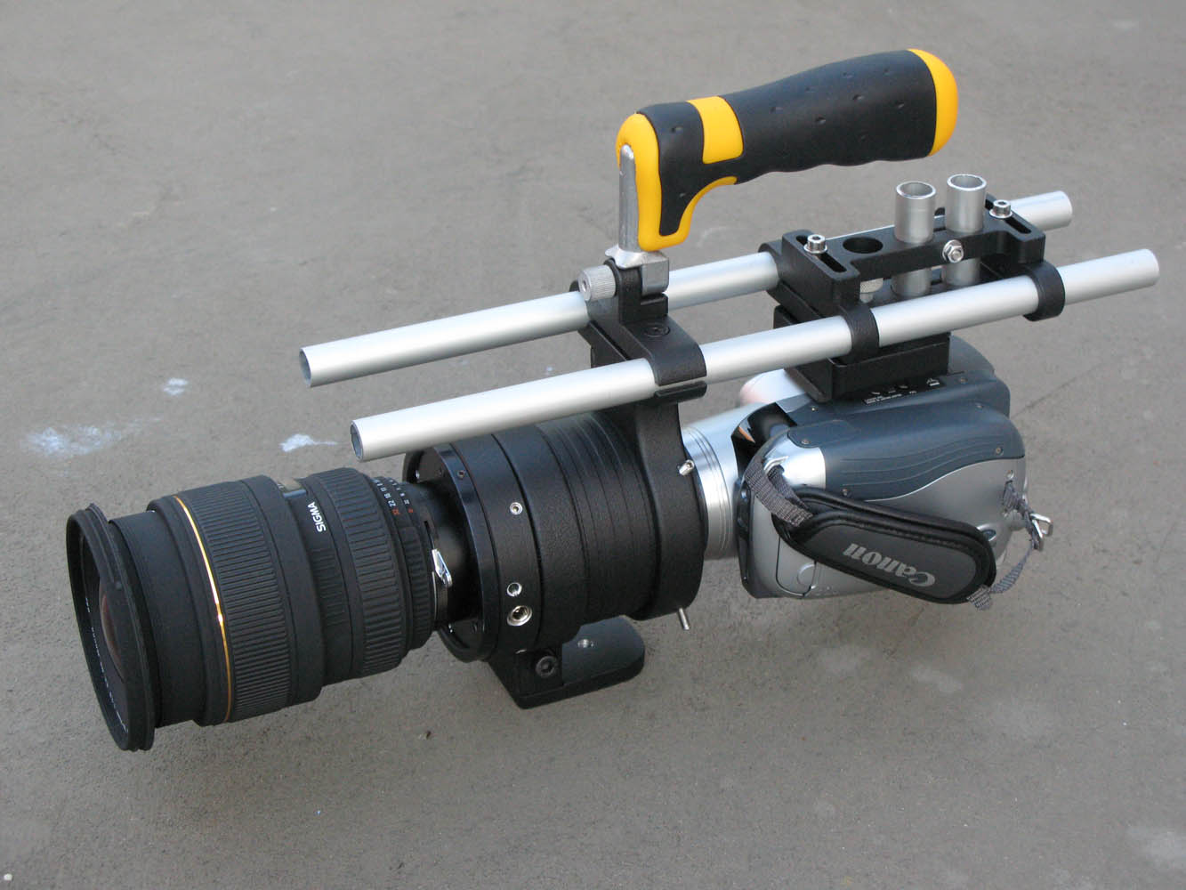

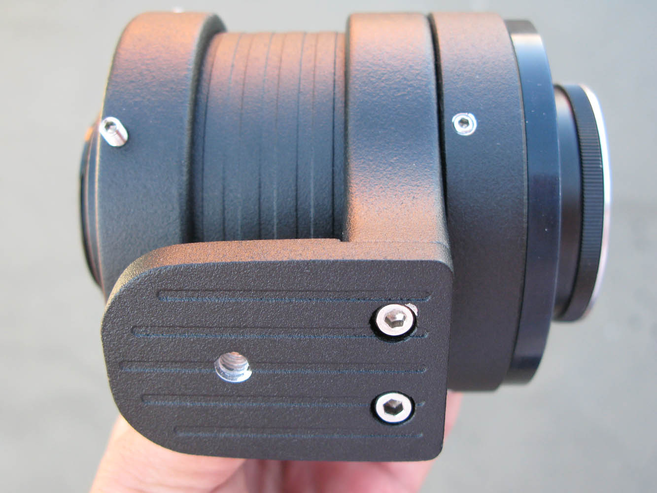

Old August 27th, 2009, 08:59 AM   #25
Location: Zagreb, Croatia
Posts: 171
Same principle, new design
I made couple of those for me and my friends... A lot of parts custom made this time.
Enjoy...
HV20 Flip mount and 35mm adapter-copy-img_1382.jpg   HV20 Flip mount and 35mm adapter-copy-img_1386.jpg
HV20 Flip mount and 35mm adapter-backofmyadapterwithgrabscrewsforxyadjustandachromatinmiddle.jpg   HV20 Flip mount and 35mm adapter-img_1391-copy.jpg
Igor Babic is offline   Reply With Quote

A lot of info from my previous posts is changed, thats why I have changed my design to this last one. I have also changed gg and condenser lens and achromat. Now they are more easy to find and this combo gives much better image.
