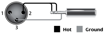

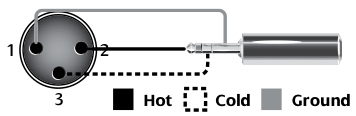

I wanted to report that I purchased a few XLR to Mini cables and ran a few tests. As it turns out using a regular XLR to Mini cable works fine, but there are a couple of problems to be aware of. The Hosa cable, I linked to above, works perfectly, but since it is only 12 inches long, it was too short to make it from the rear of my mic to the camera's mic input. I returned the Hosa cable and purchased an 18 inch cable by Comprehensive (link below). The new cable was the perfect length, and was much better quality, but was wired differently than the Hosa cable.
Comprehensive cable:
Comprehensive | EXF Stereo Mini Male to XLR | XLRJ-MPS-18INST
It turns out that the Hosa cable was specially wired to take the mono signal from my mic and split it into the left and right channels of the camera's mic input, providing sound to both the left and right channels of the camera. The Comprehensive cable, on the other hand, was wired like a standard XLR cable, and as a result, when connected to the camera, only the left channel was being recorded to tape. To get the Comprehensive cable to transfer the sound from the mic to both the left and right channels of the camera, I had to make a small modification. This modification is pretty easy to do, but does require a certain amount of skill with a soldering iron.
I have included images of the two wiring diagrams below. The first image shows how the Hosa cable was wired (correct), and the second image shows how the Comprehensive cable was wired (incorrect). I joined the "cold" wire from pin #3 to the #2 pin. I then split the ground wire in two and joined one wire to the #1 pin and the other to the #3 pin. The cable works perfectly and the camera is now receiving a left and right signal from the mic.
I hope that this helps,
Hugh

The correct wiring for a cable to connect a female XLR mini-jack for a mono microphone connected to a mini-jack stereo camera input is:
XLR Pin 1 to mini-jack sleeve
XLR pin 2 to Mini Jack tip and ring
XLR pin 3 to mini-jack sleeve (or to XLR pin 1).
This will give the mono audio on both L and R channels in the camera.
A word of warning - beware of longer leads than around 1 metre at the unbalanced (mini-jack) end of the cable, you will suffer from induced hum.
For longer cables you need a balanced/unbalanced converter close to the camera end, with a long XLR lead up-stream, and a short unbalanced cable downstream. In the UK Canford Audio sell these.
