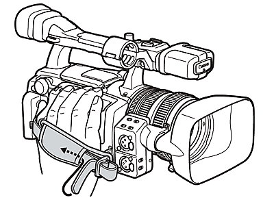

Sorry for my ignorance, but what is the "grip belt?" Are they referring to the handle on the top of the camera?
From the instruction manual:
Notice from Canon regarding XH Series handgrip (XH A1 / A1S / G1 / G1S)-handgrip.jpg
