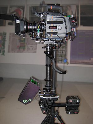

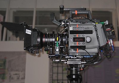

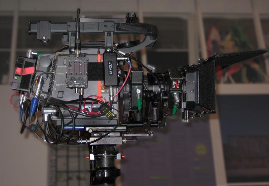

We just wrapped a 7 day pilot for ABC with the F35. The camera performed well and the images were beautiful, very soft and flattering on the actresses even without diffusion.
On the operating end of things, it's got a way to go. The supplied viewfinder is based on an ENG design with a right angle optic and the guts projecting to the right, which makes it difficult to orient fore or aft of the designated mount via extended finder bar (you have to slide it massively away from the body). Sony is working on a 2nd gen. viewfinder, but with the F23 having been out for as long as it had, I would have thought that they might have cracked this nut earlier.
We forewent mounting the SRW deck on the camera, preferring to keep it at the DIT tent with fiber link which worked flawlessly. This kept the power draw and weight of the camera down significantly but it did make balancing for handheld difficult for the reasons listed above. We were primarily a handheld show so I ended up removing the eyepiece and using the finder in flip-out mode, jacked as far forward as I could which was generally right above the eyebrow. Since it's near impossible to judge critical focus in the eyepiece anyway, I was able to see more than well enough to frame this way and reduced a lot of eye and neck strain in the meantime. We also used the Easyrig mount to transfer much of the weight to the body, which helped tremendously with stamina (some takes were 20 minutes long, and the camera weighed in at probably 35 lbs plus).
I did find it quite easy and relatively light for Steadicam work, nothing much to report on in that arena.
When Sony introduces their onboard flash mags, this camera coupled with an HD transmitter and the Wifi-based remote paint control will make this a really attractive film replacement from a mobility standpoint--no cables!
Sony F35--first experience-f35full.jpg   Sony F35--first experience-ffright2.jpg
