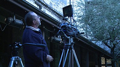

Here are a few still-images of a camera setup check for a musical performance to be covered in a few days time in Fremantle Western Australia.
The camera mix is two REDs to shoot 3K, one SI2K to shoot 2K and 2 JVC GY-HD100s to do the best they can as the close-up cameras either side of stage. Final intended output may be to HD and SD broadcast and SD DVD-Video.
1. SI2K and RED.

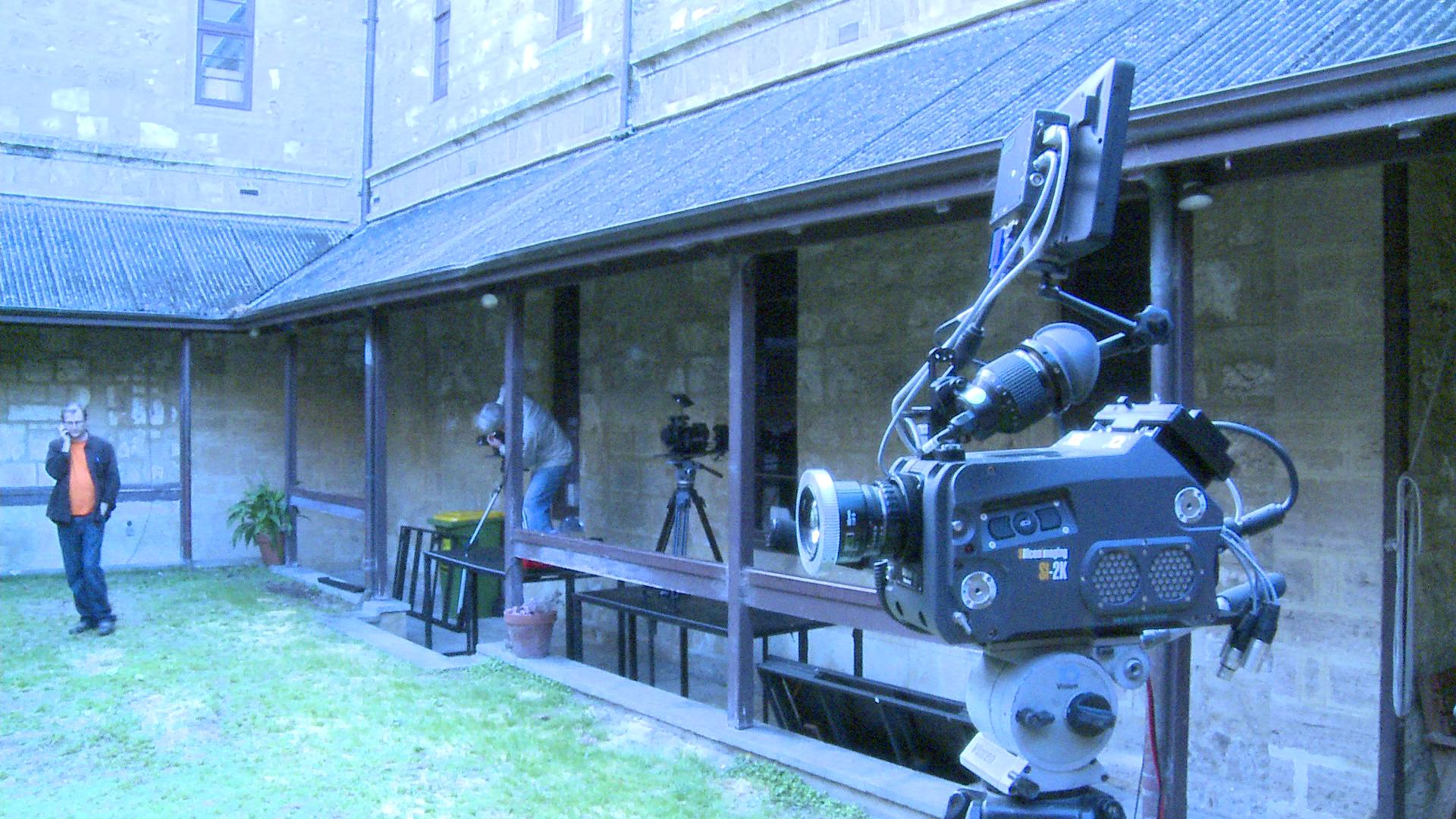

2. Steve Rice with his SI2K.

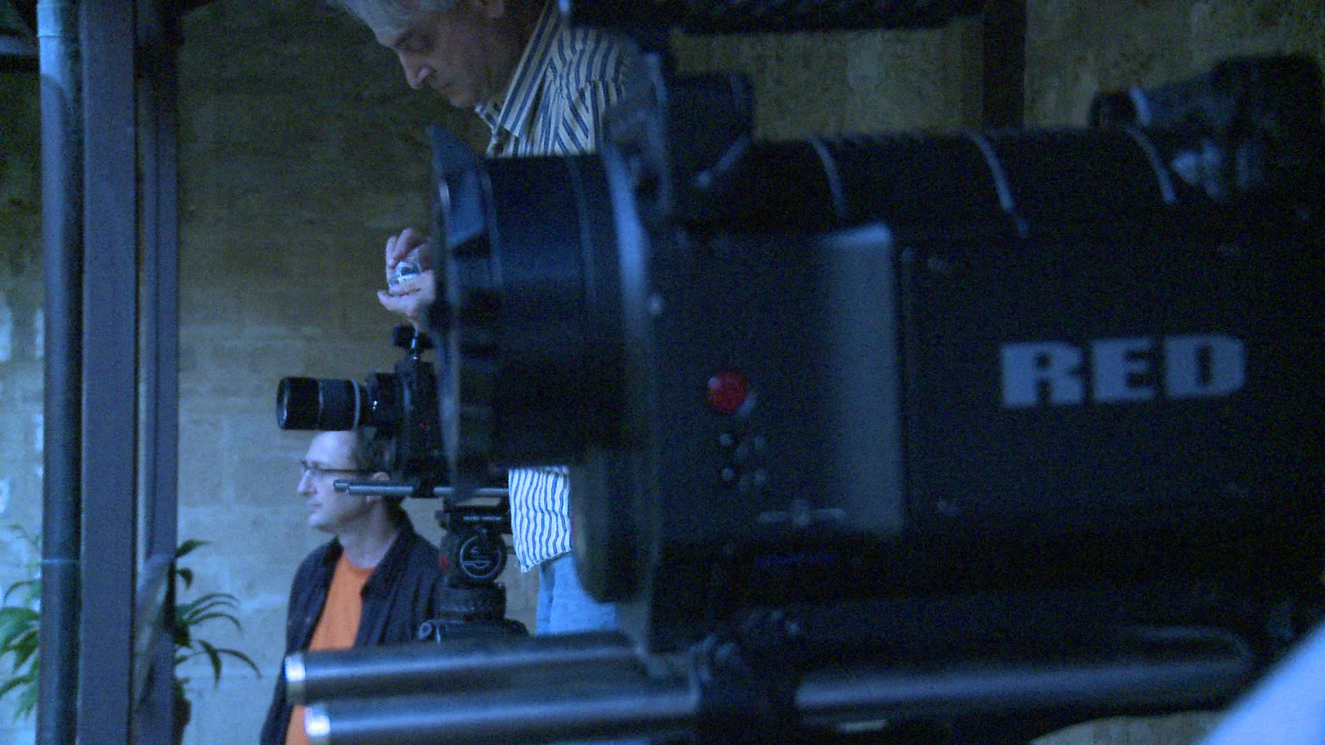

3. Wrangling the REDS.
It is believed there are now four REDs in Western Australia and one S12K that we know of.
Si2k And Red Cohabitation-si2k-red.jpg   Si2k And Red Cohabitation-steve-rice-si2k.jpg
