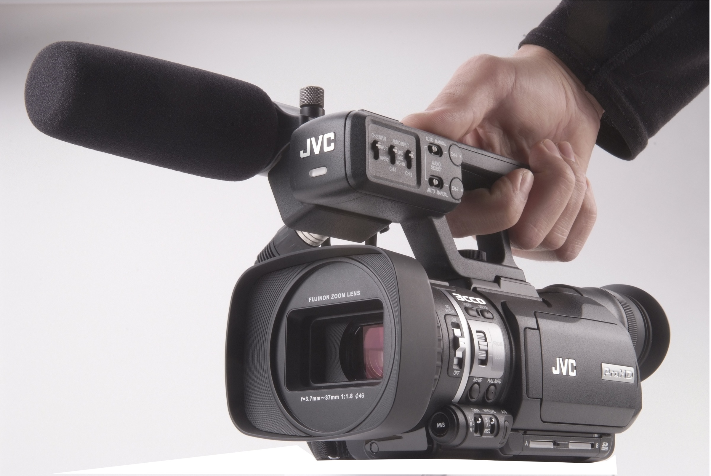

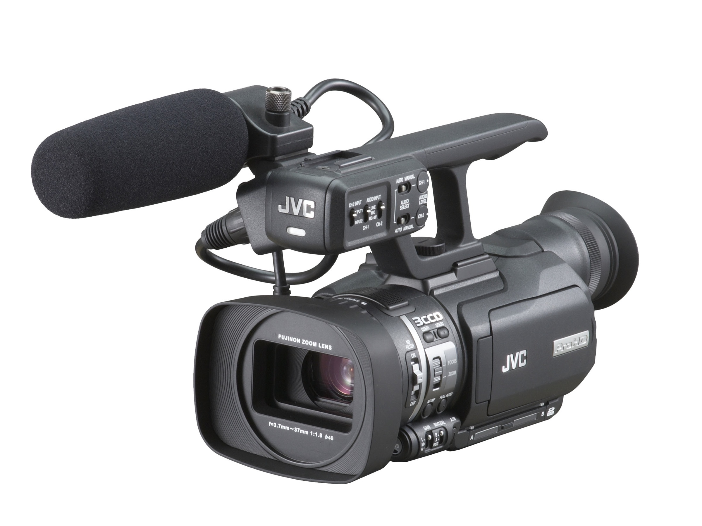

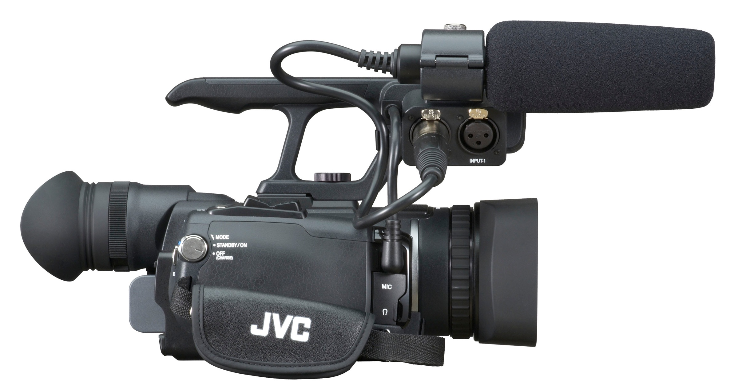

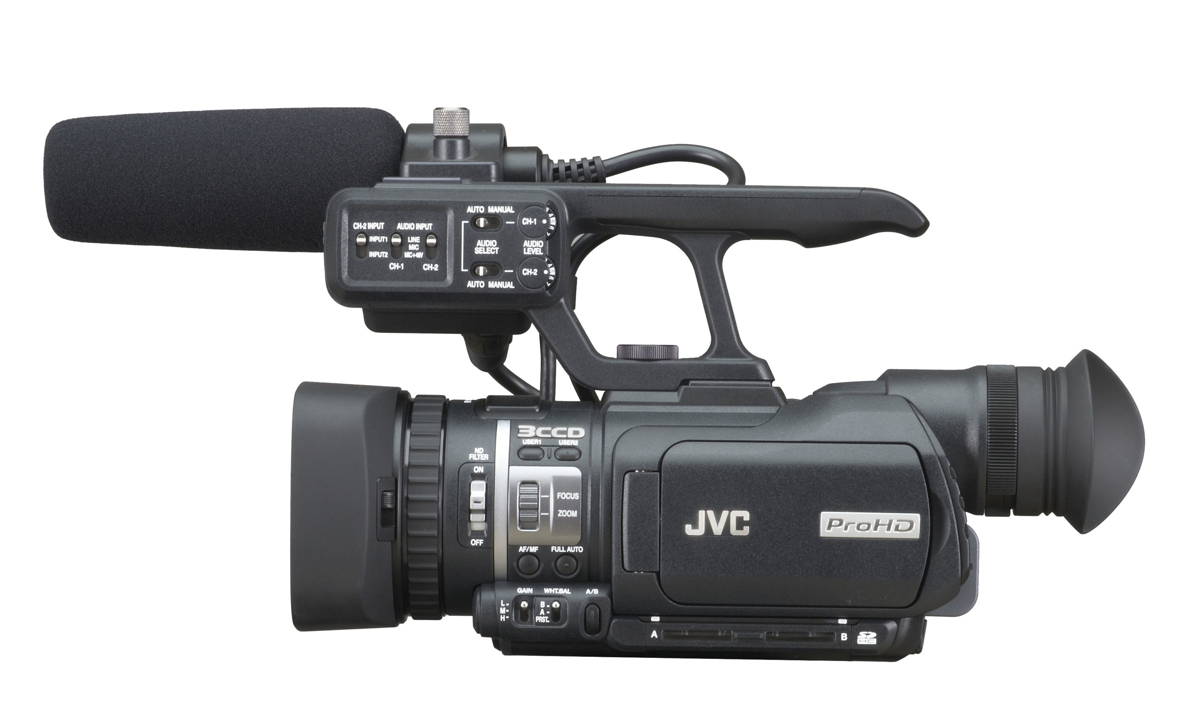

Specs for new GY-HM100 ProHD Camcorder
Anyone who attended the Final Cut Pro Supermeet during Macworld 2009 was treated to the unveiling of the new JVC GY-HM100 ProHD Camcorder.
So why was this camcorder revealed during an Apple related event?
Because this camcorder can record both 720p and 1080i/p directly to SDHC cards in Quicktime files ready for immediate use in Final Cut Pro. This marks the first time Apple has licensed Quicktime for use in a HD camcorder. (At the moment I believe the HDV codec (mpeg2 long-GOP) for Quicktime is used in this mode but will confirm tomorrow during my hands-on test.)
So what about all the other editing systems?
Besides Quicktime the HM100 also records to an "ISO Based" Mpeg-2 Long-GOP Media File Format at up to 35Mbps for compatibility "with all major non-linear editing systems." The 'rumour mill' suggests that this is actually Sony's XDCAM EX format so I would guess that if your NLE works with Sony EX1/EX3 footage it will also accept footage from the HM100.
What pixel dimensions, frame rates and bit rates can this camera acquire and record?
1440x1080/60i 25Mbps
1440x1080/50i 25Mbps
1440x1080/60i 35Mbps
1440x1080/50i 35Mbps
1920x1080/60i 35Mbps
1920x1080/50i 35Mbps
1920x1080/30p 35Mbps
1920x1080/25p 35Mbps
1920x1080/24p 35Mbps
1280x720/60p 19Mbps
1280x720/50p 19Mbps
1280x720/30p 19Mbps
1280x720/50p 19Mbps
1280x720/24p 19Mbps
1280x720/50p 35Mbps
1280x720/60p 35Mbps
1280x720/25p 35Mbps
1280x720/30p 35Mbps
1280x720/24p 35Mbps
Audio? UNCOMPRESSED 16bit 48Khz LPCM 2 channel. Balanced XLR, internal mic and 1/8" mini jack.
How many SDHC card slots? 2
How fast do the SDHC cards need to be? Class 6 at least... even for 19Mbps 720p. (I recently bought some 4GB SDHC class 6 cards from Best Buy for $19.99 each. By my calculations 4GB would hold about 22 minutes of 19Mbps and 12 minutes of 35Mbps.)
How big is the CCD? 1/4"
How about the lens? Built-in Fujinon 10x3.7mm (equivalent to 39mm~390mm for FF35mm) F=1.8
Manual or Auto Focus. Focus Assist as well. 47mm filter size. Manual Zoom (switch toggles ring for manual focus or zoom.)
How big is it? Approx 5.5" x 7" x 14" (The 14" length probably included the boom mic.)
Weight? Around 3.75 pounds with battery.
Optical Image Stabilizer Yes
LCD? 2.8"
Still photos? Yes works as a digital still camera that records jpegs. 1/4 to 1/8000 shutter speed. ISO100,200,400,1000, up to 1920x1080 resolution.
Outputs and interfaces? Component video, HDMI, USB2 (miniB), XLR, headphone 1/8", mic in 1/8", dc in.
Digital Signal Processor? Most of the same features as a HD200.
Detail, Knee Auto-80-85-90-95-100%, Gamma off-standard-cinema, Gamma level, Color Matrix, White balance A, B, preset and FAW.
Shutter 1/4 ~1/10000
Gain 0,3,6,9,12,15,18dB ALC
Three User Buttons assignable as FOCUS ASSIST,COLOR BAR,TC SETTING,TELE MACRO,LOLUX,ZEBRA,CLIP CONTINUOUS OFF,NONE
ETA? April 2009
Here's the link to the intro video: GY-HM100 Intro Video
Press release: JVC Press Release - New Final-Cut-Pro™-Ready Solid State Camcorders
JVC detail page: http://pro.jvc.com/prof/attributes/t...&feature_id=02
That's all I know for now. More tomorrow after I get it in my hands.
Specs for new GY-HM100 ProHD Camcorder-gy-hm100st1.jpg   Specs for new GY-HM100 ProHD Camcorder-gy-hm100sidea.jpg
Specs for new GY-HM100 ProHD Camcorder-gy-hm100sideb.jpg   Specs for new GY-HM100 ProHD Camcorder-hm100_lfront_hand.jpg
