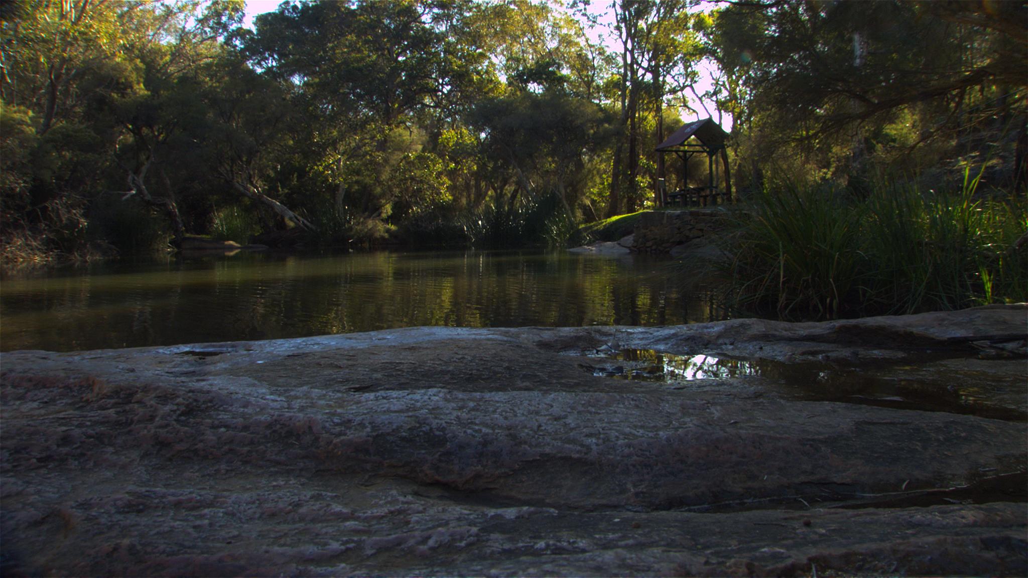

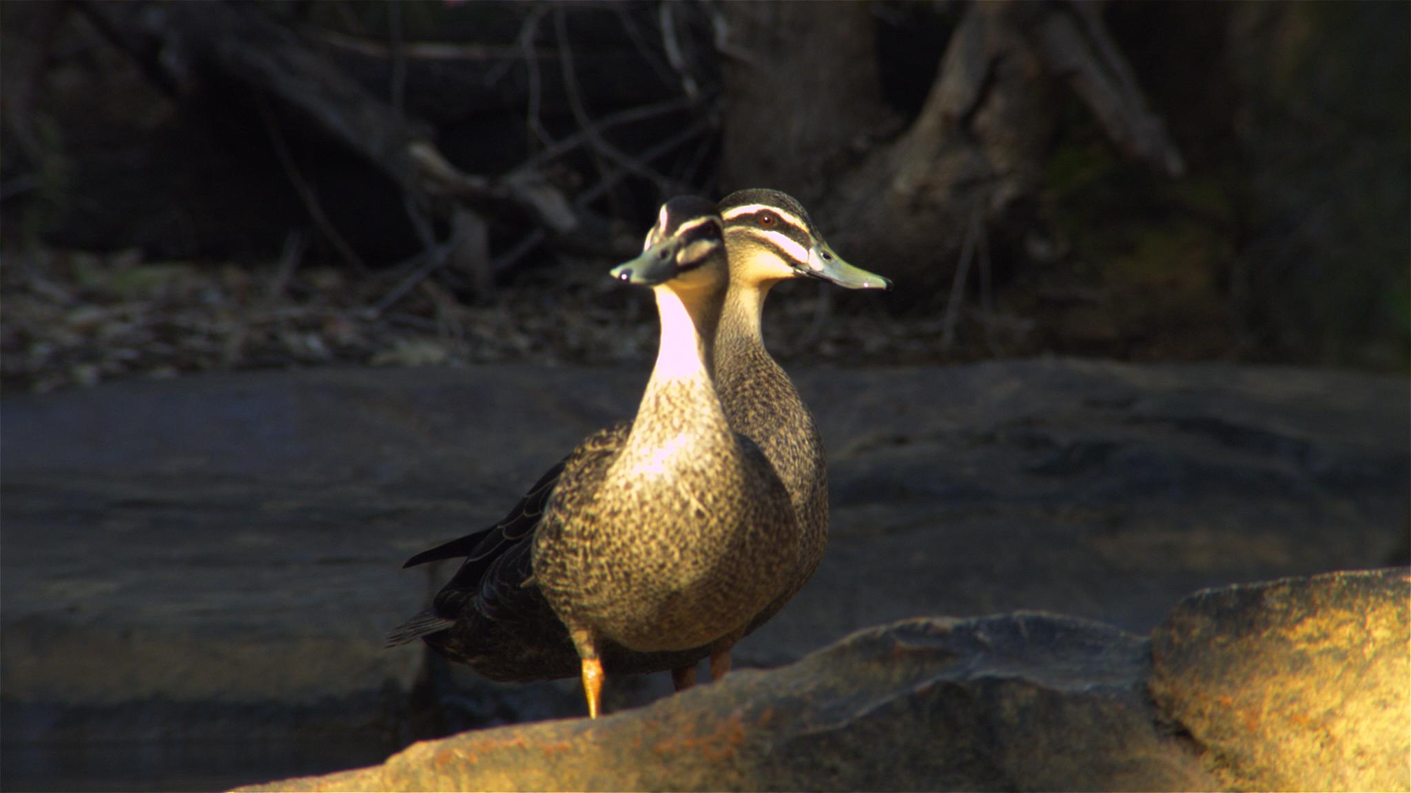

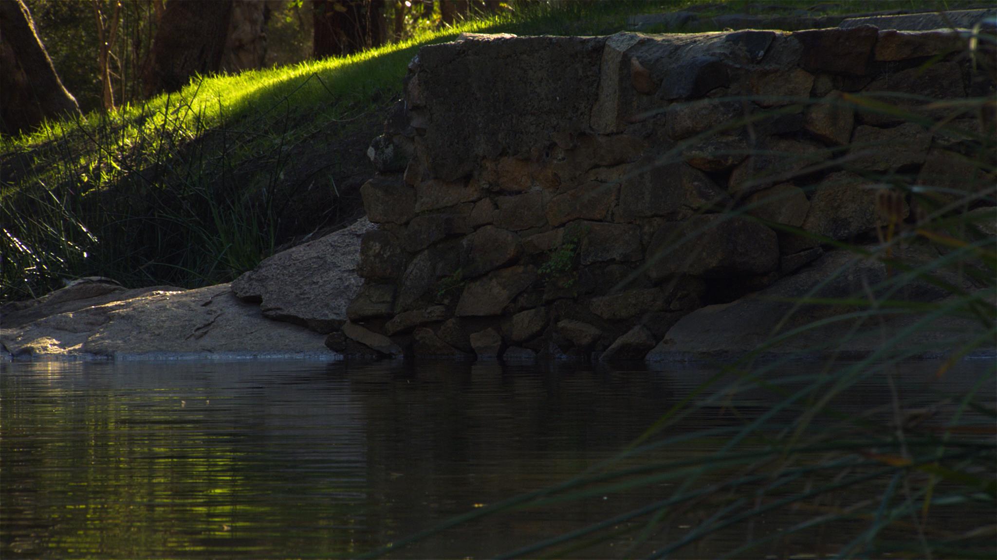

Here are some images from the lens. I applied 25 points of sharpen to them as they are headed for a local newsetter. No colour grade has been done. A bit of black and white levelling was done in some which were a bit dark in places.
The Nikon on the B4 adaptor yields surprsingly sharp images given it is a worn and damaged lens. For a zoom, apparent contrast is also pleasing. There are some marks on the front element which preclude from shooting against the light. When focusing, the lens "breathes" quite markedly.
Contrary to my ealrier comment above, when the doubler is switched in, the image is sharper than was apparent in the first quick tests I did.
The lens does slightly vignette the left corners at wide, clears as the zoom progresses then again more apparent part way through the zoom at about 25mm then is clear through the remaining movement.
There is a chromatic abberation apparent at the left margin of the image. This may be in a zone of the lens which would not be apparent in the slightly smaller image area the 2/3" video cameras see.
Prime lenses still rule however this one has a handily convenient range.
Image details as laid out
12
34
1. Lens in standard setting at 127.5mm.
2. Lens in standard setting at 127.5mm.
3. Lens in standard setting at about 12mm.
4. Lens with doubler selected at 127.5mm.
The subject is Roley Pool, a local swimming hole before people became paranoid about snakes, snags, leeches, cobbler stings (local catfish) and pollution from golf courses and housing developments, climate change and heavier city water usage from the dam upstream restricted water flows.
The stoneworks are all that is left of improvements from the great-depression era, when apparently community volunteer work went into making a diving platform with springboard, some rather rudimentary toilets and change rooms. Now people just want all their amenities on tap, with not so many being prepared to donate time, materials and bodily effort into making things happen.

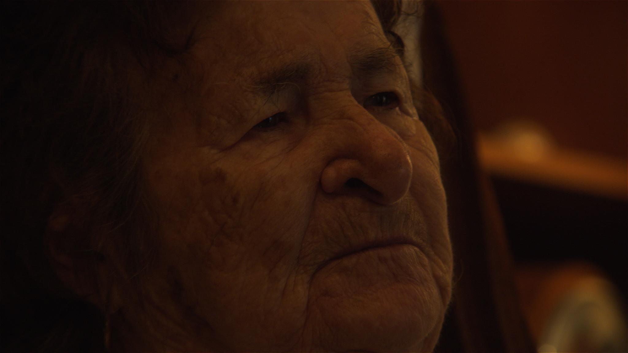

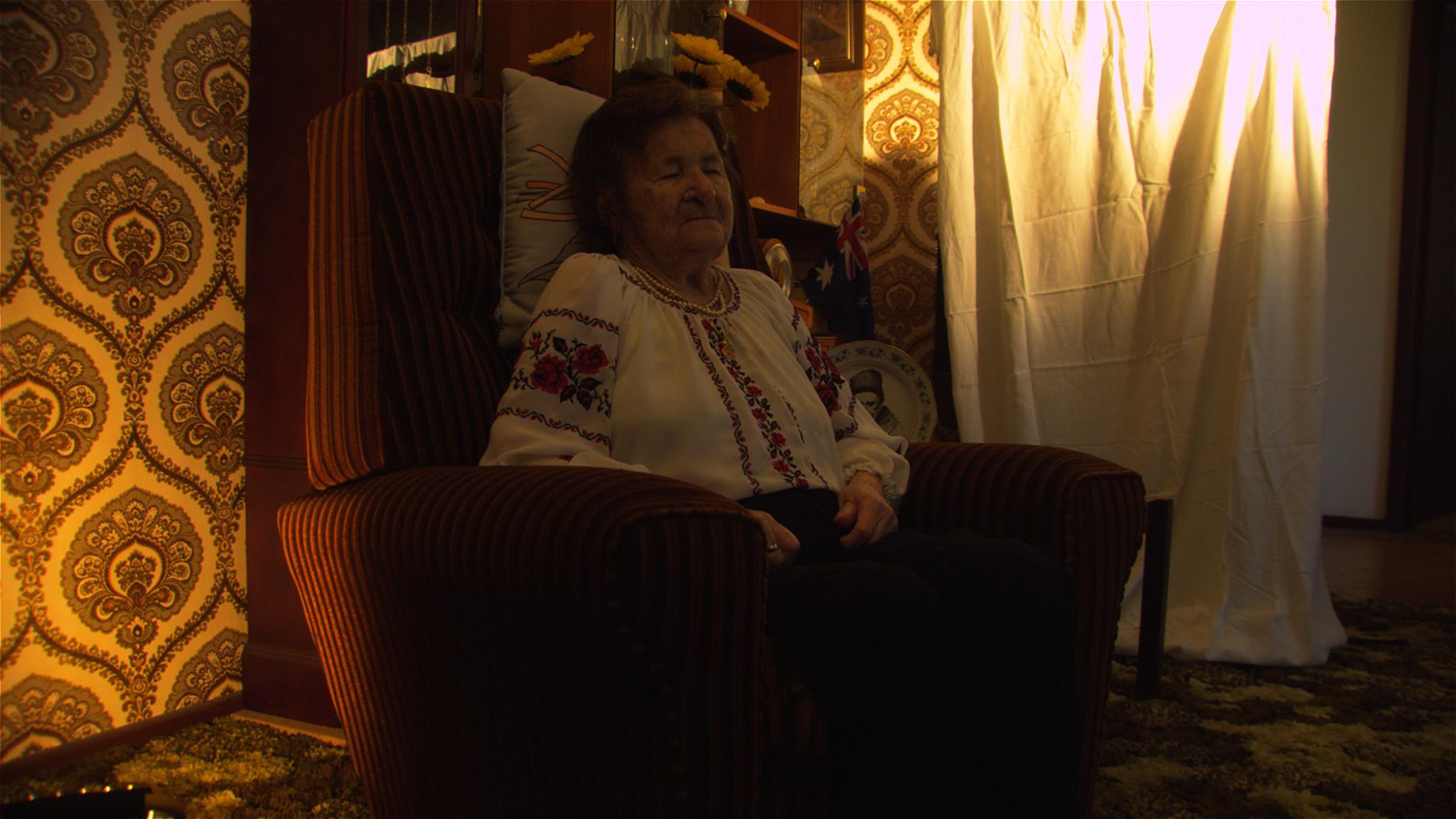

Some frame grabs from oral history interview. - Second cam. Lens - TV Nikon.
The first is an over-wide view which illustrates our rough and ready lighting setup.
Main cam was placed in traditional interview positions with prime lenses 16mm and then 25mm for supplemental interview and closer view of hand-gestures. Second cam was running to pick up hand-gestures but was a little too noisy for the sound guy so we shut it down.

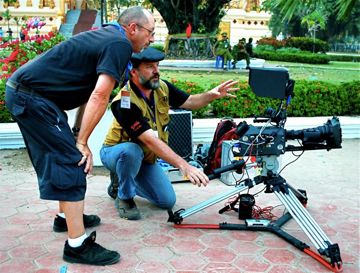

Here's a happy snap from the Northern Thailand and Laos shoot. Makes me wish I had been there as the river shot is very reminiscent for me of General MacArthur's Island just off Morotai.
1.2.
3.4.
1. Director. James With ( wearing beret ), Cameraman. Steve Rice. Location. Vientiane City, Laos.
2. Director. James With, Cameraman. Steve Rice. Location Mekong River, Vientiane, Laos.
3. Director. James With, Cameraman. Steve Rice. Camera Assistant. Elliot Rice. (pointing). Location. Vientiane City, Laos.
4. Actress. Amy Waraluk with two locals. Location. Vientiane City, Laos.
Steve is enjoying more than just a passing encounter with a wonderful piece of glassware, a HD Canon ENG zoom lens, which has supplanted the old TV-Nikon on this project. He had a special set of extended rods made up by Dirk Ulich, engineer extraordinaire of Kelmscott in Western Australia.
