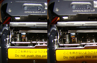

HVR-A1U Moisture Sensor
Originally Posted by John Lutz View Post
Can you possibly send a picture of the sensor and exactly where it is located? Thanks John Lutz
John,
I actually found this thread to solve the problem.
As Allister said:
"The sensor is a small square device that stands upright
and is on the rear left side of the cassette compartment."
Here's a before and after cleaning the sensor (picture attached).
Hope it's useful for you and the rest.
Cheers!
Juan M. Parra
Cinetech Productions
Juan Parra is offline   Reply With Quote

One interesting thing, however, is that all of my HC1's look like Juan's first pic. The dark square in the middle of the sensor on all of my cams is solid black like the first of the two pics. Wiping the sensor on both cameras a few times with a cotton swap moistened with isopropyl alcohol didn't make the black square less black where it would revelled the lighter detail under the black. Should I try a different cleaner? I wonder if this "black patch" is meant to be completely removed? All of my camcorders appear clean and dust free when inspecting inside the cassette compartment.
