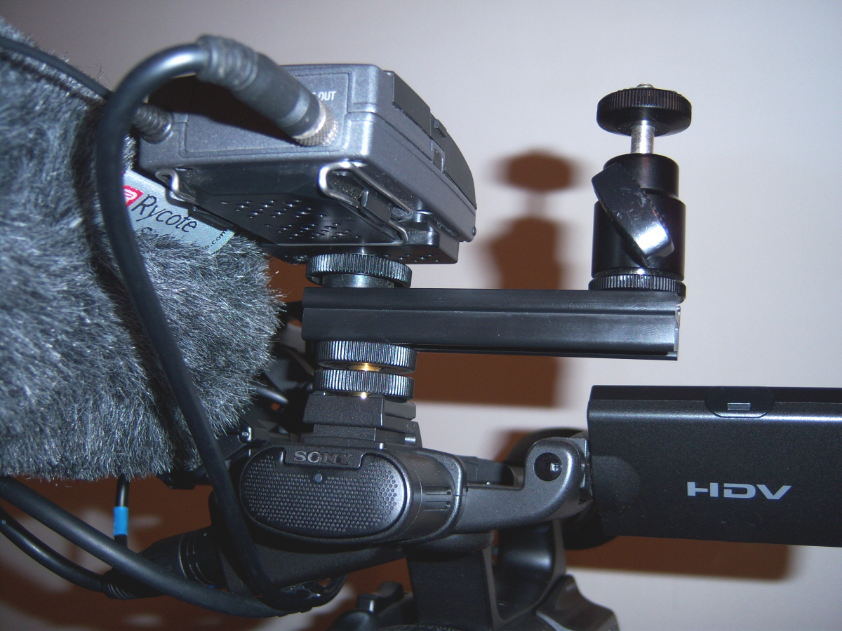

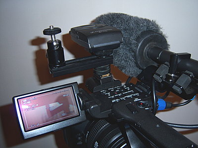

Posts: 793
Originally Posted by Colin Rowe View Post
Here is mine, set up for work with mic, radio receiver and Swit light. Very usefull addition to kit.
Colin
Holy cow, the mic is twice the size of the camera! =)
BTW, what adapter are you using to mount the Sennhieser wireless to the Rycote?
Michael
www.lvpvideo.com
Michael Liebergot is offline   Reply With Quote

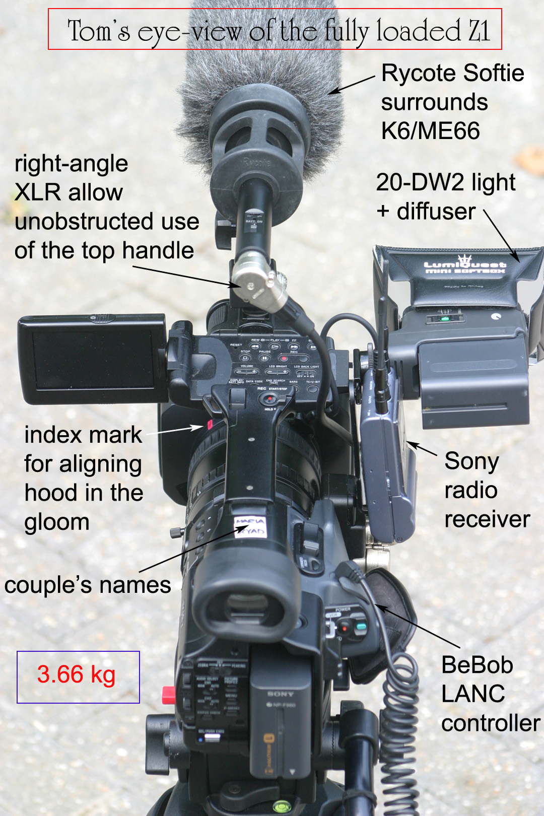

I've added a little shoe on my Z1 and here it is kitted up. I took off the Sony mic mount as I use the Rycote Softie's mount. This combo is ready for anything.
Rycote multimount, and Hama swivel shoe, to keep the Sennheiser receiver upright, in the same orientation as the transmittor
Colin
