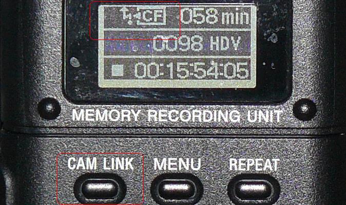

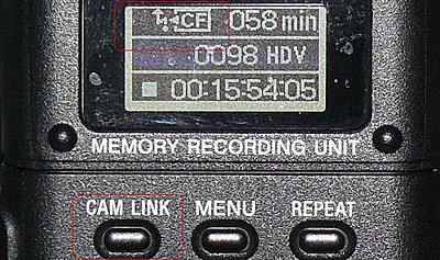

Hello Mike,
Is on the cardwriter the cam link right?
See picture, it must be in the position as on on the my jpg!
Dirk Pel is offline   Reply With Quote

Posts: 10
Dirk,
Thanks for taking the time to post the examples, etc.... OK, i tried it again in Ext Only mode and still not working. I made sure the cam link was correct just like in your example but the big (main) record button still does not start recording to the CF reader for some reason. Hummmm....
