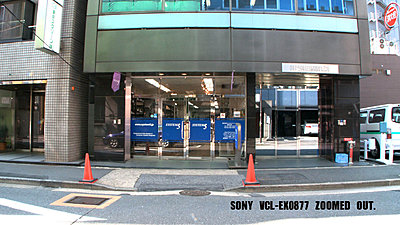

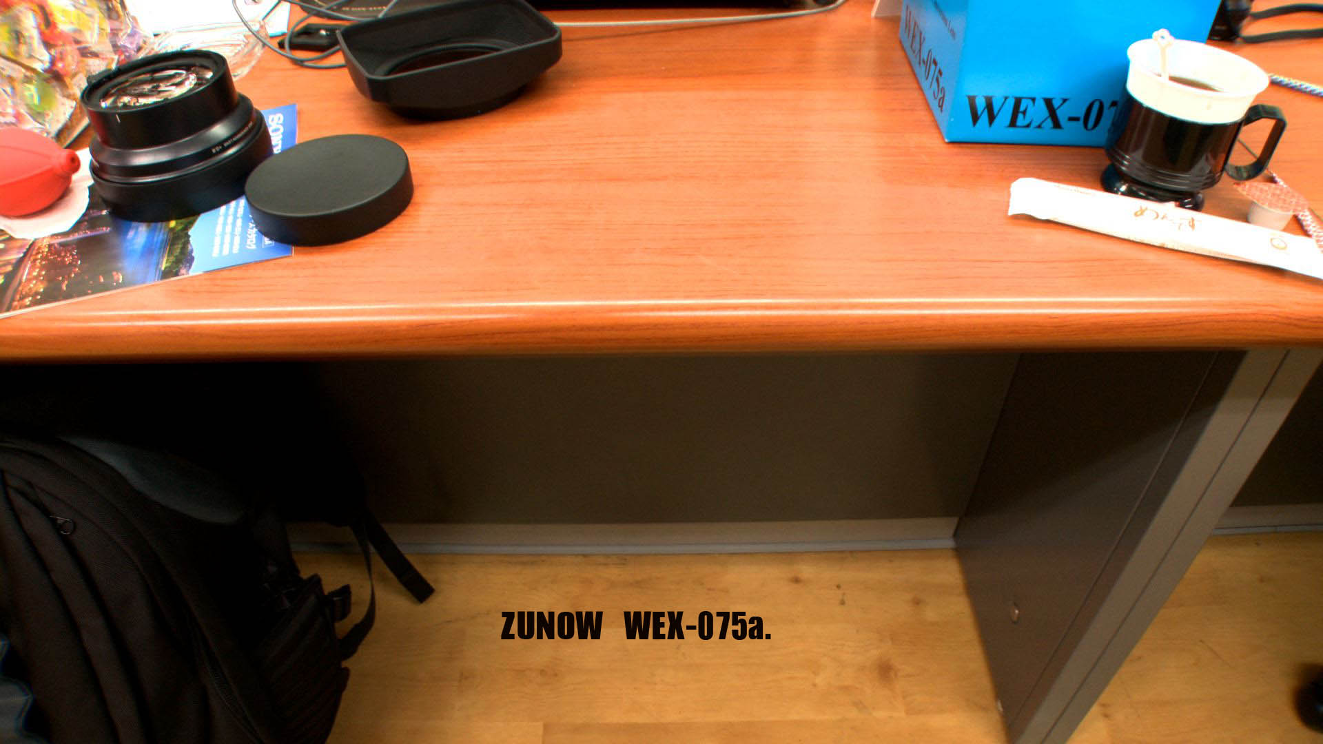

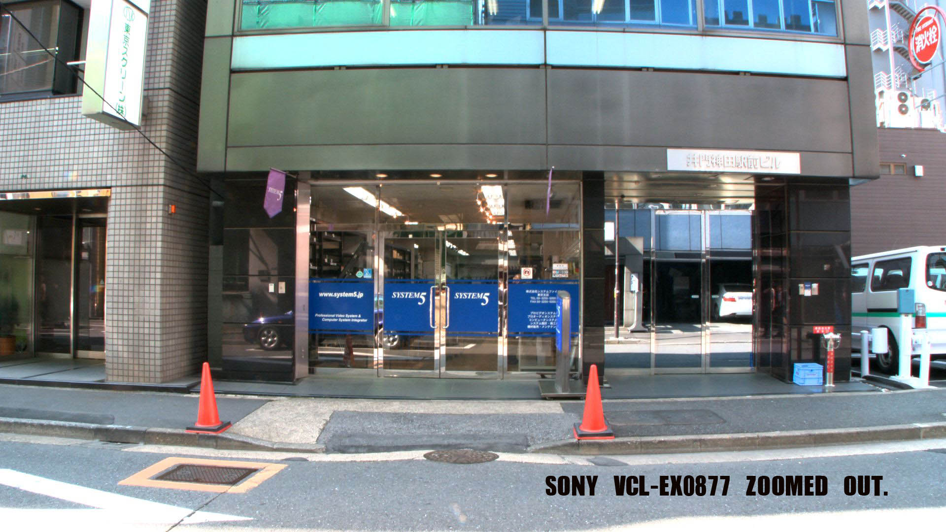

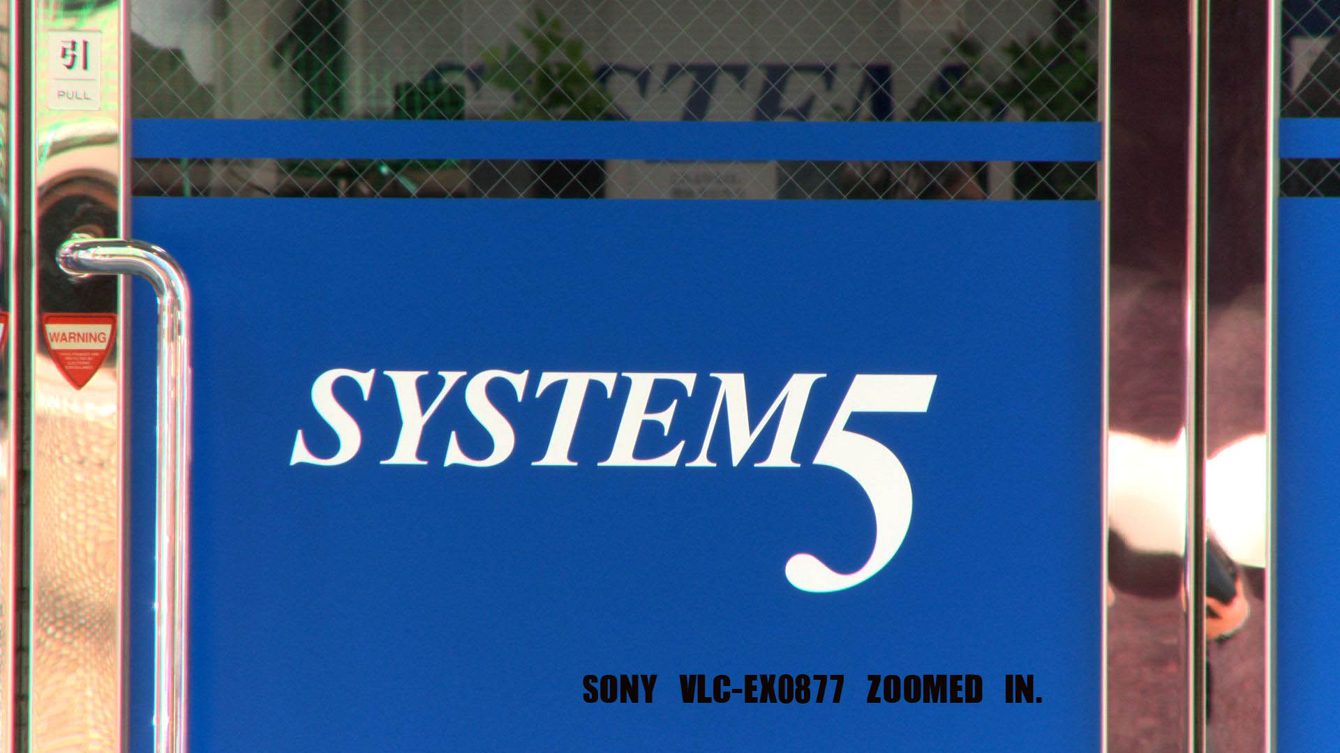

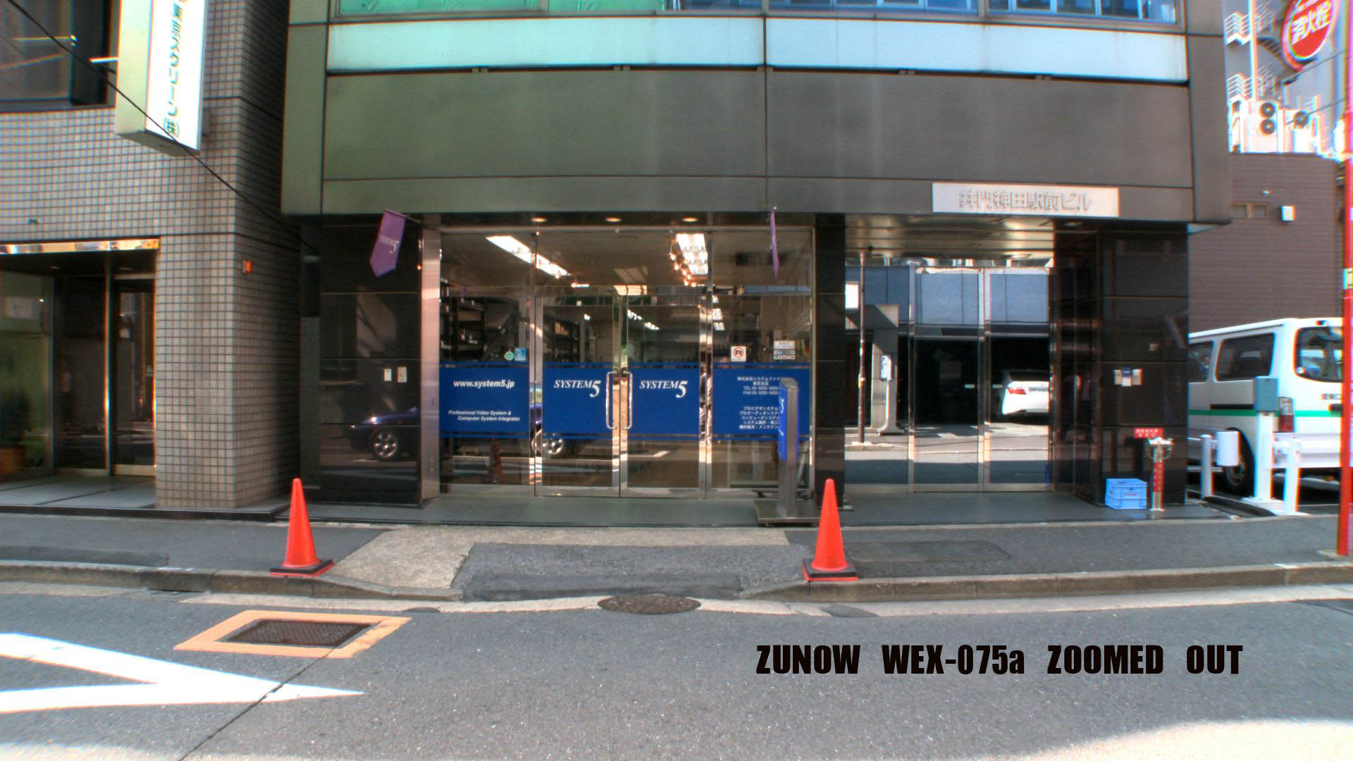

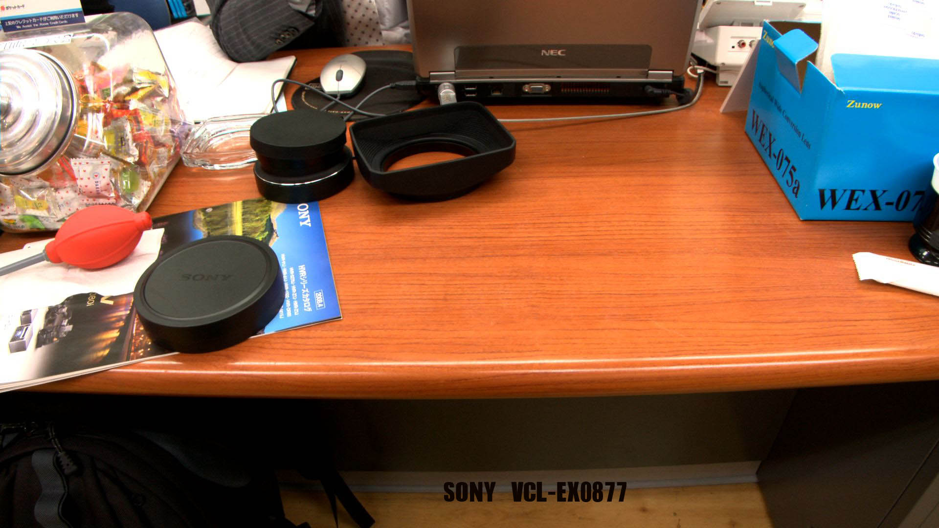

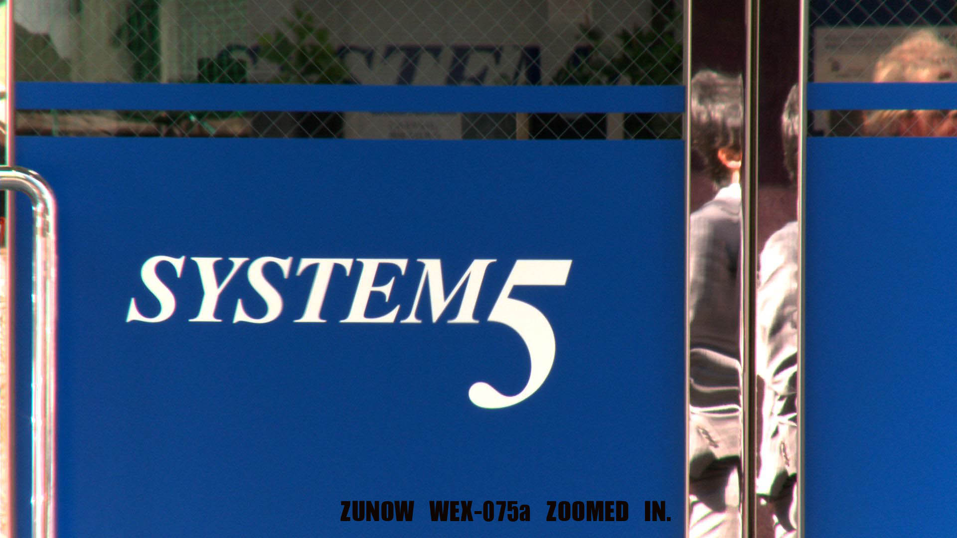

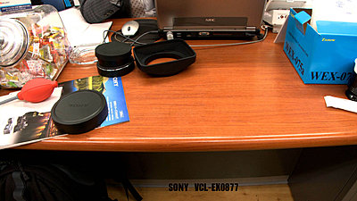

Zunow WEX-075a WIDE ANGLE LENS....
I got a chance to try out the new Zunow Wide Angle Lens here in Tokyo today. Who on earth are Zunow? Good question. They are a small Japanese Lens Maker who stiil hand make their lenses in Akita, Northern Japan. Its hard to get much information on them. They had a wide Angle for the Z1 that, although popular in Japan, seemed to get average reviews overseas.
I'm posting comparison shots with the Sony Wide Angle Adapter. I'm no pro user but here are my comments. Let me know if I left anything out. This Lens is nice piece.
My comments...
Noticeably less barrelling than the sony WA .
Its wider than the sony WA. Its 0.75. Sony's is 0.8.
It IS full zoom through just like the sony WA.
A removable hood unlike the sony WA permanently attached hood.
Heavier than the sony WA, around 830grams compared to the sony's 630grams.
It locks onto the front lens by putting it in position and turning a metal ring to lock position.
Very solid build. The hood is a hard rubber material.
It wont be available in the US until October.
It retails at 98,000 Yen here. That's about $900 US I think. I'm told it will be about 20% more when it hits the US market.
Seems like a better lens than the Sony WA but maybe hard to justify double the price for some people.
My local shop is trying to work something out for anyone wanting to buy one from outside Japan. If you are interested let me know. Otherwise you might try through your local dealer.
Cheers, Alex
EX1 wide angle and Telephoto lens-sony1.jpg   EX1 wide angle and Telephoto lens-zunow1.jpg
EX1 wide angle and Telephoto lens-sony2.jpg   EX1 wide angle and Telephoto lens-zunow2.jpg
EX1 wide angle and Telephoto lens-sony3.jpg   EX1 wide angle and Telephoto lens-zuno3.jpg

Yes, the Zunow does barrel distort a lot less than the Sony, but to say it sees wider than the Sony is pushing at microns. Still, I find Sony's barrel distortion quite unacceptable, so even theough the Zunow is a huge amount of money, it's the one I'd choose from this comarison.
Shooting into the light would test out the flare, though as both lenses are hooded and multi-coated I'd not expect to see much difference between them.

yeah, I agree, fractionally wider but the less barrelling is really its strong point. That and the fact you can add a matt box. I panned around and did shoot some shots directly towards the sun actually. Maybe I'll post some stills if any one is interested.
I don't mind the barrelling on the sony. I don't film brides and the Japanese are all so skinny anyway.

From the samples posted the Sony is a lot sharper than the Zunow, both at full wide and zoomed-in.
FYI, barrel distortion is hard to avoid at this price point. It's something I can live with for the shooting I'm doing.
If I really need to reduce or remove it, that can be done with the help of a filter in After Effects. You do lose parts of the image, however.

Dean, Im not sure if I moved the focus ring when changing adapters. The Zunow was the second one. Although I had peaking on all shots, Im not sure if I had it at max on the zunow. Having said that though, while moving the zunow around and focusing I did find it hard to see any peaking fully zoomed in o another shot aimed more toward the sun. I thought that might have been because I had to close the aperture a little. I wish I'd had more time with it to confirm.
