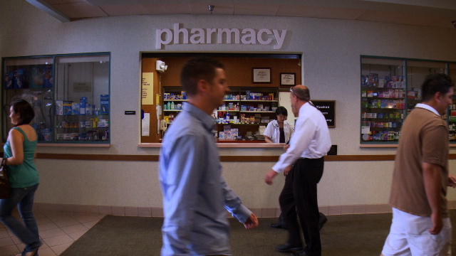

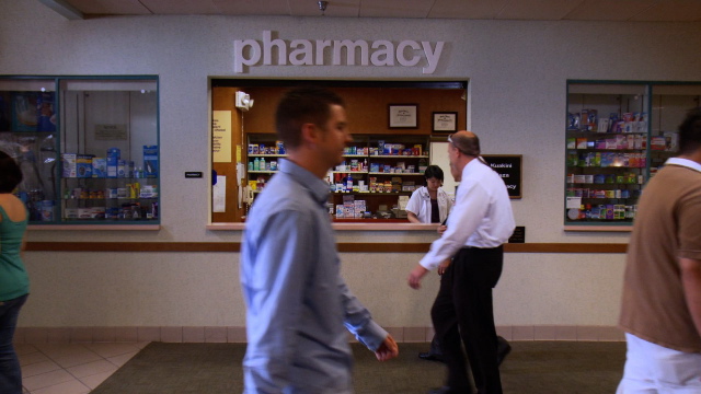

Regarding barrel distortion, it can be controlled with After Effects. Here's a before and after of a shot done with the Sony 0.8 WA lens.
Century Precision vs Sony VCL-EX0877-pharmacy-color.jpg   Century Precision vs Sony VCL-EX0877-pharmacy-undistorted.jpg
