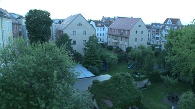

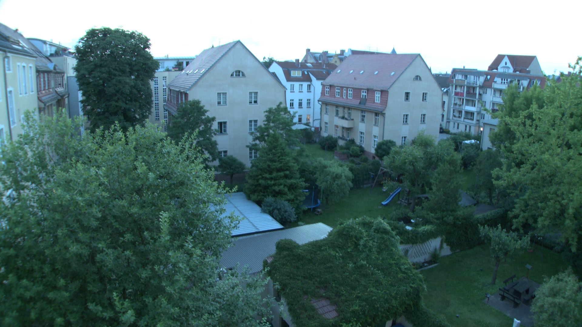

So, the 16x9 0.6 arrived - and I am fully disappointed. Just see the attached image. Although its anly a quick check (1080i at f2.4) with a wild background one can easily see, that the left side is much, much softer than the middle and even the right side is much better. That result can be reproduced on other scenes, with f4 or more - its always the same although its not that visible with more closed iris.
I received the 16x9 from a big seller, obviously heavily used before - so I assume it was ordered and tested several times before reaching me... and always was sent back.
The focus is simply not uniform. One can focus on the left side, then the middle an the right side is soft.
But there is only slight barrel distortion and no visible vingetting at Z0 - but it's unusable though.
I am not sure it this is some fundamental design problem of the 16:9 lense or if this piece I received is damaged/ununiform by chance. In any case it comes to late for the next important job...
Any comment is appreciated.

Hi Markus, I also do fireworks with the EX1 these days so "I feel
your pain."
The zoom lens in the EX1 is operating totally differently at Z99 than Z0 and you
just can't expect it to hold focus with a wide angle conversion lens.
The EX1's zoom lens was not designed to hold focus with the a-focal conversion
lens out front and it won't. At least, not well enough fireworks. In my experience,
fireworks have to be as in focus as possible to look right so you can't take shortcuts
like zoom in and refocus. Maybe if we were running at f/6 but not at f/1.9.
If you want fireworks that are as in focus as can be, you need to focus the camera
at the zoom position you want to run the camera at. For me, this means using the
expanded focus. Due to Petzval and astigmatism induced by the conversion lens,
not all of the field will be at the same focus even with a good converter. The aberrations
should be radially symmetric about the center of the image, that is, if the center of the
field is in focus that outside edges will be (invariably) way out of focus.
With a good conversion lens (century 0.6 non-zoom-through), you don't want to have any
extremes of out of focusness. This means trying to make the focus best in a region of
the image that is a ring around the center. You should be able to balance the aberrations
across the image by picking the mid-point between dead center and extreme edge and
making sure that is in focus.
It sounds like you have a bad conversion lens, though. You can get the left or the middle
or the right in focus. It isn't radially symmetric and this is not the aberration you would
expect from a system that is operating as well as it could given the circumstances. Th
16x9 glass might be tilted relative to the camera or the 16x9's optical axis is not the
same as the camera's optical axis. Or it could just be a bad lens. While the 16x9's may
be great for daylight filming, I am suspicious of them for fireworks.
I have had decent luck with the century 0.6x non-zoom through. I also have the century 0.45x
and although it is not as nice as the 0.6x, I can use it for some fireworks shots now and then.
You really don't want to go much below 0.6x. Every increment below about 0.7x and you
pay a heavy price in uncorrectable petzval/astigmatism with the non-zoom-through
converters. Even the zoom through converters can't fix much of it.
I have also had decent luck with the cavision converters (e.g. a 0.7 on an ex1) but I trust
the centurys for the extreme 0.6x and 0.45x. I haven't tried a cavision 0.6. Based on
the still image of the 16x9 you attached, I am reasonably certain you would have better
luck with the century 0.6x. Now you can't run the century at Z0, though. There is
a big of vignetting and I think you have to move to Z5 or Z8 to get full brightness across
the image.
The only way to get a truly nice wide angle is to go to an EX3 and put a
dedicated wide angle lens on it. I think the good fujinon is $13k USD though. I can't
afford the rental on that for the fireworks videos I work.
Dustin Moore is offline   Reply With Quote

The big seller did immediatly sent me a new 16x9 0.6x. Hopefully this time it is brand new, it will arrive next week already.
The 16x9 glass might be tilted relative to the camera or the 16x9's optical axis is not the same as the camera's optical axis.
The 16x9 fits well on the EX1R bajonett, but is movable a little for 1mm or so. It seems, that this mm is not responsible for the huge softness on the left side.
Could be my EX1R be a little "defect" (not perfect optical axis)? With my Sony VCL0877 0.8x there is a softness on the right side of the image. But it is much less so I can live with it, although I would like to avoid. I am somehow afraid that my EX1R has to be fixed instead of buying different adapters. Could this be: heavy softness on left side with 16x9 but moderate softness on the right side with the Sony VCL0877?
I do not zoom while recording fireworks. I film at Z0 only but use zoom in-focus-zoom out to get a safe focus in dawn or even darkness. Often it is impossible to be in position at daylight and wait till the display.
It seems, that the 16x9 is "sharp" (=same focus) from Z0 upto Z50! From Z53/54 it totally loses focus. I have to check how far the focus works in reality on 50'' TV when the new lense arrives.
So, the Century could be better for me?! The few comments at B&H led me to a different opinion:
http://www.bhphotovideo.com/c/product/544583-REG/Century_Precision_Optics_0HD_06WA_EX1_0HD_06WA_EX1_0_6x_Wide_Angle.html
16x9 Inc. 169-HDWA6X-EX EXII 0.6x Wide Angle Adapter
And zooming in to Z5 or Z8 takes more of the image. In the end it comes again a littler closer to the Sony VCL0877 0.8x. Mmmmhhh, I just would use it for huge, wide front displays. For all other displays and distances the 0.8x is good enough.
