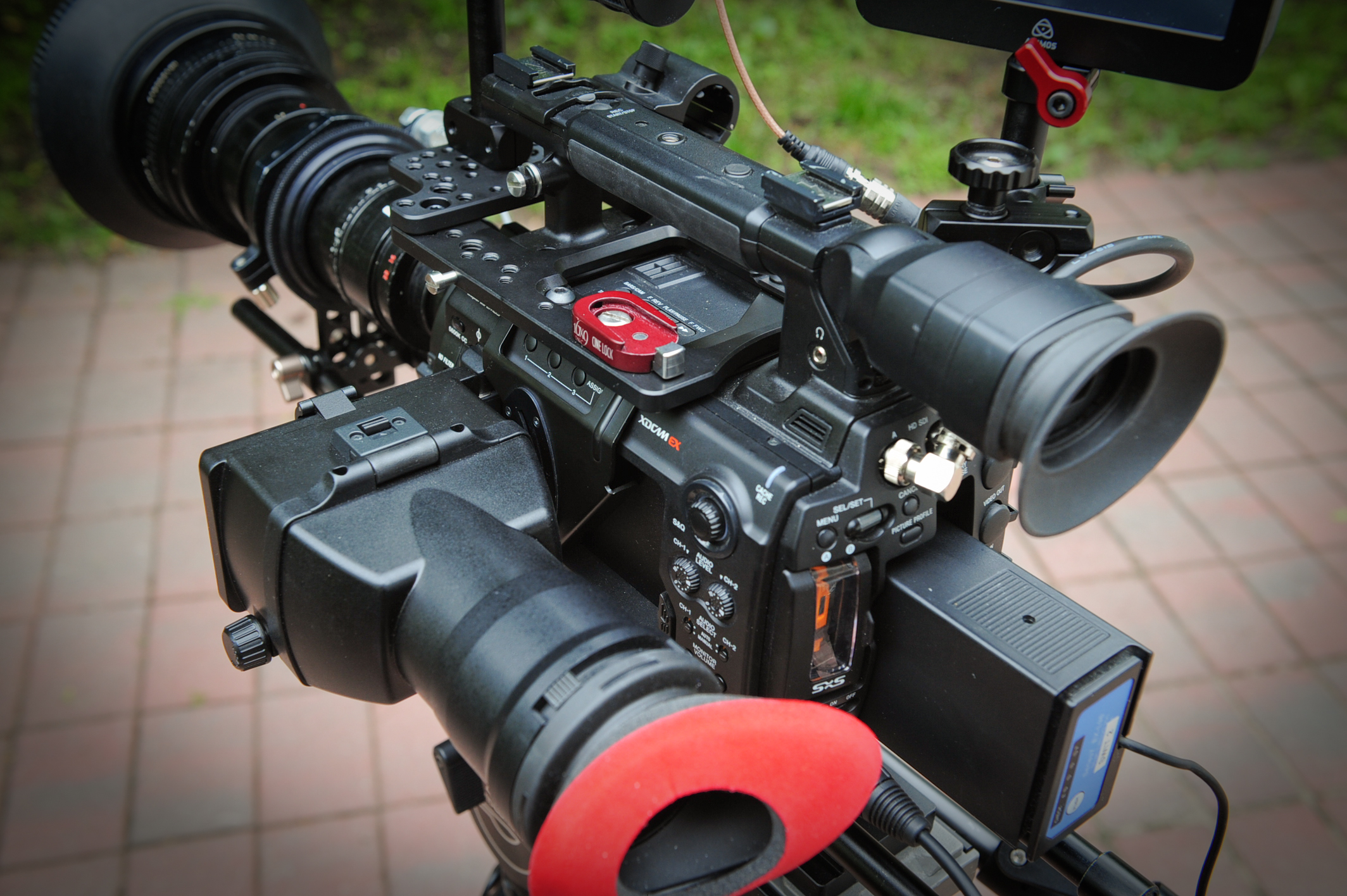

I've been using it for a couple of weeks now and I really like it. It's not perfect for every situation, but it certainly has simplified many setups. One less wire, battery and bracket and you know for sure that you're in record. Any advice on punching out the rivets would be appreciated as I too, use a Berkey plate

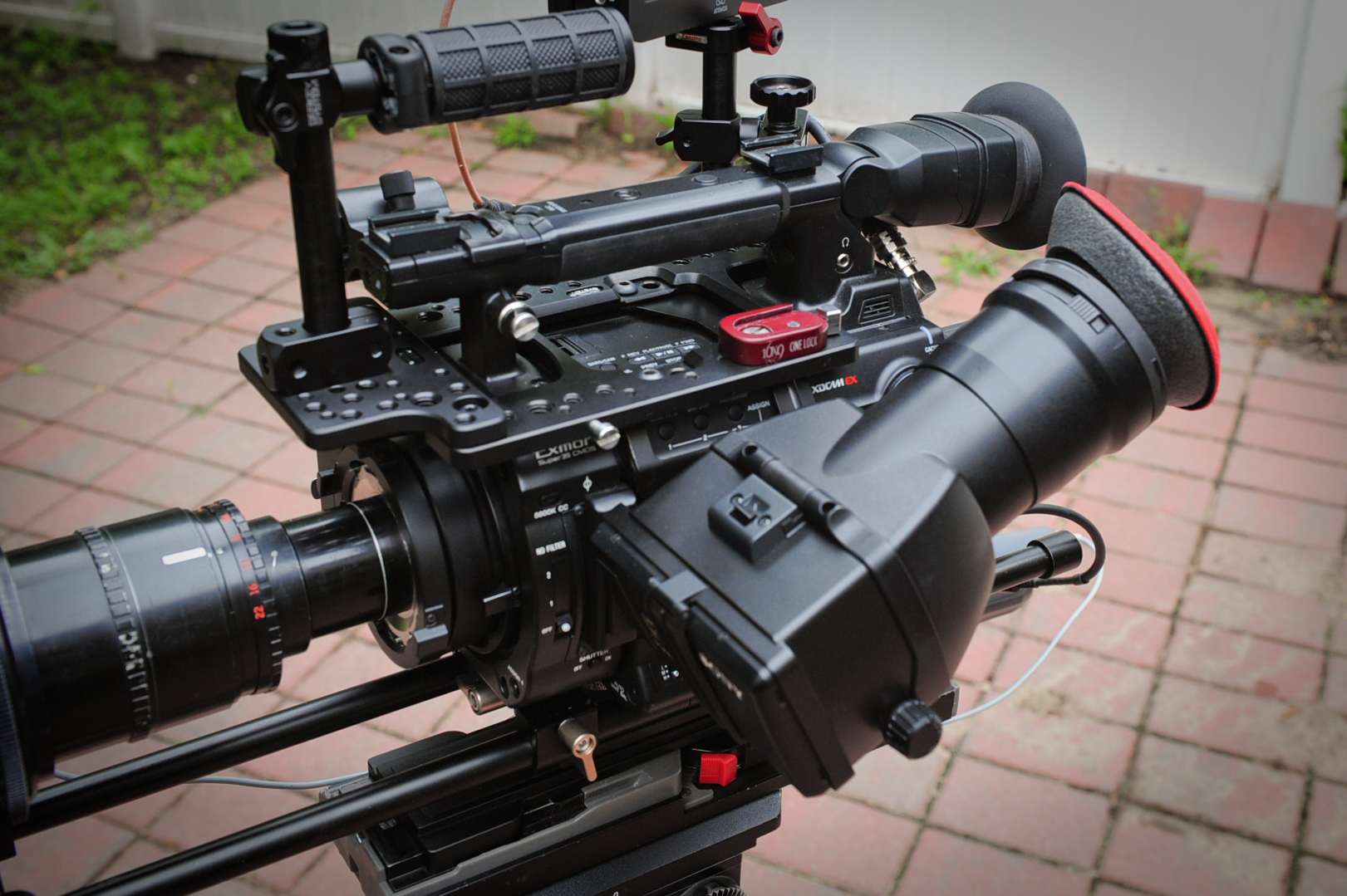

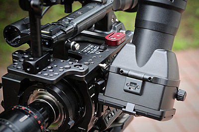

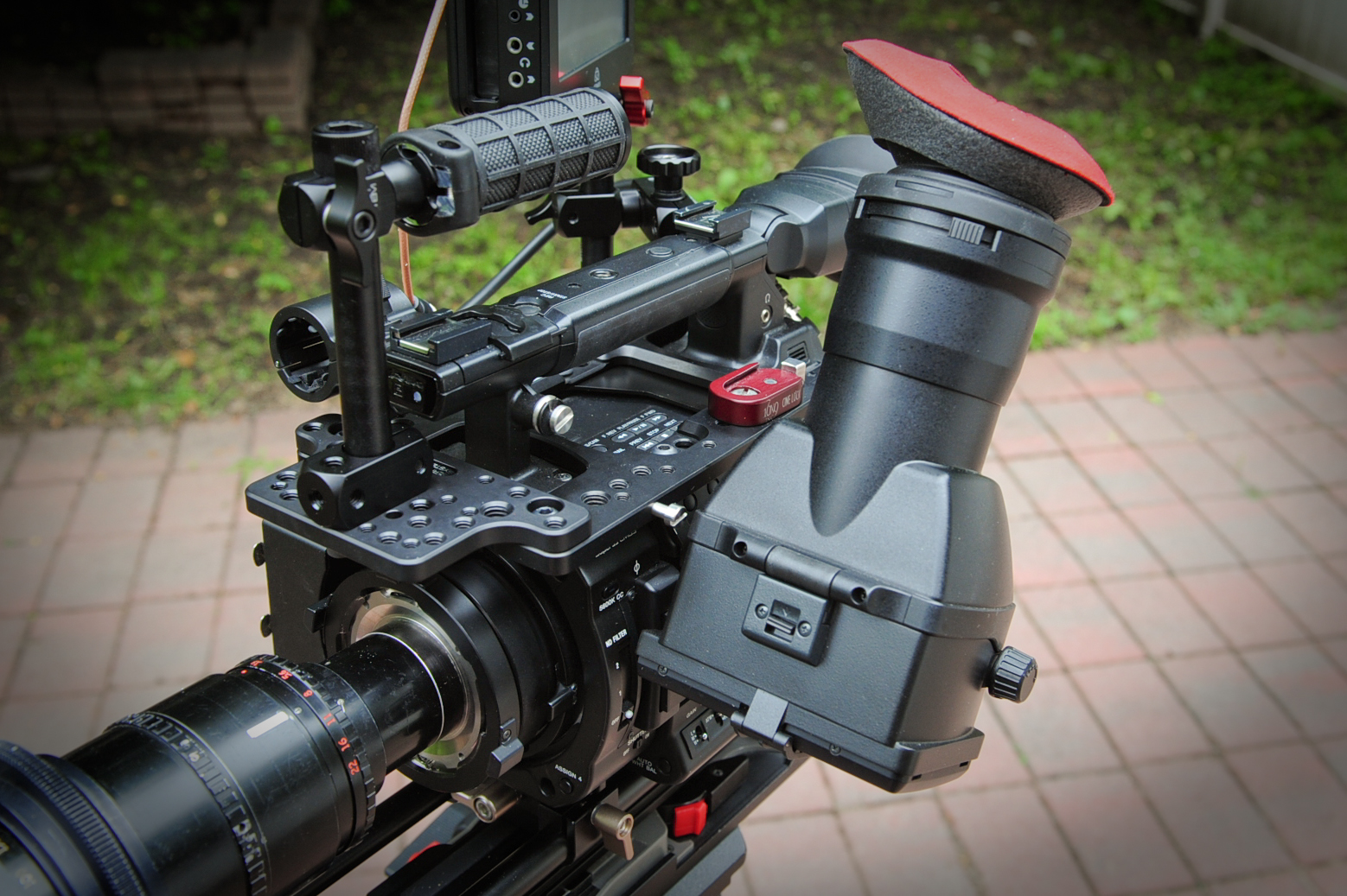

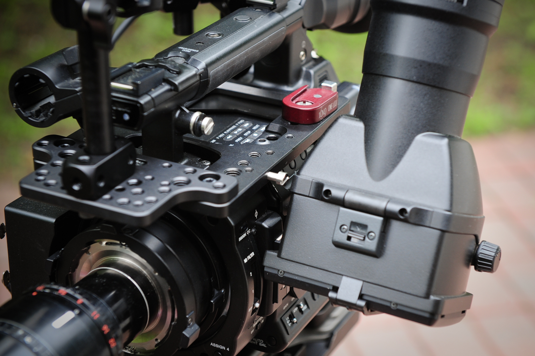

Here's some shots of the CBK-MH01, rivets removed, mounted under the Berkey cheeseplate.
Brian Berkey helped put together a basic handle that could also be swung forward if the lens and matte box mades the camera front heavy. You can also mount a monitor or anything else there when not in motion.
