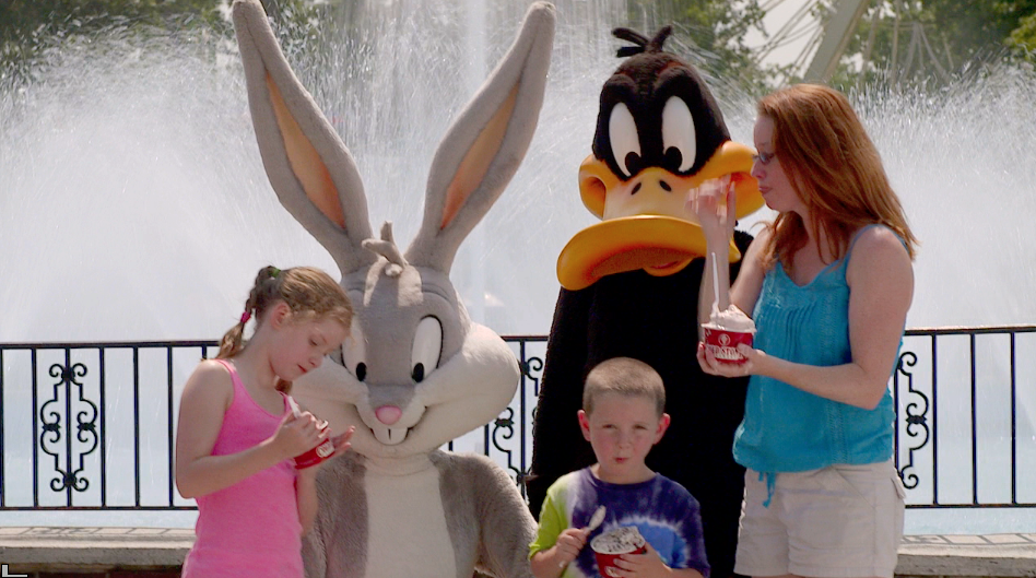

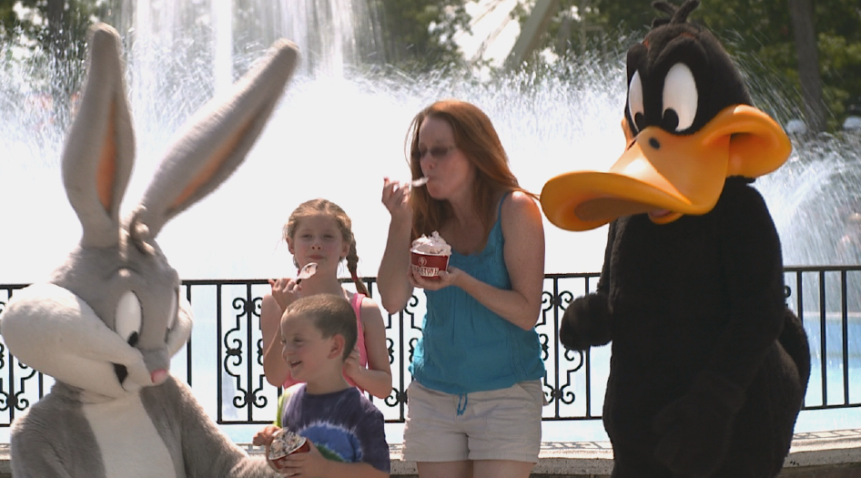

At first I thought that s-log would only benefit me on gigs that I could afford using a colorist, but I am finding uses for it on almost every project. Even though this is not the final color correction, I was delighted to be able to hold some detail in the fountain as compared to our usual REC 709 profiles. The 38% grey was quickly measured off a card using the camera's meter. Basic correction was done with Avid Medial Composer.

I've found Slog to be good for most any lighting situation even the most ordinary interior shots. You get a lot more latitude (of course) so you can easily punch up the blacks and have a lot of subtle graduation in the flesh tones and highlights.
If you are going to perform even a primary correction/grade then you should use Slog in my view.
Hitting 38% on the greycard makes it dirt simple and it works.

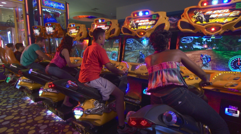

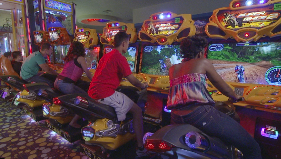

Here is another comparison using s-log and cinegamma 1. Color correction was done within Avid MC.
The first image being s-log. Note how the bright highlights on the machine are holding. It doesn't work for everything, but I'm finding that many common issues can be helped using log.
