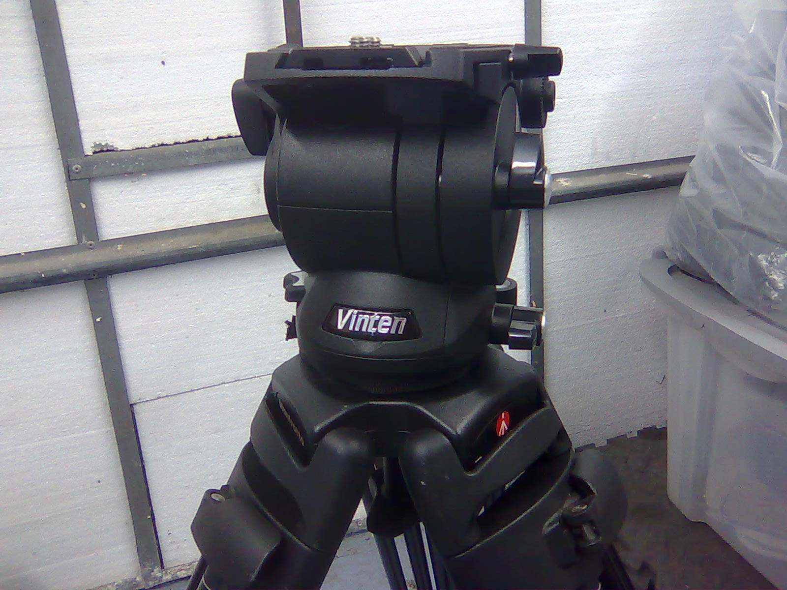

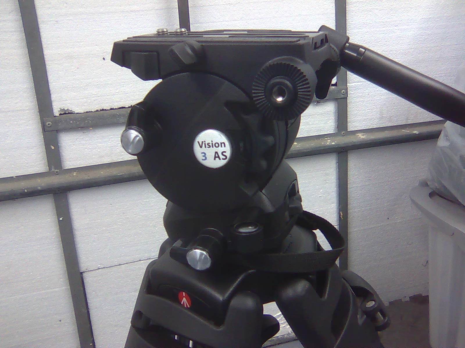

Vinten Vision 3as and manfrotto legs, it fits !!
I've just picked my Vinten vision 3as head, it fits my manfrotto 525 legs perfectly.
The legs still close, nowhere near fouling the locking shaft.
I haven't give the new head a proper roadtest yet but it'll get one this week, i'll post my findings, but i can already tell the difference between this and the old manfrotto 503hdv head.
In the meantime here's some pics of it on the manfrotto legs.
I paid £680 for the head.

Ok, i've had my EX1 on the head and the difference is massive, much better than the manfrotto 503hdv.
One thing though, the perfect balance, when i have the spring tension as soft as it can go and no damping, if i tilt the camera/head all the way forward or back the head tries to go back up to horizontal, not all the way, just about a third of the way back up, almost like the spring isn't completely slack or the EX1 isn't quite heavy enough.
I can almost cure it with a bit of damping.
Is this normal ?
Will the head wear in a bit ?
Or is it a camera COG thing ?
I tried a vision as3 at the IOV show last week, admittedly with a slightly heavier camera and i could easily and instantly find the "perfect balance"
Overall though i'm very happy with this head.

I'll be interested to see how you find the levelling adjustment of the 3 AS as compared to the Manfrotto head on the 525 legs, from my experience (with other Manfrotto sticks) it won't be anywhere near as good, tho' here's hoping.
Sort of had my doubts about an EX 1 on the 3 AS with respect to the PB system, think you may need to add a bit of ballast "up top" - wireless receiver in the flash mount, shotgun mic in the external mic holder etc to get it to properly kick in.
The true test with the 3 AS as compared to the 503 comes with full zoom, shed loads of drag to keep it under control, and a steady hand.
The limitations of the 525's withstanding, you should be able to pull of a flawless pan start, pan flow and pan stop with nary a hint of sticktion or pull back, tho' I bet those 525's wind up and down a tad too much to pull it off perfectly.

My 525 legs don't wind up much at all to be honest, i tried the vinten sticks which come with the 3as head, i put plenty of drag on and panned the head and they did wind up.
The levelling adjustment,, the collar on the vinten handle is just a couple of mm bigger than the manfrotto collar so there's not much difference, if the collar was a lot bigger then yes i could see how that would limit levelling capabilities.
Full zoom and panning, even without much drag is good, plenty better than the manfrotto.

V3AS and EX1, now perfect balance.
Ok, re my earlier post about the Vision 3AS head and the EX1 not balancing properly.
I emailed Vinten and informed them of the inability to "perfectly balance" the EX1 on the new 3AS head.
I had a very quick reply from Peter Harman from Vinten,( Peter had a hand in designing the head) he was not impressed that the head wouldn't balance with an EX1, he realises that a lot of EX1 owners could be looking at buying one of these heads.He said he had to get it sorted.
He also saw my post about not being able to balance the head/EX1, he informs me that they do watch these forums.
So, today Peter did a 5 hour round trip to my house and fixed my Vision 3AS head, when i say fixed i mean just a slight adjustment, (i can't go into much detail except to say it was to do with internal settings, not something an end user could do), the result is a head that does now perfectly balance with an EX1, with or without receivers, small battery or big battery.
Notes were taken by Peter and i'm pretty sure any more Vision 3AS heads are going to balance as they should.
