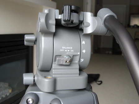

Head Libec LS-22: My first impression-img_6838.jpg
A very solid head. The side shells are made of hard plastic. The mounting and center piece is made of metal. I find the pan and tilt are much smoother than my 700RC2. There is no drag adjustment. With my DVX100A, I can balance it with the neutral balance setting (there are front heavy, neutral and back heavy settings). The head can maintain position if I tilt the camera (not more than +/- 10 degrees) and let my hand go. If I tilt more than 10 degrees and let go, the camera will bounce back slowly as expected. Pan is good as well. However, it does bounce back at the end of the pan. I did not experience any sudden loss of drag. Too bad that it does not come with a slide mounting plate. To adjust the positing of the camera on the quick mount, you need to disengage the QM from the head first. Libec LS-22: My first impression-img_6851.jpg

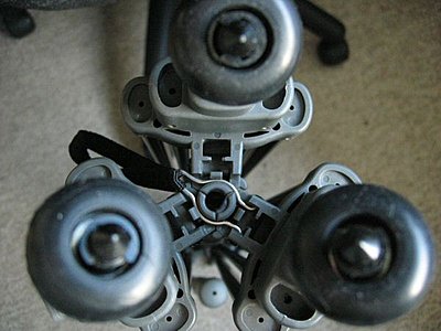

Leg Libec LS-22: My first impression-img_6849.jpg
It's single stage. Well built. I don't have a lot to say about the leg. However, I am not happy with the ground spreader. I have never use tripods with a ground spreader. I don't know whether the spreaders with other tripods are the same. However, I can say I hate it. First of all, the SP-1 is made of plastic. I always fear that I might break it when folding and unfolding. Furthermore, the hooks for the mid spreader do not perfectly line up with the slots on the ground spreader. Libec LS-22: My first impression-img_6845.jpg You need to extend the legs by 2cm at the final stage of folding. Otherwise, you will break the ground spreader! Libec LS-22: My first impression-img_6856.jpg This photo shows how the hook fits inside the slot when they properly line up. This photo shows the construction of the center of the spreaderLibec LS-22: My first impression-img_6857.jpg. Originally I was going to get the tripod with a mid-spreader for $50 more from Zotz. However, they would't take my Canadian credit card... too bad, my only option was B&H and their combo only comes with the ground spreader.

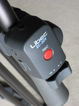

Remote control Libec LS-22: My first impression-img_6842.jpg
I am very happy with this remote. The rocker is smooth and there are two jacks for the cable. One on the top and another on the side.
Overall, I am happy with the set. For the price, nothing can beat it. BTW, the whole set is not 8lb. It is 10lb with spreader and remote control. I weighted it.

The legs are ultra-sturdy for me, and have had no problems, other than being a little light. (I just stand on the spreader, and I'm fine.) For me, this ground spreader is just like every other single ground spreader I've used, even on the big ol' Vinten I was carrying around as a loaner before I ordered this thing. I haven't had any problems with anything not lining up. My spreader works just as it should. About the non-fitting spreader, the mid-level clips don't match up on mine either, but there have been no adverse effects of not doing the "lower 2 cm" routine, I hadn't even noticed it until I looked for it on a shoot today after seeing your problems. Oh, and one other feature. On this tripod, I found that it had the same spring-loaded cord leg locking system that I had used on a Vinten. Very nice touch over the much more simple clips that are on other tripods. I personally have been using ground-level spreaders for a while though, and this one was a quite good one.

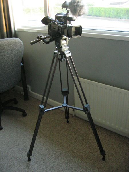

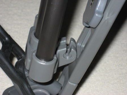

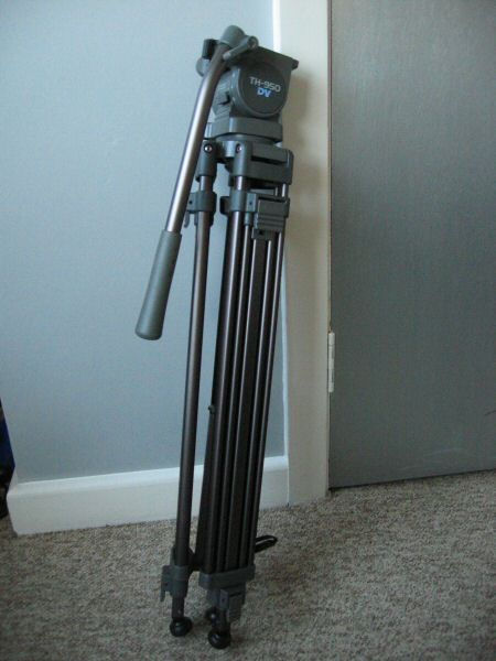

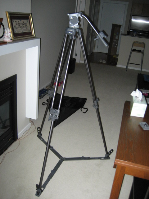

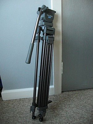

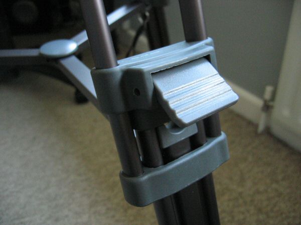

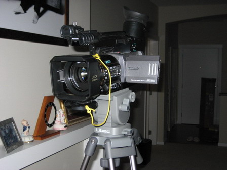

I've just taken delivery of a Libec TH-950DV, which is the LS22 head on a set of two-stage legs. I also have a Libec LS-37, the predecessor to the -38.
Buyer's remorse with the -37? A bit, yup. It's a rock solid tripod, the legs are great, but the head really isn't suited to my VX2100, the counterbalance is designed for heavier cameras.

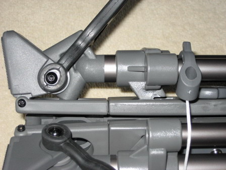

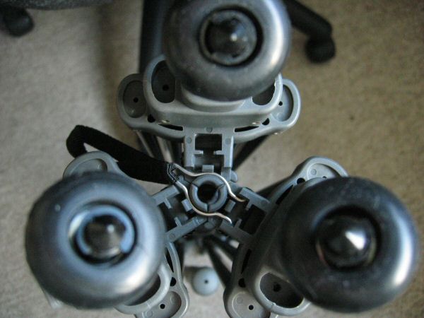

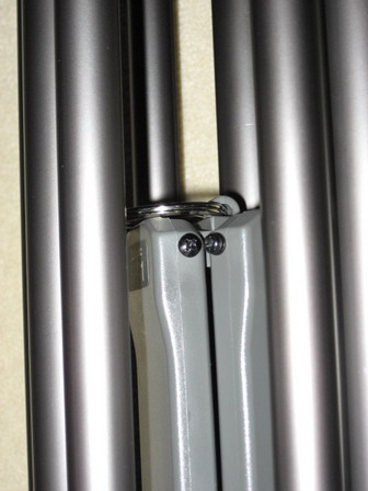

The TH-950 is a lovely piece of kit. It's lightweight, balances perfectly almost perfectly, and I really like the new quick-catch on the legs, where you just lift the tab and they fall down. There's a little catch at the bottom of the mid-level spreader to hold the legs together when you're carrying it, e.g. when it's slung over the sloulder.
The legs are a little lightweight, but nothing that can't be overcome if you use a light touch, which is all that's really needed.
Just for fun, I mounted the LS22 head on the LS37 legs to get a combination from heaven! The big hefty one-stage legs with ground-level spreader really are nice and solid. I have a feeling I will hang on to the -37 just for the legs, and use the 950's legs if I have to do a lot of walking with the camera gear.
My long term goal is to get a Vinten Vision 3 or similar, but at only UK £200 I don't really see how you can go wrong with the TH-950DV.
I've attached some pics showing the tripod with camera, the release tabs on the legs, the travel lock on the spreader and the tripod fully collapsed.

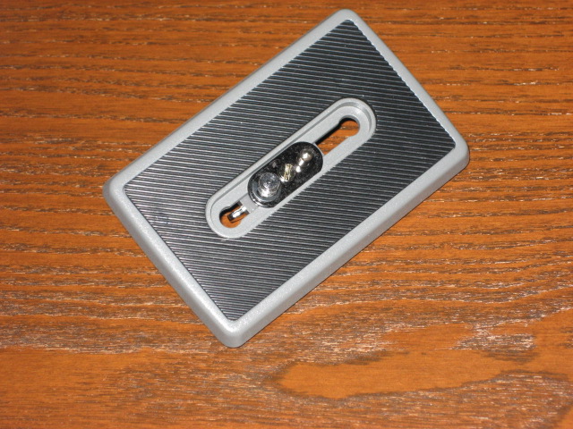

Tom, I've had a look at this (MN357). I'm thinking of getting one, but details are scarce (and there's no shops I can visit in this part of Ireland). Does this just mount onto the Libec quick release plate using the standard screw? It would be very useful to be able to balance more easily, especially when the camera is fully loaded with mic, Lanc controller and battery.

Yep, the sliding quick release has 1/4"x20 and 3/8"x16 holes on the bottom. You just use the 1/4"x20 screw from the Libec plate to line it up.

Just in case anyone's intersted, I took delivery of the Bogen/Manfrotto MN357 universal sliding plate yesterday and mounted it on the '22.
Sweeeet! With the VX2100 fully loaded (big battery, stereo mic, Lanc control, LCD sun-shade) it balances absolutely *beautifully*. The sliding plate cost me about £30 ($50-60ish) and makes mounting the cam and balancing so much easier.
I can balance perfectly at most angles. If I complete the pan or tilt and then remove my hand from the pan bar, the camera staus where it is without moving at all, and without having to lock off (though I would still do that if I was going to walk off and do something else). Absolutely brilliant considering the complete price.
