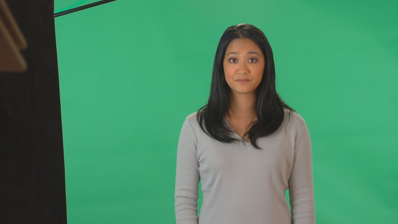

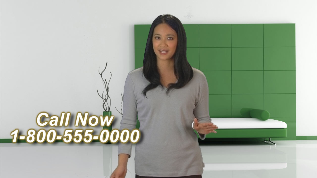

Btw, Here are two screen grabs...
One is m2t with no fx -- clean, the other has some graphics, a keyed in bg and a chroma filter.
.m2t format from SonyFX1000 back to .m2t losslessly?-fx.jpg   .m2t format from SonyFX1000 back to .m2t losslessly?-raw.jpg

Originally Posted by Brian Luce View Post
You should be able to render to m2t just fine. Look for "Main Concept MPEG 2".
Yes, you can quite clearly see the re-compression artifacts.
