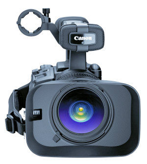

Q   What's that thing next to the lens? It looks like a video light.
A   The thing on the right side of the lens that looks like it might be a video light, is actually the eye of a passive IR sensor which is part of the "Instant AF" fast autofocus function. This device quickly measures large-scale changes in distance and contrast, and hands the results to a separate fine-scale AF processor for fast, precise tuning of autofocus. There's a cutaway in the XH camera lens hood to accomodate the eye of the sensor. Instant AF can be switched on or off in the camera's menu system.
