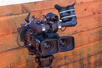

Yes that thread is VERY VERY old (circa 2005) from when I built my first side-by-side rig for the HD100 cameras. I see there are a bunch of posts in there that I haven't answered. I've come a long way since then and I'm currently working on a beamsplitter design for the HM100 cameras.
If you visited the 3D area at JVC's booth or Cineform's Neo3D demo you may have seen some of my recent 3D footage. You can download it here. http://www.timdashwood.com/.Movies/D...SideBySide.zip
The closest interaxial distance I could physically get the HD100 cameras in parallel (after disassembling a 16x5.5 lens and the viewfinder) was around 120mm. That works fine for landscape shots, but is not ideal for dramatic production.
I didn't actually get to visit P+S while I was at NAB (because I'm already familiar with their rigs) but I did visit Element Technika, Cineform/SI, & Binocle (angeniux booth).
The HD cameras could be arranged to fit in most of these beamsplitter rigs but they would be huge. That's why you usually only see the CCD block (in the case of SI and Sony F950) and recording systems are tethered.
