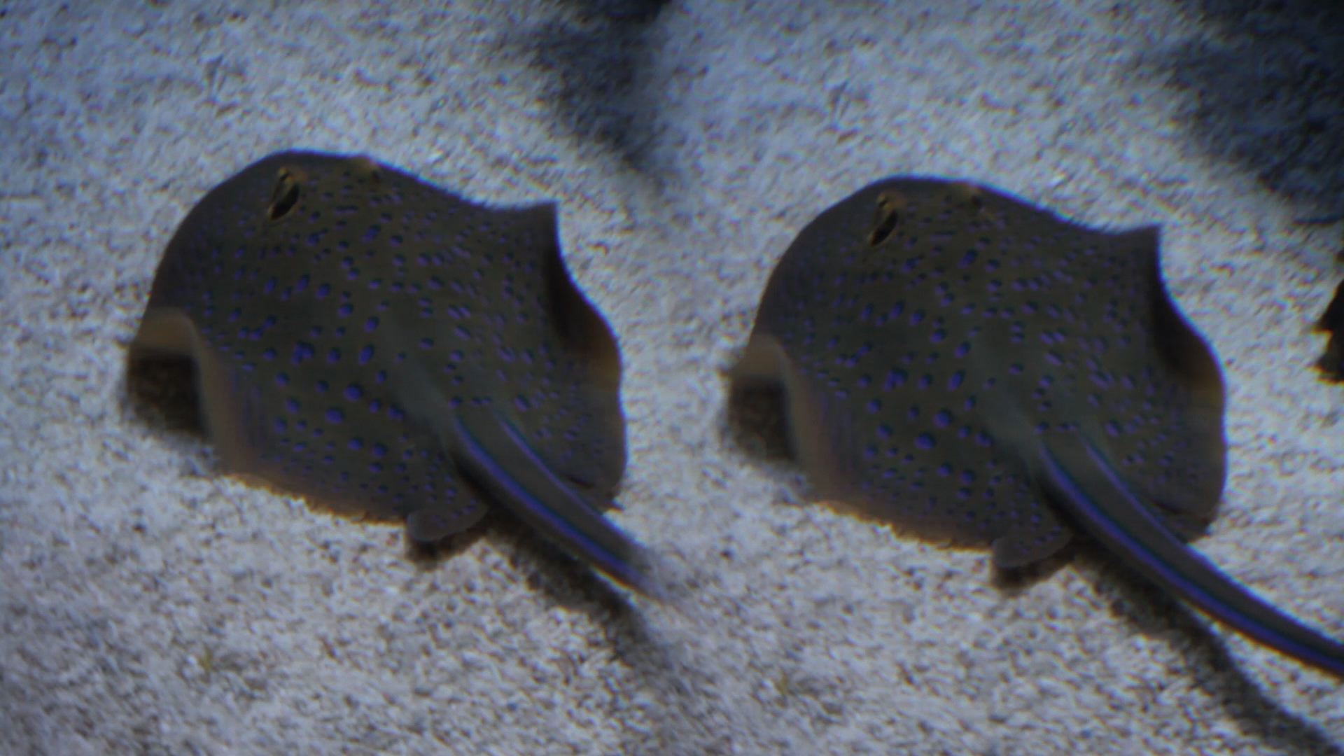

I've been fooling around a lot with this Loreo 3D Lens-In-A-Cap unit on my Canon 7D. I went to the aquarium the other day and shot some footage of fish in the tanks. What you get is a divided picture at full 1920x1080 res, kind of like what a side-by-side 3D display image comes out as, but with a less distinct middle of the frame delineation.
Anyone have any experience with these types of 3D images in regards to displaying them on a 3D HDTV or converting them to any other display format?
The shot I've attached is a 1920x1080 still frame if anyone want to experiment with it.

Not only do I have experience with Loreo, my Loreo footage was the original reason why I wrote the Bororo 3D plug-in for Sony Vegas. It was with my Loreo lens that I shot this video and with the Bororo 3D plug-in that I made it into a displayable video.

I don't believe I have ever gotten to describing that particular method, so here it is.
Put your video on the timeline. Go to the FX tab and select Bororo 3D Horizontal Adjustment. Drag the "vertical line" preset on the video. A vertical line will appear. Change the value of "Offset in Pixels" to find the dividing line between your left and right views (at least with my 35 mm adapter, it is never in the middle). Once satisfied, uncheck the "Vertical Line" checkbox and select the output method at the right end of the dialog. You can still change the value of the "Offset in Pixels" to refine it.

Bruce, I had one of the early Loreo 3D gadgets which was OK for prints etc using their viewer but the optics were poor and I sent it back to them. The new version looks improved.
The impediment to getting your material on to a 3DTV seems to be the lack of a box to send each half image to a shuttering 3DTV. I imagine you'd be content to live with the loss of resolution inherent in that system and to a vertical half frame.
Those considerations are why we didn't pursue the Loreo device for video..
