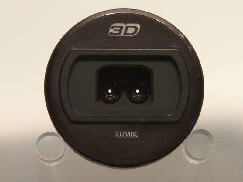

This latest document from Panasonic now suggests that the conversion lens IS anamorphic after all.
HDC-SDT750 | HD Camcorder | Panasonic Global
Old July 31st, 2010, 04:44 PM   #21
Join Date: Oct 2004
Location: Munich Germany
Posts: 34
The document specifies the recording/encoding format (960*1080) not the acquisition format. Look at the 3D lens alignment process shown here (sorry in Japanese):
http://magazine.kakaku.com/mag/camera/id=246/.
I have the strong feeling there is not much communication between PANASONICs product development and marketing division. Hopefully Photokina will reveal the truth about this mystery camcorder.
Heinz Bihlmeir is offline   Reply With Quote
Old July 31st, 2010, 06:25 PM   #22
Location: Toronto, ON, Canada
Posts: 3,637
Now that I have seen this pic on that Japanese site I will concede that the lenses are not anamorphic. The aperture is perfectly round. When you look down anamorphic lenses the aperture looks oval.
This is really illogical and unfortunate to only capture 960x540 area per eye but I suppose it is also to be expected from the consumer division. I assume these inexpensive consumer "toys" need to be handicapped in some way so they don't cannibalize "professional" sales for the AG-3DA1.
Panasonic Consumer 3D camera and Micro4/3" 3D Lens-event46_img22l.jpg
