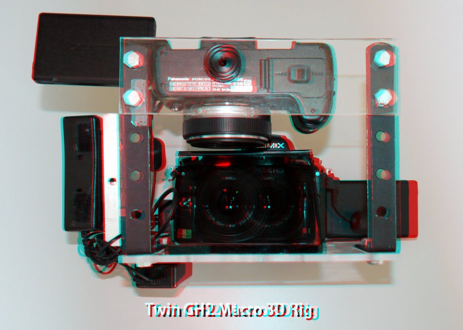

Re: Looking for a 3D camera
Something like this is handy for macro/closeups.
Looking for a 3D camera-523975_412893458723125_100000074242945_1652370_1521678909_n.jpg
