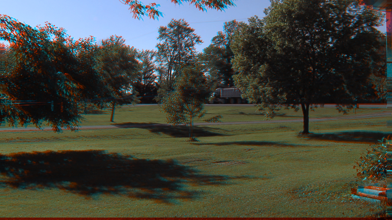

HD100 in 3D... grab your red/blue anaglyph glasses!-hd100-3d-test-1.jpg   HD100 in 3D... grab your red/blue anaglyph glasses!-hd100-3d-test-2.jpg
HD100 in 3D... grab your red/blue anaglyph glasses!-hd100-3d-test-3.jpg   HD100 in 3D... grab your red/blue anaglyph glasses!-hd100-3d-test-4.jpg
HD100 in 3D... grab your red/blue anaglyph glasses!-hd100-3d-test-5.jpg   HD100 in 3D... grab your red/blue anaglyph glasses!-hd100-3d-test-6.jpg
