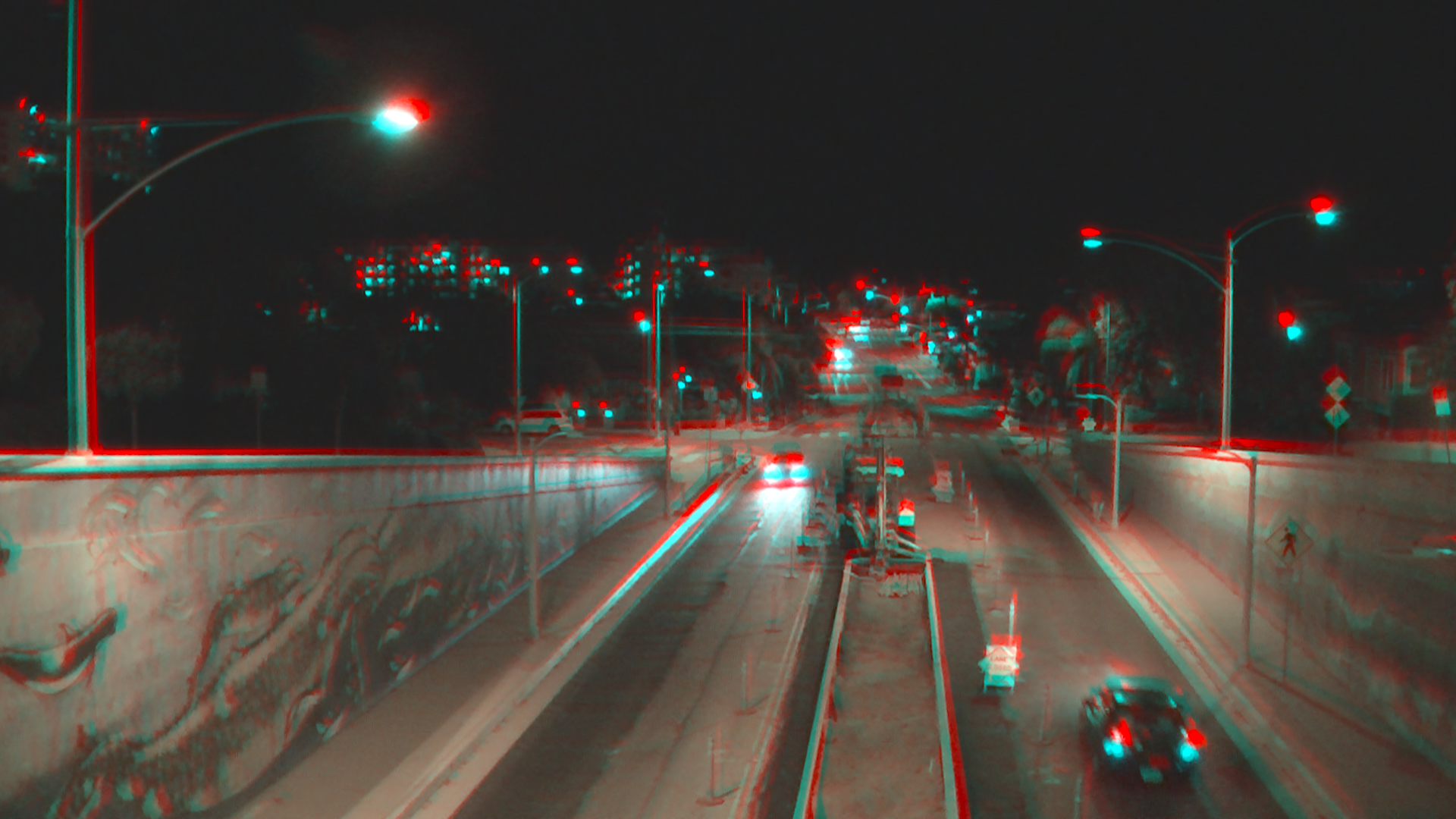

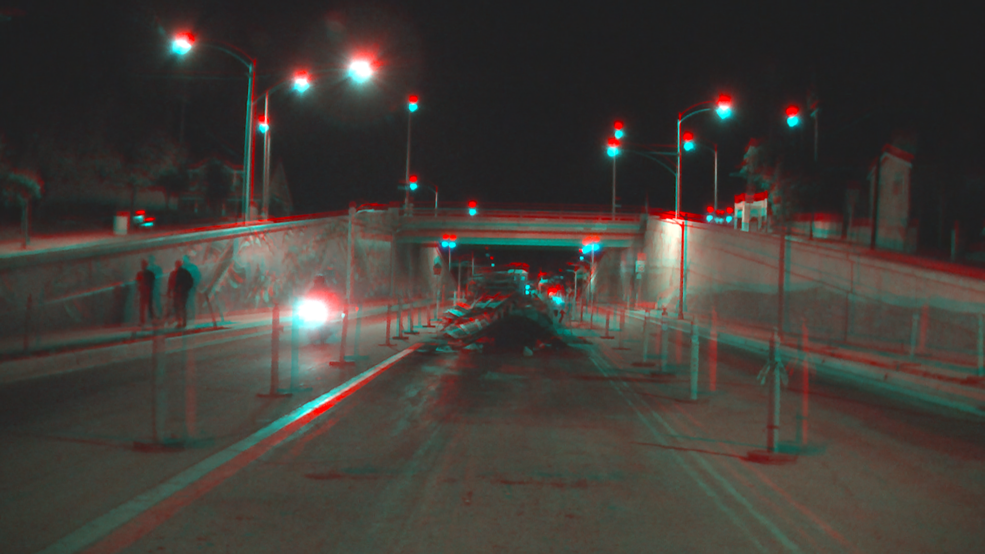

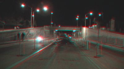

I do so love my new SbS rig, but already, I'm hungry for an IA greater than 10".
Sure, 10" comes with limitations. I can't have anything closer than 10' to camera, and really shouldn't have anything closer than 20', especially if the far depth is much greater (these are just estimates, based upon my limited experience).
But I'm hungry to shoot architecture, which is one of the 3D subjects my eye is always caught by, but which low IA seems to do nothing for. Also, I'm eager to get up into the Hollywood Hills, and shoot L.A. with a very wide IA, possibly several feet apart. My cameras each have 40X zooms, and I can't wait to try very long lenses with very wide IAs.
The following images were both shot with an IA of 10" (all my current tests are playing with the extreme, and seeing what I can get away with). Both real-world views look delicious to my eye, but only the ground-level camera shot seems to have the deep depth that I'm looking for. The view from the bridge is nice, but it needs a bit wider IA to really make the red cones, etc. really jump out (it's a bit hard to tell from the thumbnails).
So I'm curious to see what y'all use. I've only been able to google one stereoscopic bar with 20+" of separation, and it's almost $900! Presumably there are some good DIY methods out there, using some kind of sliding door frame or something. I'd really like to try out IAs of 6 feet, or so.
My first Side-by-Side rig-red-cone-zone-01.png   My first Side-by-Side rig-red-cone-zone-02.png
