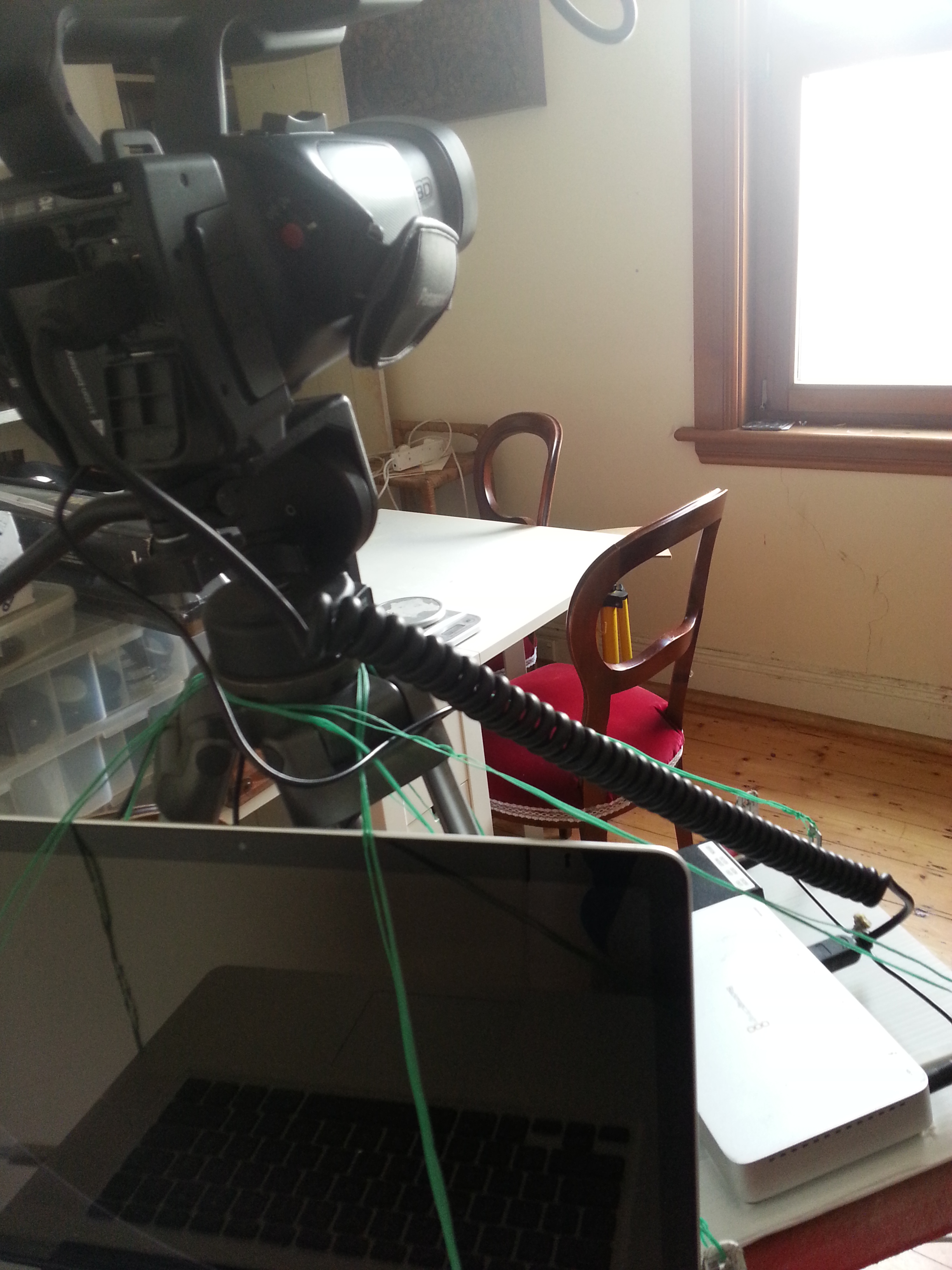

This can output frame-packed 1080p on HDMI 1.4 - this can be captured via Ultrastudio 3D and a MBP with Thunderbolt. More details on the entire rig here.
https://plus.google.com/photos/11733...83342812092193
This includes power supply solution, and DIY LANC remote.
I highly recommend the Cyclopital3D filter attachment for the Z10000.

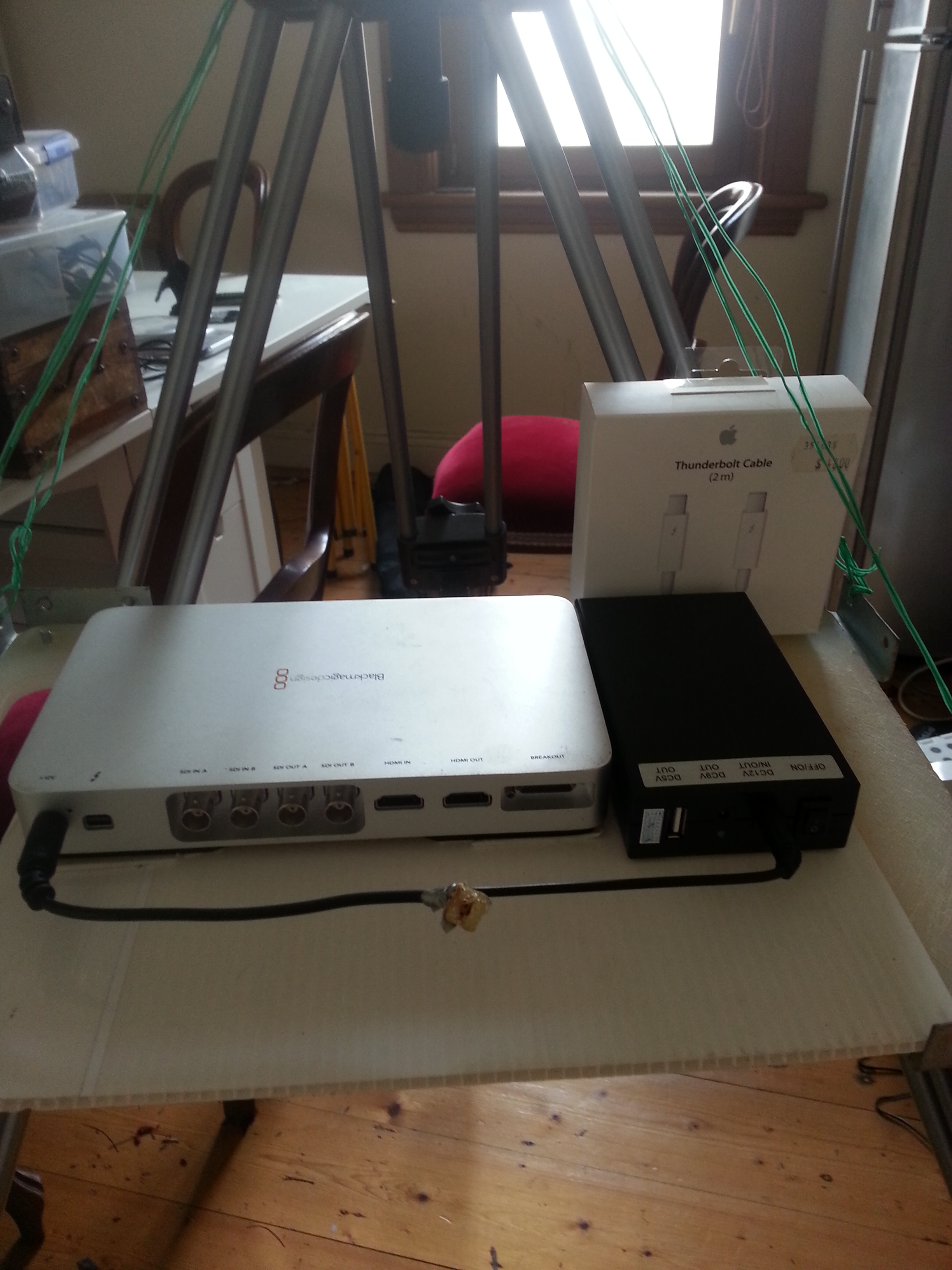

a. LANC Remote - Modded the wireless remote and attached the IR led in front of the IR receptor. Used an old mp3 jogging pouch as tripod pouch.
b. DIY rig for using Ultrastudio 3D in the field - battery, cables and tripod platform mods.
c. MBP modded with DVD-BD replaced by second SSD for capture.
