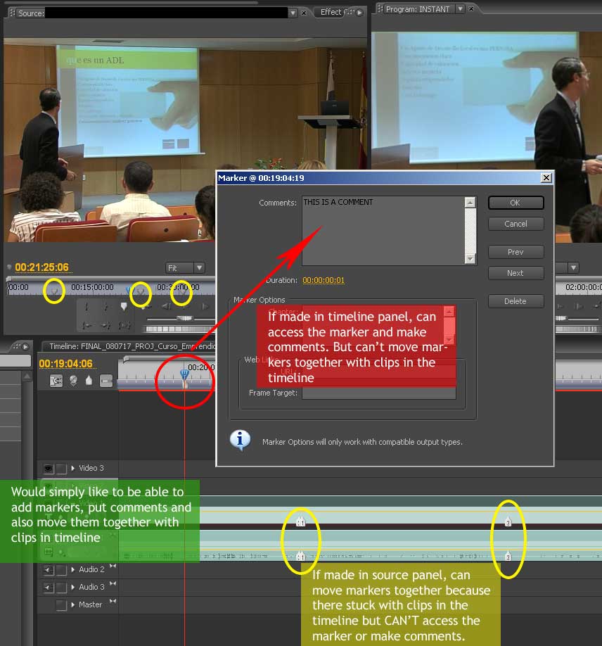

Old August 22nd, 2008, 02:53 AM   #10
Location: Spain
Posts: 185
Hello,
To make things a little more clear I've made a screen shot with detail with whats the problem right now with one of the possible solutions.
What do you think?
CS3 How to move markers together with video clips in timeline?-marker-problem.jpg
Jose Milan is offline   Reply With Quote

Originally Posted by Jose Milan View Post
Hello,
What do you think?
Hi Jose,
It would seem to me that you would want to keep the sequence as it is.
Why would you want to change it? Put the content you want in another sequence. You can easily update your markers with information as you wish in the original sequence as it will update in the subsequent sequence.
The final show will update with the nested sequences so all the content will be where it needs to be. There doesn't seem to be any downside to leaving the sequence where it is and using it as a nested sequence.
Mike
Mike Gunter
VideoTidbits.com
Mike Gunter is offline   Reply With Quote
