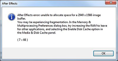

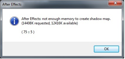

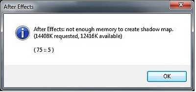

Old October 9th, 2009, 12:24 PM   #18
Join Date: Jul 2007
Location: Landshut, Germany
Posts: 143
not with motion blur enabled... :(

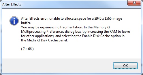

Old October 9th, 2009, 01:06 PM   #20
Join Date: Jul 2007
Posts: 143
yep i agree on that. but what really makes me wonder is why i was able to render that project even with my old rig (4gig ram). I've now tried to render it without motion blur but get another error :(
maybe my settings are totally wrong? Could you advise on that?
Thanks so much!

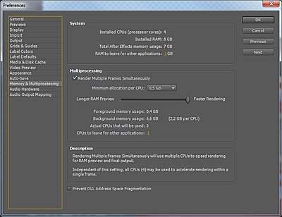

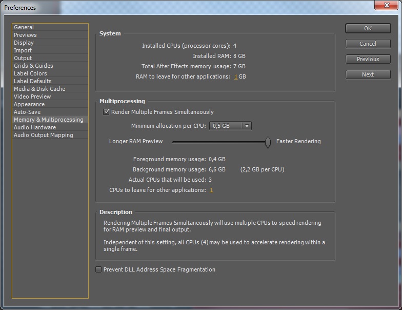

Old October 9th, 2009, 01:56 PM   #23
Join Date: Jul 2007
Posts: 143
its a standard 1920x1080 project - and basically is a remake of this tutorial:
VIDEO COPILOT | After Effects Tutorials & Post Production Tools
nothing too fancy.
i've been working with CS4/windows 7 since it's first beta, I've used the Project template last week and it worked fine. Then it suddenly stopped working. Then I've reinstalled my OS but still no luck :(
i've attached my AE ram settings.
Little summation:
- works if I disable motion Blur and Render within Premiere
- does not render at all in AE (either the 'not enough memory for shadow map' or 'unable to allocate space for buffer' error)
I hope you guys have an idea...
*looking really sad at my deadline*

Old October 9th, 2009, 04:21 PM   #26
Location: monroe, or
Posts: 572
Daniel... have you installed the latest AE updates?
One process I have done, and it's tedious depending on the complexity of your project, is to switch on layers with each render to see if there is one element that has gotten corrupted or its effect is causing a hangup.
Have you attempted dedicating LESS RAM for AE? What about unchecking the render of multiple frames simultaneously?
This is a stab in the dark, but is AE's render queue a SEPARATE operation? Are you maybe choking render queue of RAM by allocating all but 1gb to AE?
It's strange that Premiere can handle the render (albeit with motion blur off), and AE can't. That seems to speak to the installation of AE, or a needed update.
I'm certainly not a qualified Adobe troubleshooter.
Marty Baggen is offline   Reply With Quote
