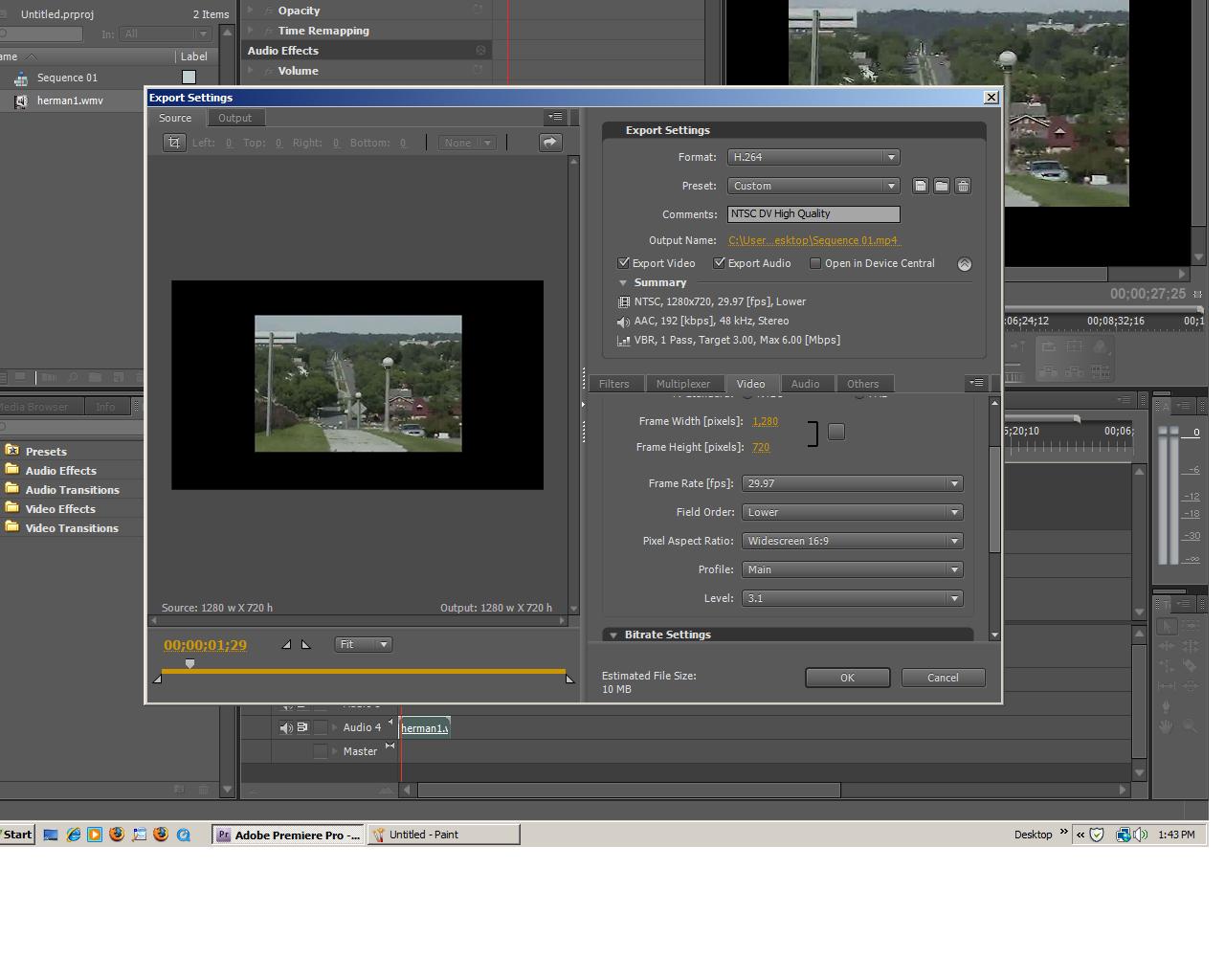

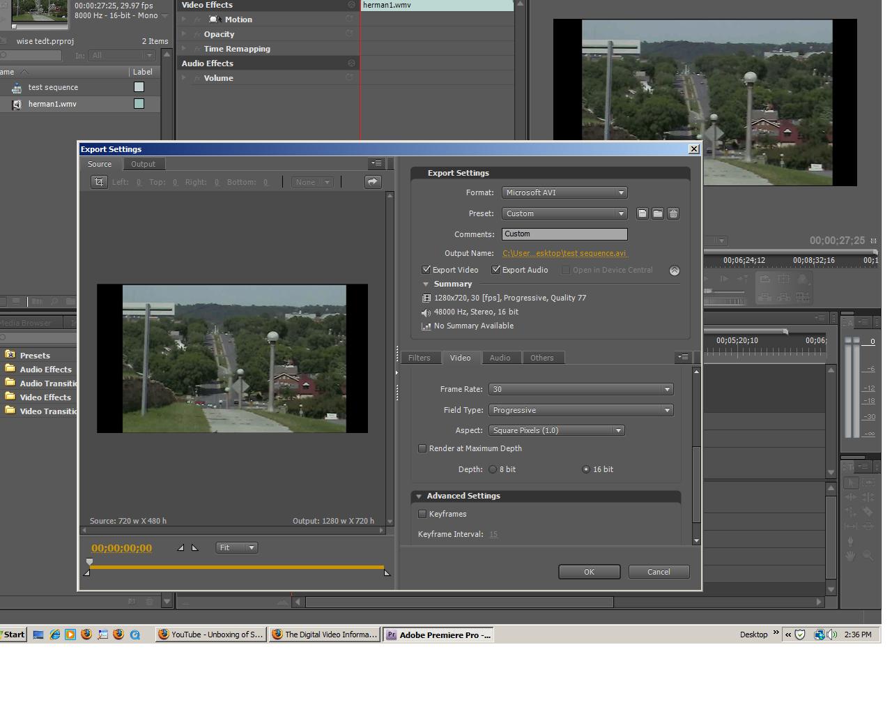

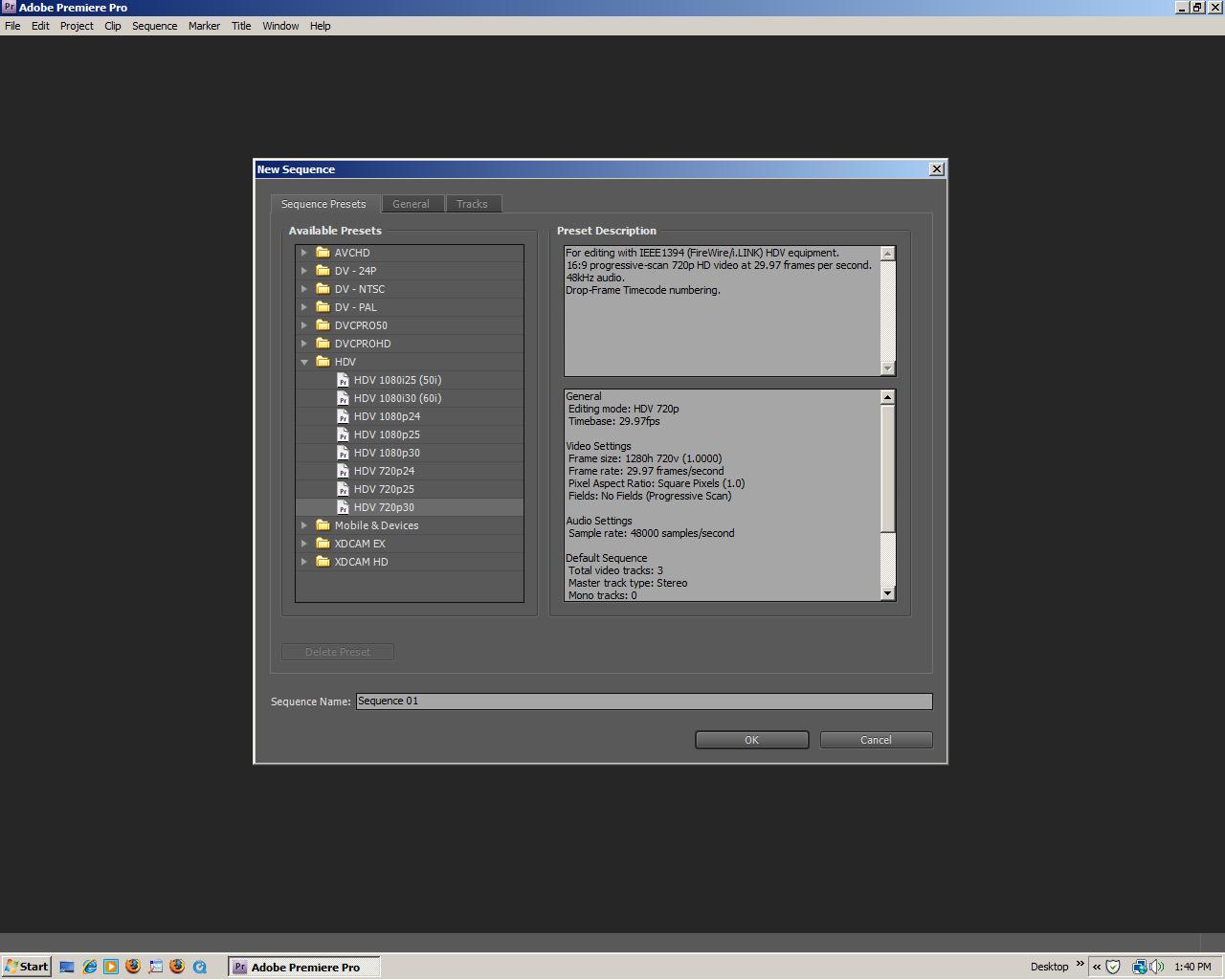

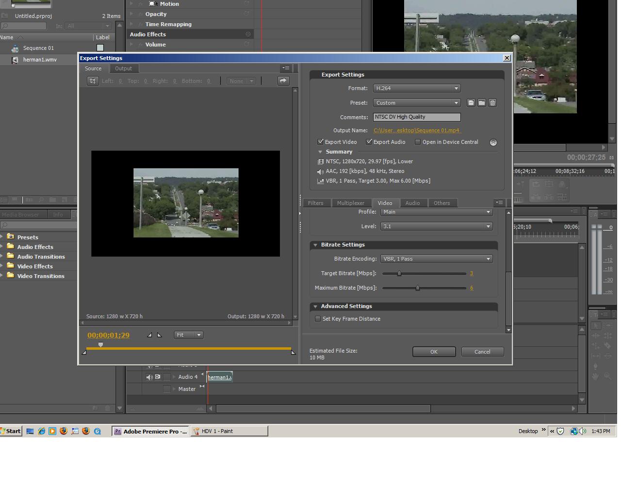

Here are 3 screen shots of exporting in Premiere CS4
YouTube setting is driving me insane-render-one.jpg   YouTube setting is driving me insane-hdv-1.jpg
Matthew Ewing is offline   Reply With Quote
Old January 24th, 2009, 01:58 PM   #8
Location: Miller Place, NY
Posts: 820
I notice the second screenshot says "NTSC DV High Quality" in the Comments section; did you start with an NTSC preset and adjust the settings for 720? Some of them are incorrect, namely the Field Order (I don't know Premiere's specific terminology, but there should be an option that says either None or Progressive) and the Pixel Aspect Ratio. The display aspect ratio of your image may be 16:9, but its pixel aspect ratio should be set to Square Pixels.
You may be able to easily get what you want by choosing a different Preset in the Export Settings dialog; is there some sort of 720 HD option? The Premiere CS4 PDF manual from Adobe's website doesn't seem to offer a list of what's available.

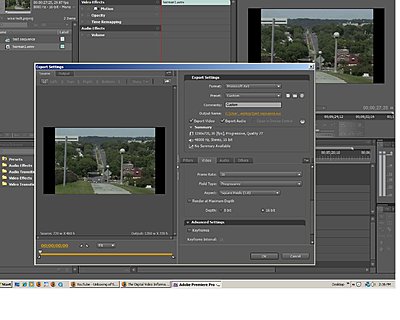

I got a test footage rendering right now with the following settings and the picture is now filling the top to bottom portion of the screen but not all the way across on the sides.
Here is my settings :
Started project as DV NTSC Widescreen
Exported as : Format Windows AVI
Preset ; Custom
Video Codec ; Microsoft video 1
Frame size ; 1280 x 720
Frame rate : 29.97
Field type ; Progressive
Aspect ; Square pixels (1.0)
Render at 16 bits
I am starting with SD footage.
Ok video just loaded and it is larger but not widescreen at all. As you can view in my screen shot here, The video is touching from top to bottom in the Premiere preview window on the left.
Old January 24th, 2009, 02:42 PM   #14
Location: Tallahassee, FL
Posts: 4,100
Matthew, you can't put 4:3 video into 16:9 space and have it fill. There are only 2 ways to do it
1. Distort the video
2. Zoom in so that the sides fill in and lose the top and bottom.
You have to choose. It's no different than getting a 16:9 TV and watching an SD DVD or TV program on it.
