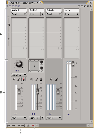

Adam is right, timeline keyframes are the quick and efficient way most people handle this. However, APP has the audio panel, which will let you adjust the tracks by a virtual mixer (see illustration) if it's more instinctive for you. You need to set the automation mode to write to make it create the keyframes for you, see "audio" in PP help for a complete discussion. IMHO it's more trouble than it's worth, but I've been cutting with keyframes since forever..../Battle Vaughan /miamiherald.com video team
PS On your other question, our practice here is to adjust normal audio levels to average out between -12 and -6 dBfs, never peaking over -3. If audio gets to 0 you will get distortion. The audio level meter and the meters in the audio panel will guide you. It can flicker up into the yellow, never get to red...../BV
