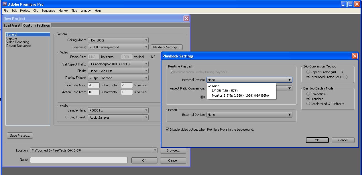

I am guessing you want to see the New Project/Custom Settings/Playback Settings choices I have when I am starting a new project with cam attached (note no HDV only DV or Monitor):
Matthew Cairns is offline   Reply With Quote

Ah, got it.
No, I have only DV showing. Not even the second monitor (which is managed by the display card, I think).
