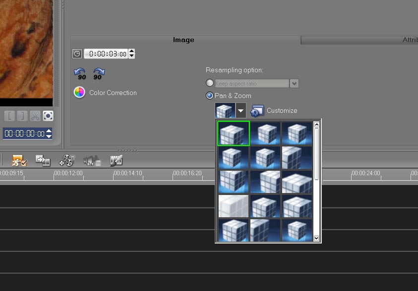

corel video studio pro is realy a walk in the park for zooming and panning + some other things. 2 mouse clicks.
Video-editing software ? Corel VideoStudio Pro X2
many predefined + easy to make custom path for pan and zoom
